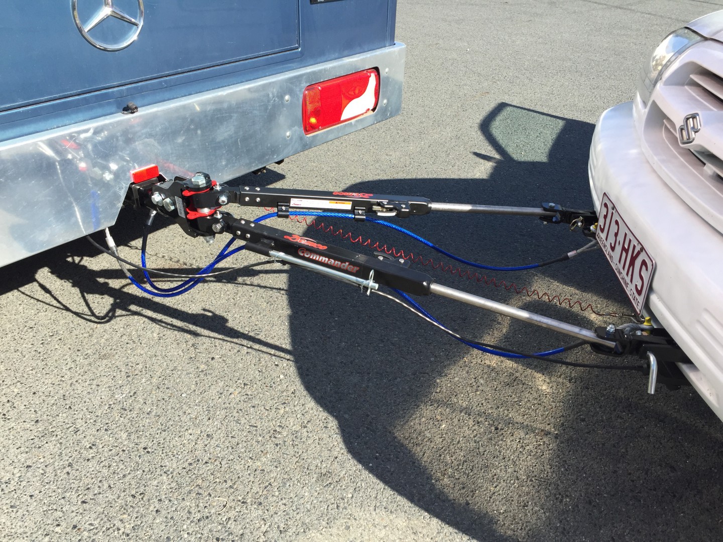

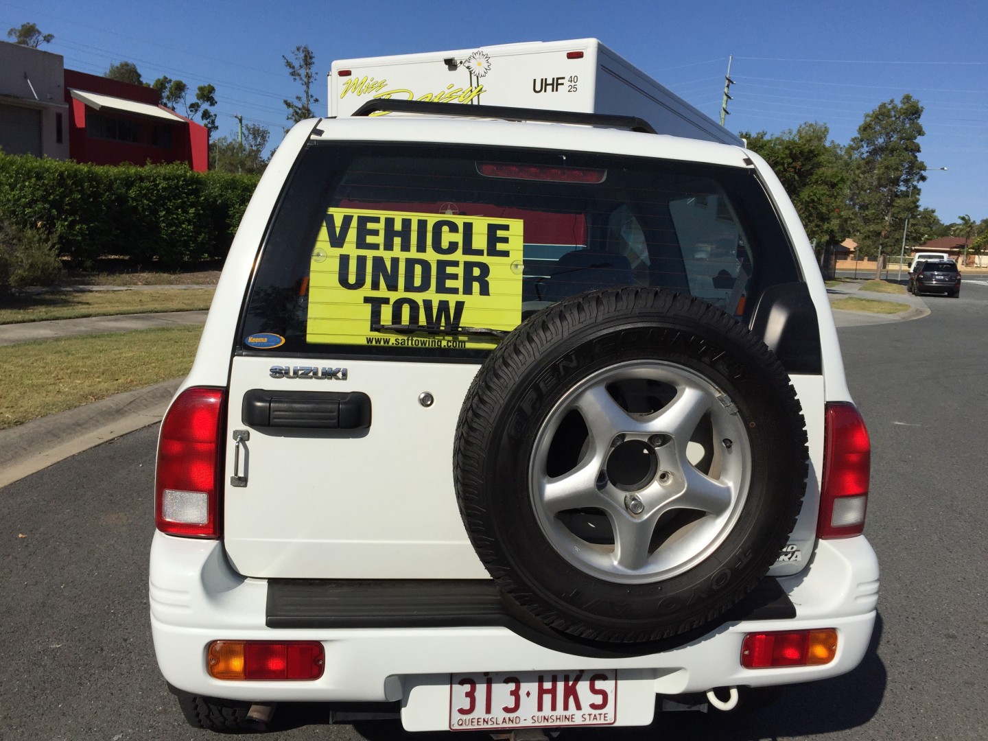

shekon said
06:39 PM Oct 29, 2014

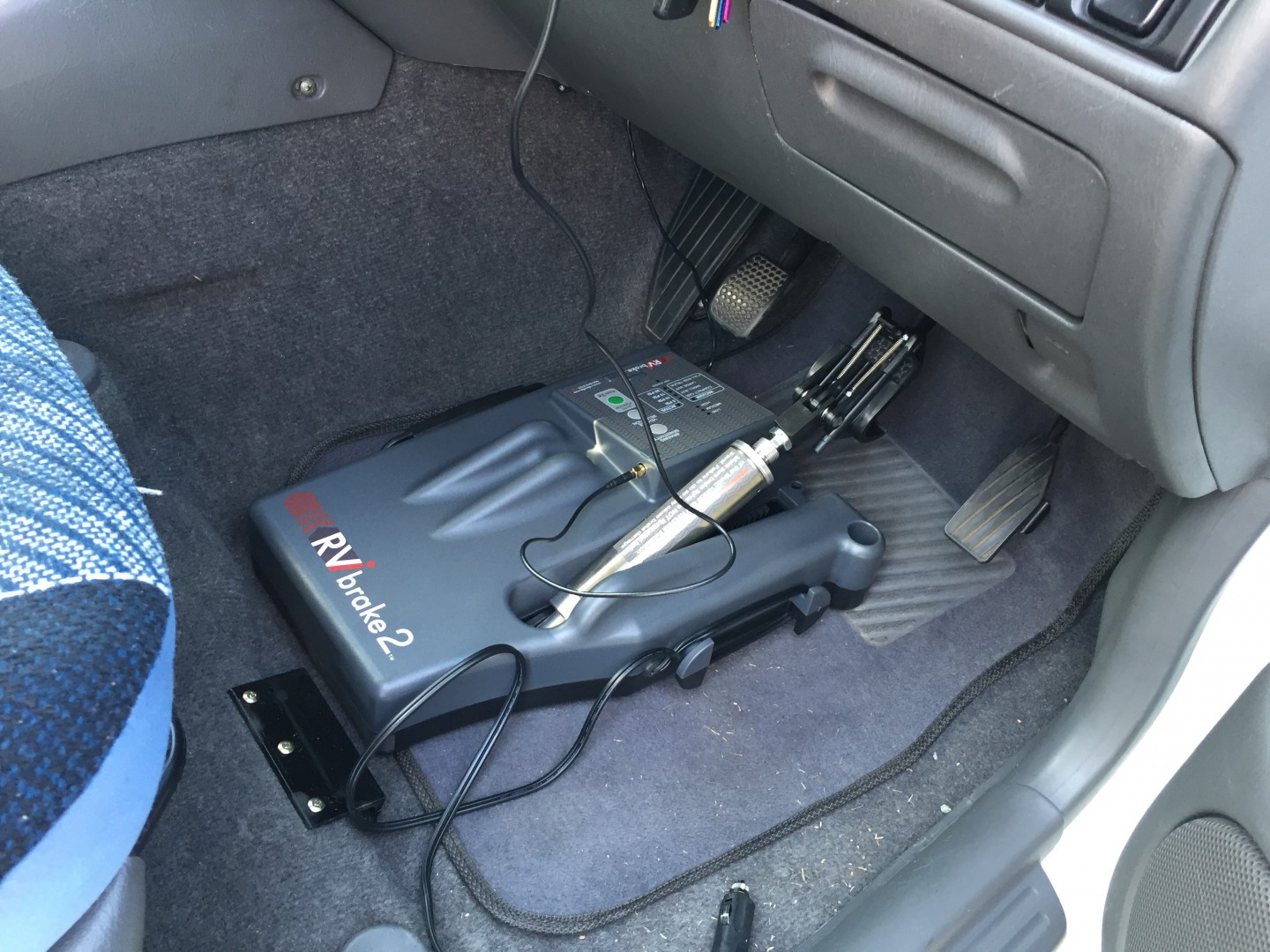

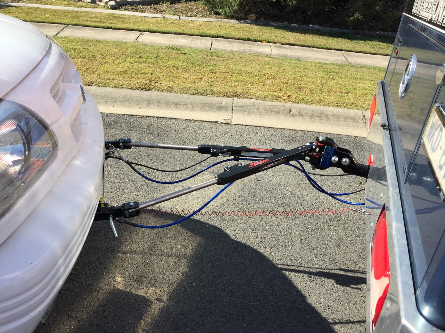

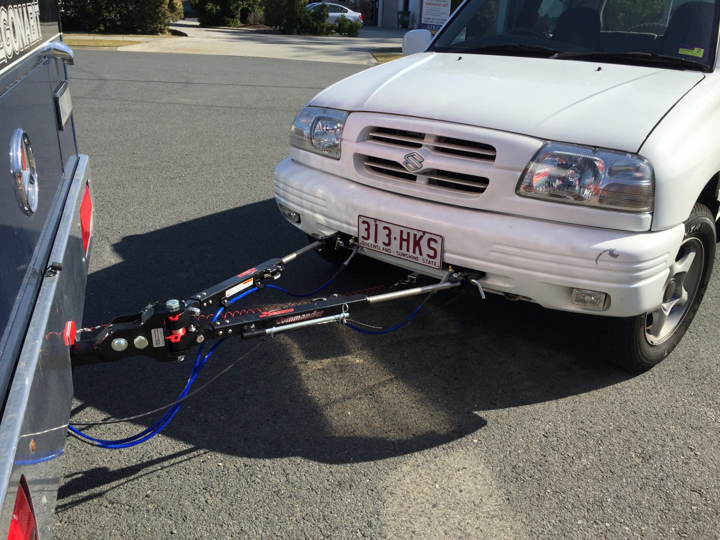

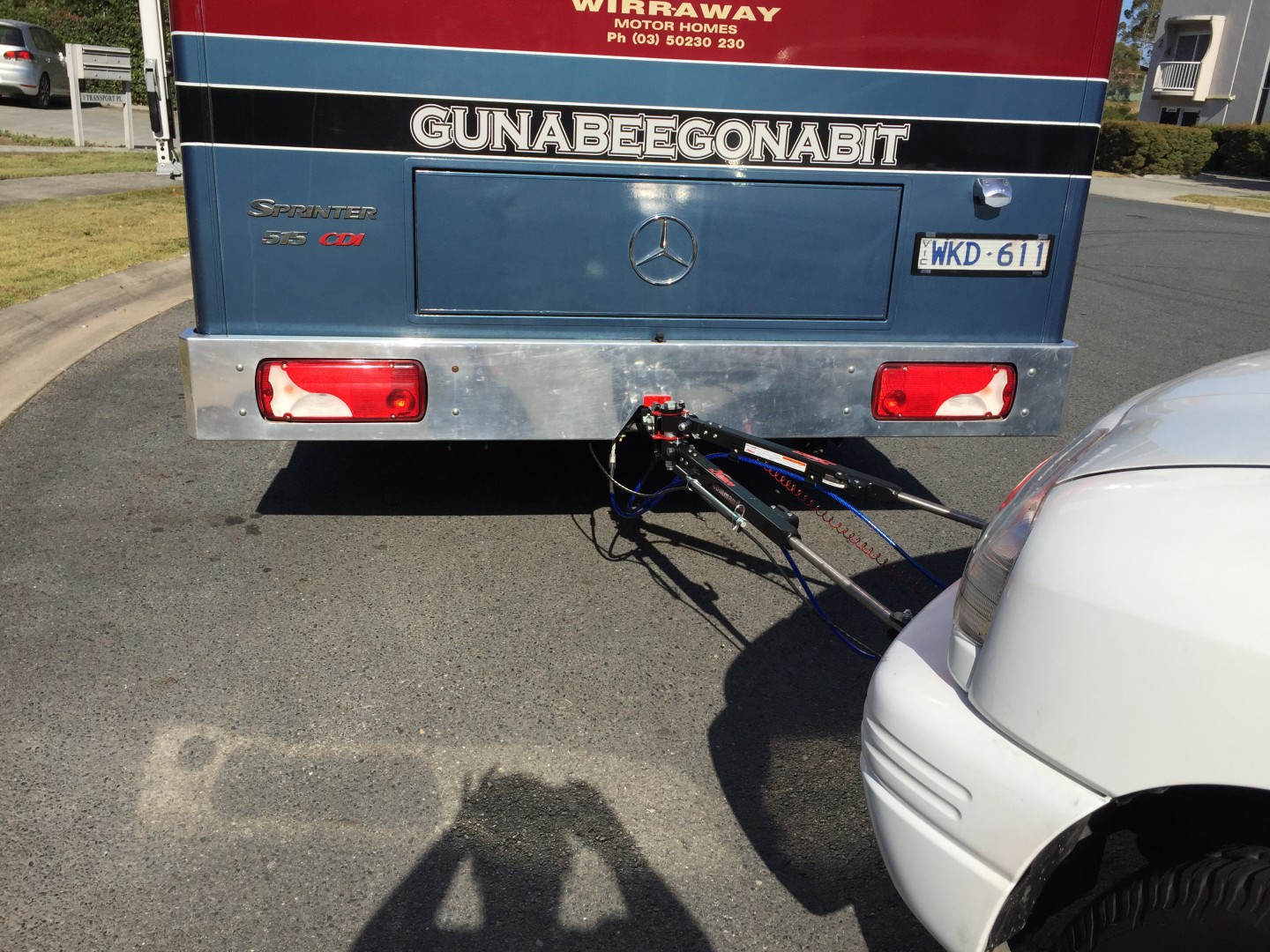

Had surgery done and completed today on Miss Daisy and Seedling. All went well and the time taken was around 3.5 hours. I already had the electricals and tow bar fitted. Easy to operate and tow. I have never towed before, so around the block we went and so easy because the just follows unlike a trailer. Turned left and right and did a u turn all good. There a little loss of power on take off and hills, all to be expected.have to say just quietly, I am a little bit chuffed with myself.
Oh you do need to make sure the tow bar is the correct height from the road if having it fitted. Would suggest ringing them and having a chat. Lovely guys to deal with. What I really liked also was they spoke to me as the owner not my son, he was included but questions and explanations to me. Find a lot of mechanical places will speak to the man no matter what. No biggie just the nature of the beasts. Saftowing.com, this is all they do. Flat towing.
WOW well done Sharon, looks great, you will know have more freedom to go where you want., great about the guys actually seeing you and speaking to you, so it should br your the one that will be doing the driving. Happy travels . - Fran

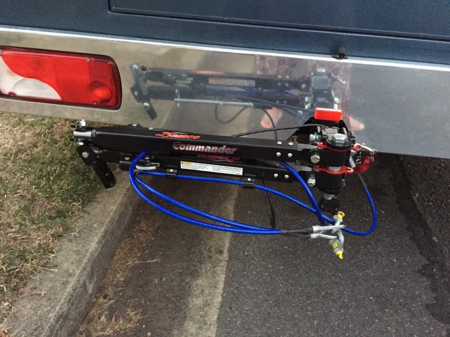

This is what it looks like unhitched
