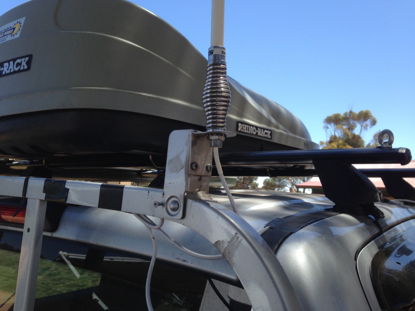

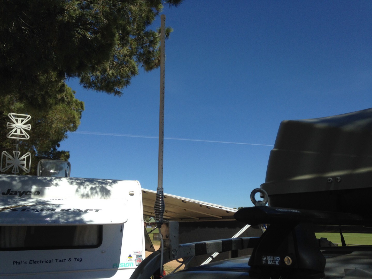

Here is my CB ant rig.
I will try that earth wire, sounds like a great idea.

Phil, just one point on your antenna mount if i may. The area I have circled on your pic shows loops of cable. It looks like you have looped the excess cable inside the the headboard frame to keep it out of the way. This is not the best for the performance of the rig mate, and can cause signal attenuation. Better to trim excess cable so that it doesn't have the loops, but is still long enough incase you need to reterminate the cable in the future.
As for grounding the base, it's not relevant on ground independant antennas and will make no difference. Grounding the mount is only really required for antennas that require a ground plane.

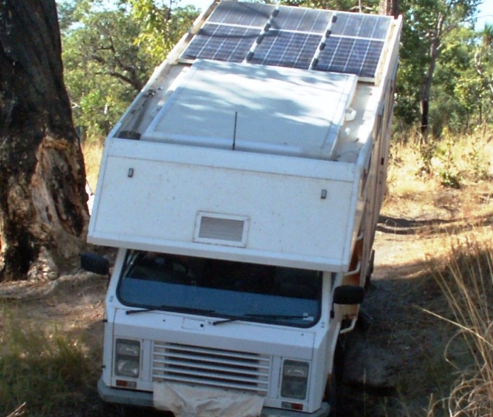

All I really want is to be made aware that the truck behind wants to overtake me , as I will be towing a Suzuki behind motorhome.
I don't want to drill holes in rooftop ,so my two choices were Bull bar or Side mirrors ,now it might be too much weight on mirrors so I will mount on Bull bar.

Phil C said
01:14 PM Oct 27, 2014
Ex RadTechA
Yeah I agree Troopy, its a very temporary measure till I get some decent BNCs.
So far, touch wood, not too much degradation still getting and sending a 5 by 5.
Thanks for the input

Instinctively I'd expect the motorhome body to block signal from the rear with a vertical bullbar mount. I've seen a few motorhomes set up this way but never asked their owners about radio performance. Mounting as close to the edge of the bullbar as possible might work. As to which side, on the left it's less likely to distract you or interfere with vision but is more vulnerable to damage from vegetation and passing vandals when parked in towns.
