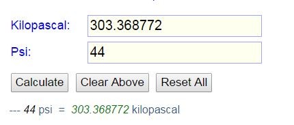

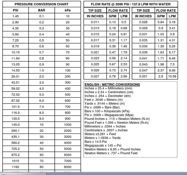

This has been a question on my mind for a while now. We have a Jayco Starcraft 20 footer with dual axels the compliance plate is in kpa and I can't find a conversion.
I'm running 44psi atm. Maybe a bit soft?
