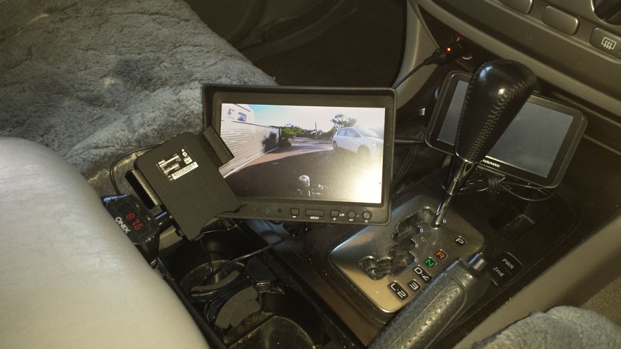

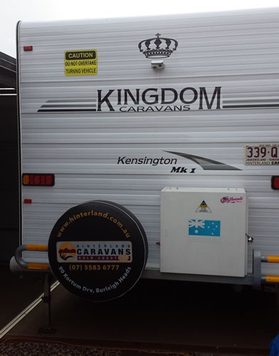

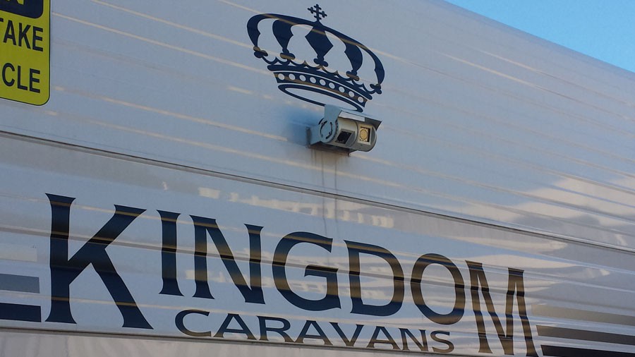

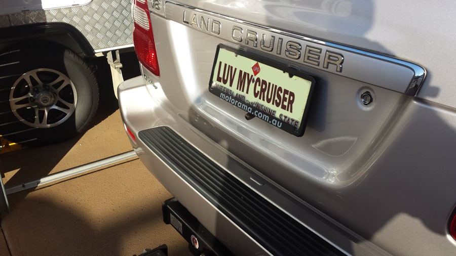

Dave I have a 3 cameras + 1 screen and a toggle switch.
One cam on the Tug under the number plate, displays day & Night vision at 170Deg. Perfect for car parks & kids around. There is no yellow guidelines etc ...
The other 2 are on the back of the van up high. 1 displays all 3 lanes when you travel in the centre lane of 3 or in the right lane turning right.
Yes your right Dave........it can see more than 100 metres back. It can also see (self focusing) when something is smack up behind you.
The other 1 is a downward vision at the rear of the van which enables me to back up within inches of anything. also if anyone is standing or comes close.
The display is 7 Inch screen mounted behind the auto stick on the cruiser console. I can switch between cameras when all connected at the push of a button.
However as was mentioned to me when setup ..and again the notes in the packaging that "Important notice when using the screen" without a van hitched "may be illegal when operated without reverse gear activation, in some states" ....... A bit the same as when you turn on a navman and have to accept the rules also.
So anytime I have had cops around - without the van hitched - I simply reach down and turn it off.....When the van is on - its ON But seriously - I have driven vans and trailers for years without cam's ,...but now I have one - I wouldnt be with out it.
It makes hook up or reversing so simple - and for trucks overtaking... Well I'm well out of their way and take my foot off as they go past to make things easy.
It is a Polaris system .... simple / cheap but effective. Take a look
