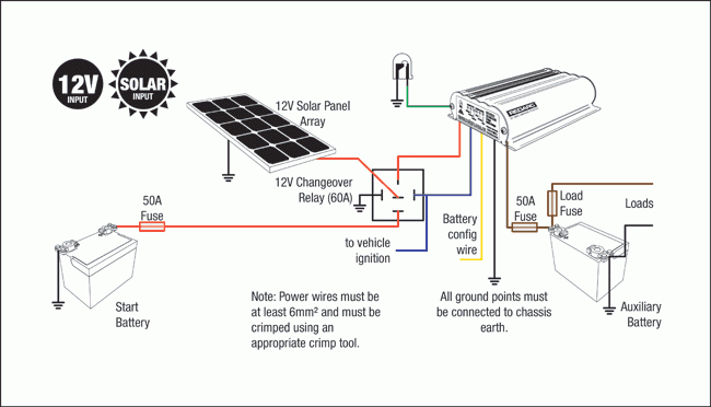

Woody I would suggest a Redarc BCDC 1240 http://www.redarc.com.au/products/product/in-vehicle-battery-charger-40a/ to charge from your motor and this DC DC charger also has a MPPT solar regulator built in , a change over relay needs to be fitted between the lead from your starter battery and the charger to connect the solar panel to . Purchase a 240v multlistage charger to charge off 240v . The Projecta 240v charger seems a good charger .
03_troopy said
02:56 PM Oct 22, 2014
What Tim said.. like this:
From the Redarc site
And shop around, prices vary considerably. just over $460 online

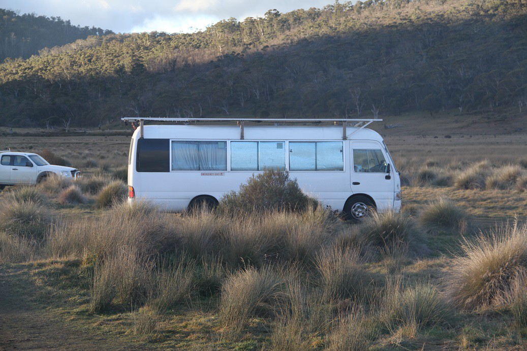

Here is a Picture of what my bus is Currently configured Like..
The Roof rack is holding up a Tropical Roof of Solar Panels[Minus 1] I have enough solar up there to Fully charge my Batteries by 10-10:30am during summer, and I use the rest of the day to do what ever I want with the Power.. I will not go into my build here.. and yes it is an extreme amount of solar, but not by all means the smallest or the largest for This type of system..
