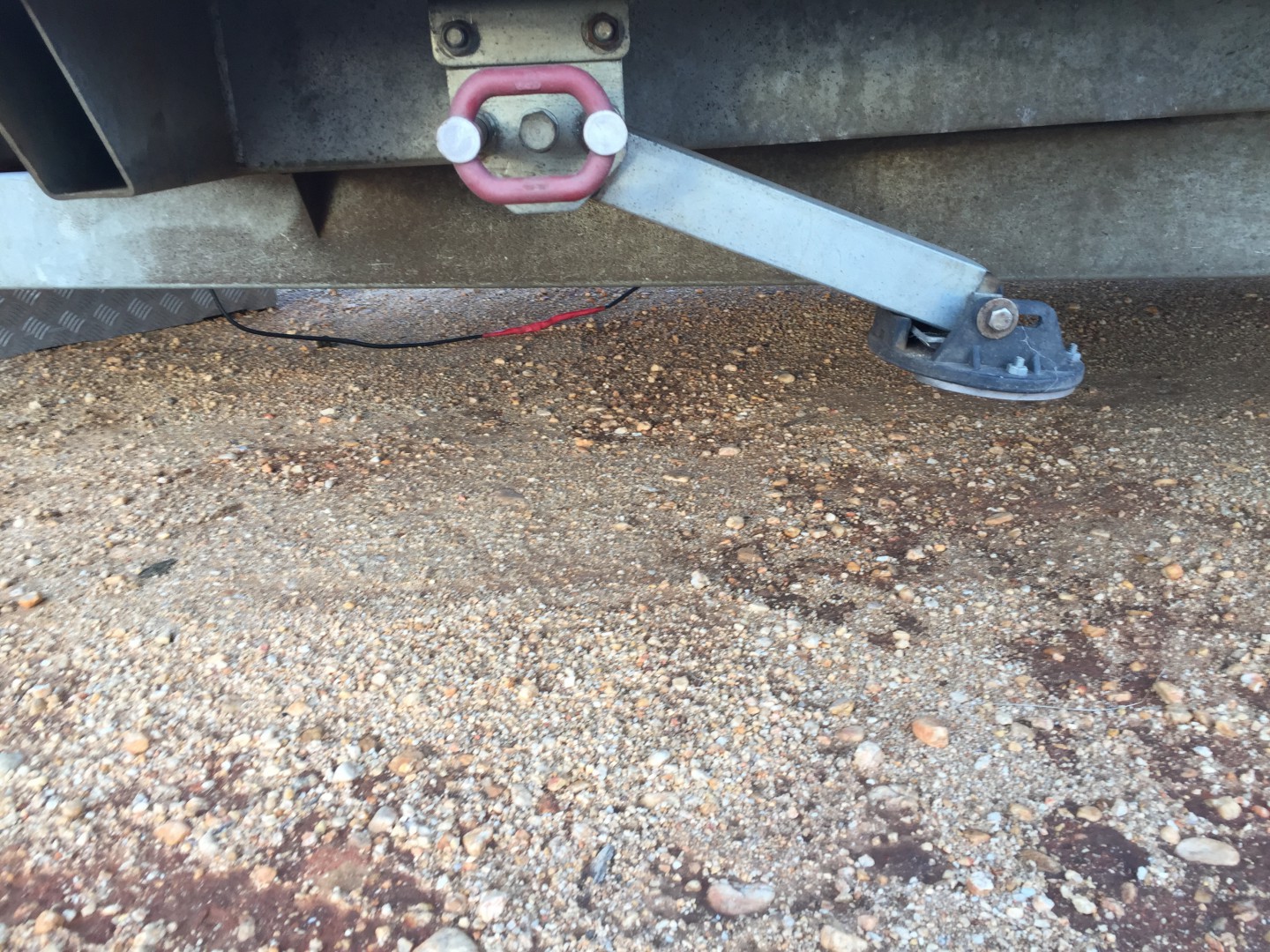

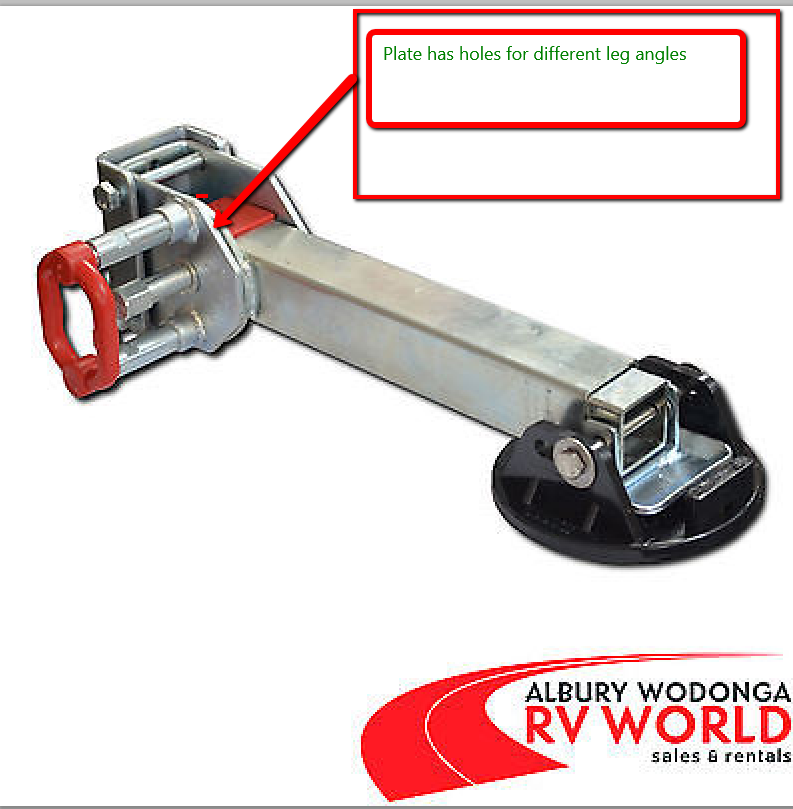

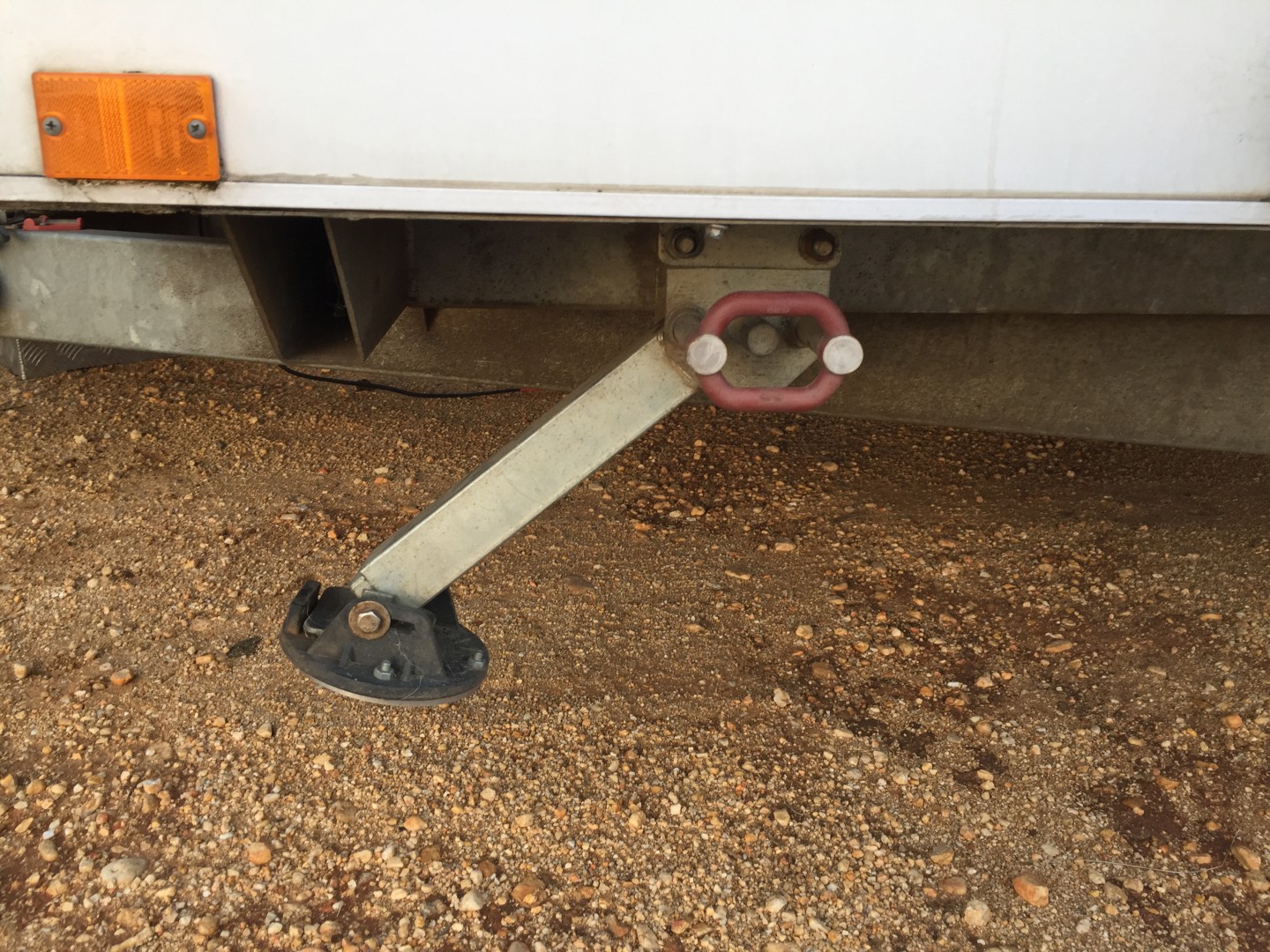

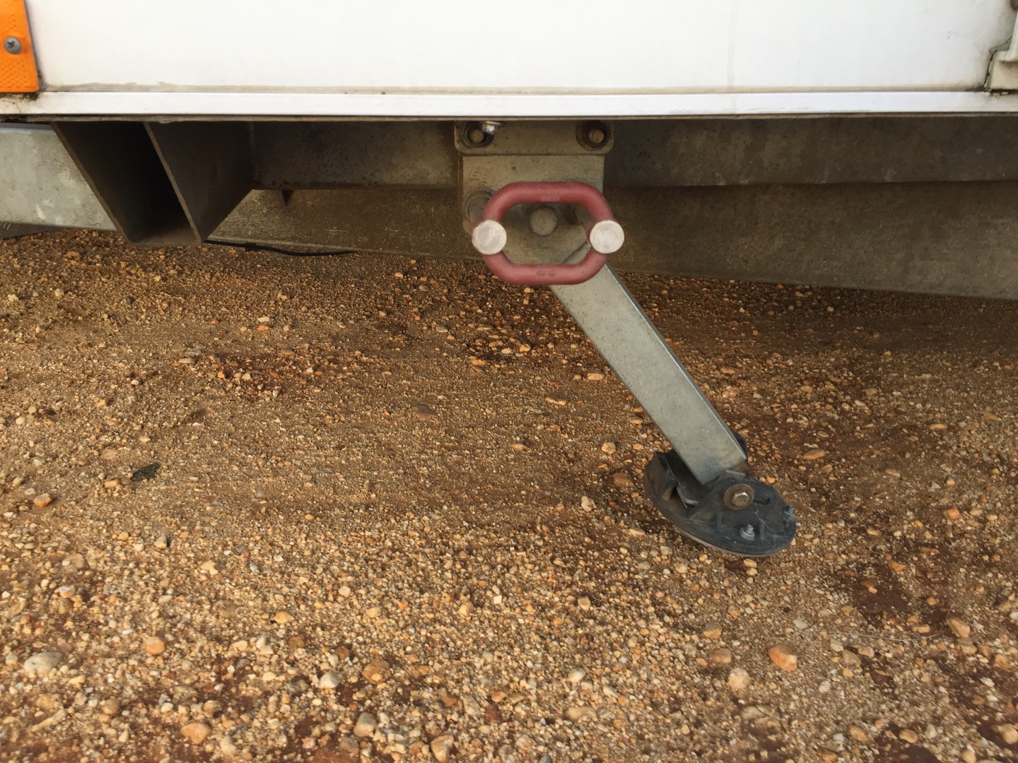

Thommo
We have a Coromal with drop down legs,pull out the red handle and adjust leg to different angle.
the plate at the back has about 6 different positions

Thommo
Some pics of ours today.
