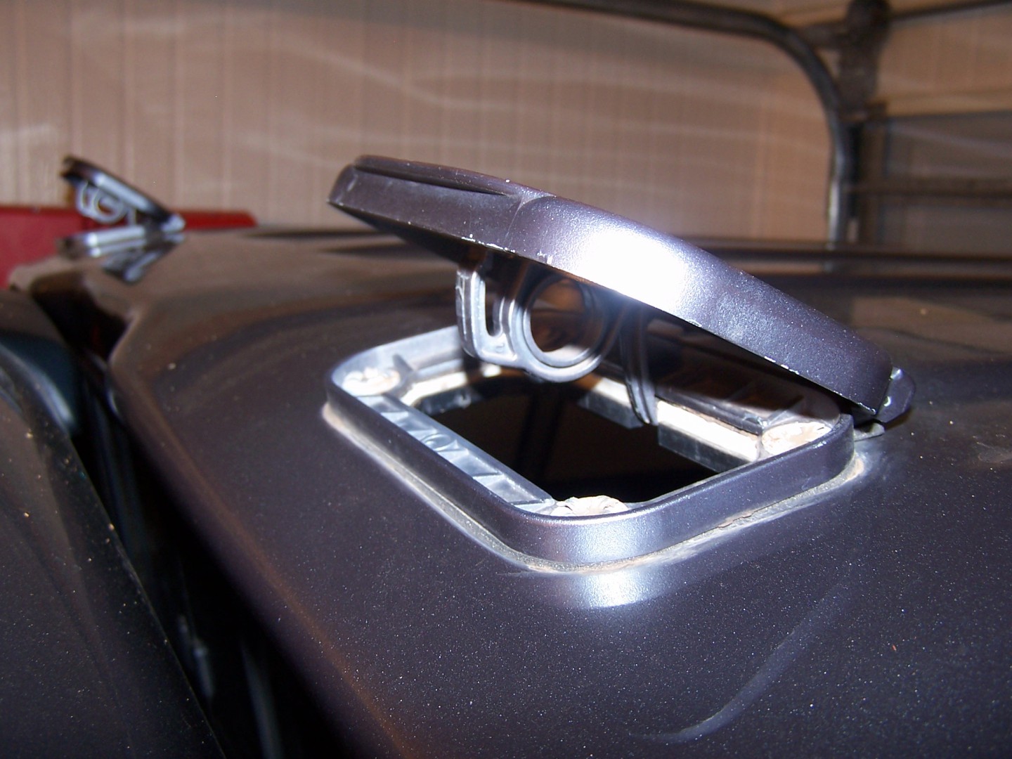

Hi all, First post on the forum! Has anyone solved the problem of dust entering through the tailgate on a Mazda BT50 (current model)? I plan to fit a air duct on the canopy to pressurize the back. Will that be enough? Cheers, Brownie2

No doubt it is a problem. Mate of mine tried what Dennis did and wasn't satisfied with the result. He's fitted a pressurising hatch at the rear of the canopy and we're waiting on his next trip to find the results but he reckons its already reduced the dust that you to get it during everyday travel. If it works I'll try the same thing because the gaps between my tailgate and the tub is huge.

I had two vents fitted , one on each side at the front of the canopy. I was told not to put them at the back, they are not 100% effective but do a good job.
They also help to keep the temperature down on a hot day for the fridge.

No bull in under my canopy Hallmark. The vents I have create a positive pressure. If the spinning type vents are fitted, they create a negative pressure and will suck in more dust.

Their is a gap between the floor and the front wall of the tub. I find the vents are good, preventing dust ingress. As I said in another comment, they help to drop the temperature which helps the fridge on a hot day.

Mate can you tell me what brand of canopy you have and post a pic of the inside of the vents mounted

The canopy is an EGR brand, if I were to buy another canopy I would look at another maker that I have seen. I can not remember the make but a big improvement on the EGR.
