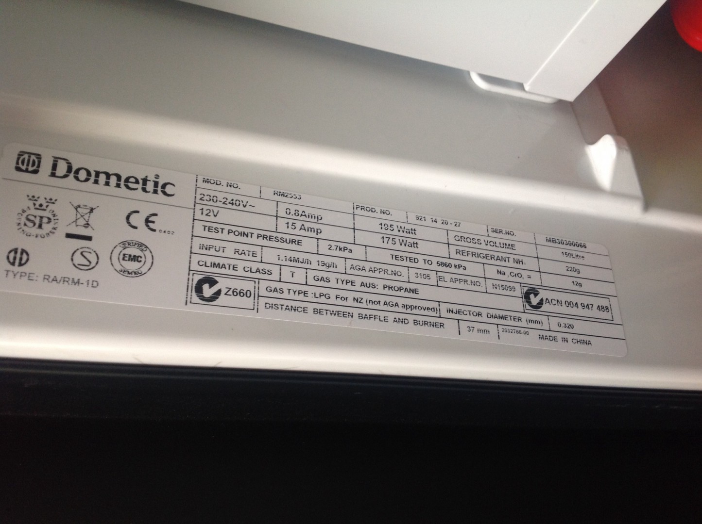

Blue said
07:27 PM Oct 13, 2014
ok, check out this picture below...
if you look on your Fridges Specification sticker you'll see the Climate Class..
now.. no matter where you live in Australia.. make sure your van is fitted with a Tand not an S
for those of you who are getting a Caravan Built RIGHT NOW... {Doug} .. ring them up and make sure your van is being fitted with a Fridge with a Climate Class of T
if it isn't or you find that an S is fitted then demand they change it!!
-- Edited by Blue on Monday 13th of October 2014 07:28:22 PM

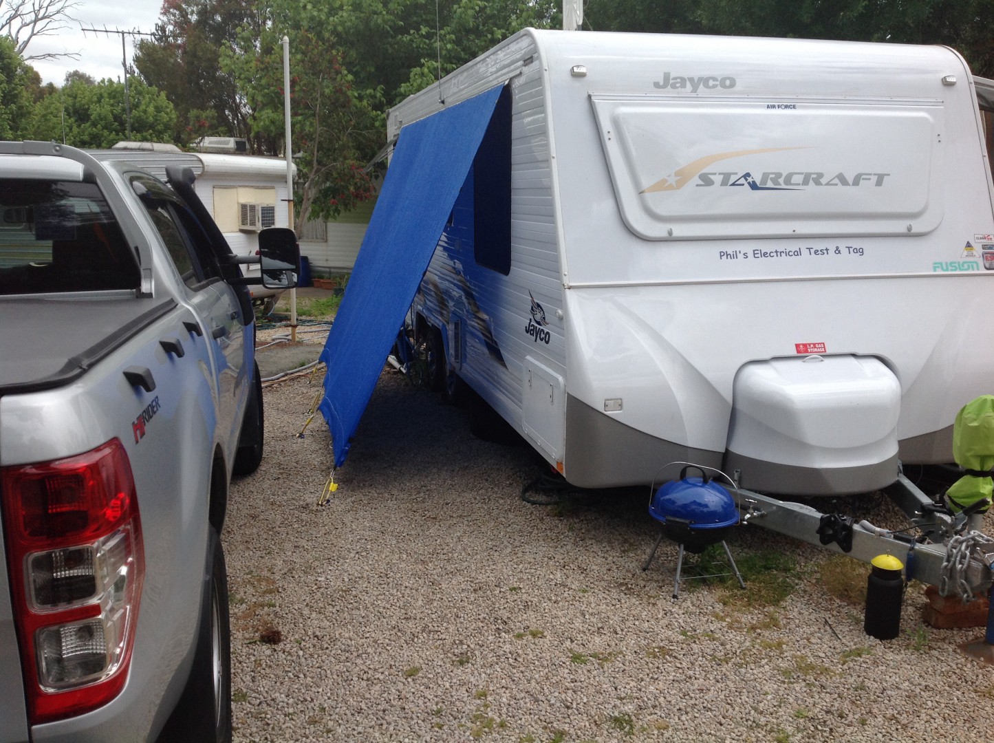

Phil C said
02:11 PM Oct 15, 2014
Hi all
I'll chime in here and say my dometic has never had issues. Not sure of the rating and don't care because it works.
We did this to beat some very hot days last summer.
Again I ask, what model fridge do you have? Remember, not all Dometic fridges are created equally. Discussion without telling us what you are using are fairly meaningless.
Phil C said
04:52 PM Oct 15, 2014
PeterD wrote:
PeterD my post was about the screen, not the fridge.
So it doesn't matter, and I couldn't be stuffed to look
also, there is never meaningless discussion on this forum, everyone including you and me deserve respect from all as what we have to say is important. Your comment shows little respect.
Now out of respect for you the photo is the fridge nameplate
-- Edited by Phil C on Wednesday 15th of October 2014 04:56:55 PM
-- Edited by Phil C on Wednesday 15th of October 2014 05:03:28 PM
Phil, you have one of the good series of fridges (RM2553,) it's the size larger than mine.You should get good operation from it with or without that shade. I had an awning track mounted on the fridge side of the van, we used a shade like yours early in the life of the van but rarely use it now.
Phil C said
05:25 PM Oct 15, 2014
Cheers PeterD I would be most upset at Jayco had that been different.
We made the choice to go a full length shade as it cools that side of the van rather well on a very hot day. Needless to say the effect on privacy.
I hope you are well.

Blue said
05:58 PM Oct 16, 2014
Phil C wrote:
PeterD wrote:
excellent Phil,
you have Climate Class T
and that's why it works so well...
-- Edited by Blue on Thursday 16th of October 2014 05:58:32 PM
now.. no matter where you live in Australia.. make sure your van is fitted with a T and not an S

Yes you are fortunate to have one of therir older models. The new Jayco vans are fitted with the curved bow fronted fridges, hence the renewed talk regarding Dometic fridges. There is an 11 page thread in CF regarding fridge performance in their Silverline vans.
excellent Phil,
