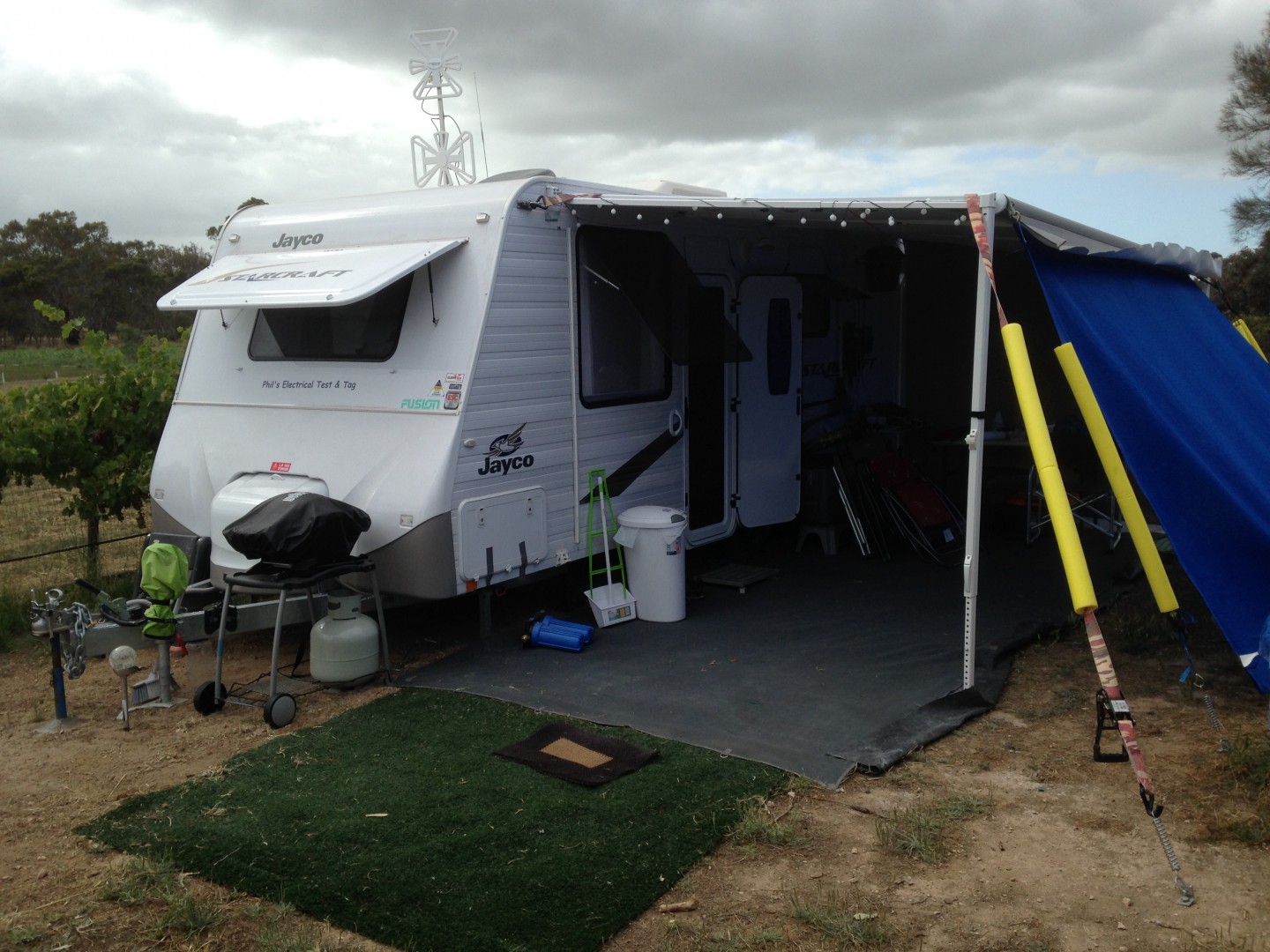

Hi out there everyone. In an Adelaide Caravan Park at the moment with the awning out, and the full annexe up. to say the least it is blowing a gale. Would be interested to know the thoughts of others as to how much wind they have left their annexes and awnings erected in with out doing any damage. Cheers Daz
Cupie said
04:01 PM Oct 6, 2014
Sorry, I can't give a precise answer re the strength of wind that I have endured. I have however survived some pretty strong blows.
My approach includes -
- Leave the awning arms attached to the van
- Double guy ropes on both ends of the awning rafter. Sprung & double pegged (on opposing angles), using my best pegs. One guy rope placed in line with the rafter & the other at 90 degrees .... at each end. The guy ropes are normally attached to the awning arm but if I am worried about the wind strength, I put one around the rafter itself.
- Peg down all walls of the annex including the windbreak. I use rubber bands made from old tire inner tubes, between the eyelets & pegs. Twist them to shorten if necessary.
- If it's really blowy I put a tie down strap lengthways across the middle of the awning
- Park the 4WD so that it acts as a bit of a wind break if possible.
- If I expect strong wind I park well away from high trees (falling branches et.al.) but close to hedges if possible. Also use other vans or buildings as windbreaks if I can.
Good luck.

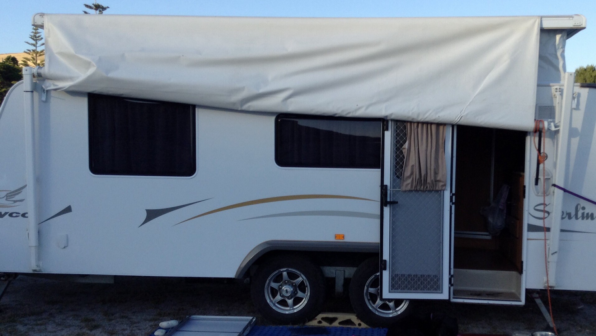

Just this year in mid March while we were enjoying Wollongong we went out for the day to return to find our awning along where it connects to the van ripped.
Only minutes before we returned to the park it had been hit by 90 kilometer winds and a very heavy rainstorm and was all over in minutes, the other Tennant near by were pretty upset that they did not have time to save ours after putting theirs away, no one could believe that this storm hit so quick.
I did have it pegged down well just the awning out and I think what gave up was the material as along the edge which took the hiding was fail from age and the sun as that the edge which is exposed the most as this van has never been stored in a shed from new and is now 6 years old.
The good point is when we replaced it we had it made that little bit longer, so all good.
To answer your question if the gods out there tell you it's going to blow some what fold her in. Ralph.

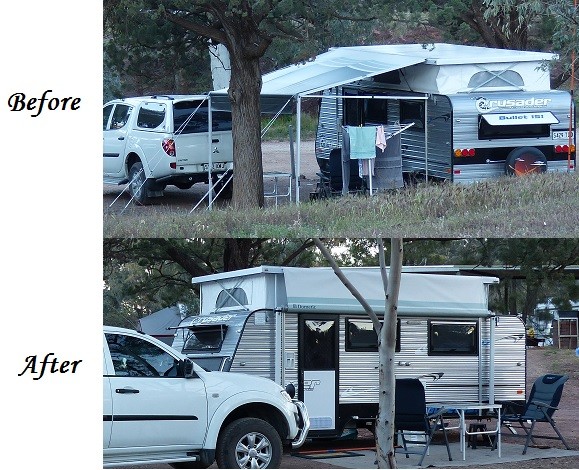

Well the wind has eased off and we have remained intact. I did have the full annex up and the walls were well pegged down with short star pickets hammered in on an angle that would not pull out of the sand. Winds by the BOM reached gusts of 110 KM . The awning was also roped down from the roller to very secure star pickets. The draught skirt was attached to the van. With all this security the wind gusts give the walls and awning a fair hammering . My main concern was how much pressure the awning could take where it is attached to the van with the sail rope and track before the stitching gave way or the rope pulled out as the walls and roof bellowed in and out and up and down with the severe gusts
Thanks for the interest shown Daz
Good luck.
Edit .. If expecting winds in a situation where I haven't attached the Annex walls (& taken the steps outlined above), I roll up the awning & fold the chairs & table & store under the van when not in use ... particularly overnight.
-- Edited by Cupie on Monday 6th of October 2014 05:05:16 PM
