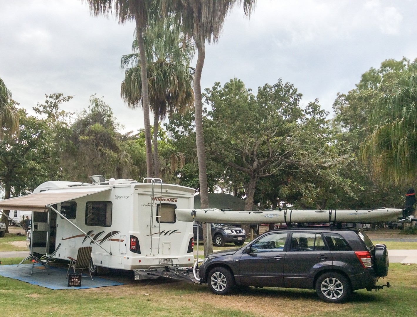

We have a Winny Esperance with the same Iveco power unit. We flat tow a 5 door manual Suzuki which also serves as my everyday drive. I chose a Ready Brute hitch which is rated to 3000kg and can safely pull a loaded car with a Hobie sailing kayak on the roof. The hitch stays connected to Winny when not in use and is light enough not to give me a hernia when carrying it. It has telescopic arms so that it can be connected even on rough terrain. The locally made steel unit is only rated to 1900 kg so that you can only legally use a small car with it. I also use a Stone Stomper to protect the Suzi.
