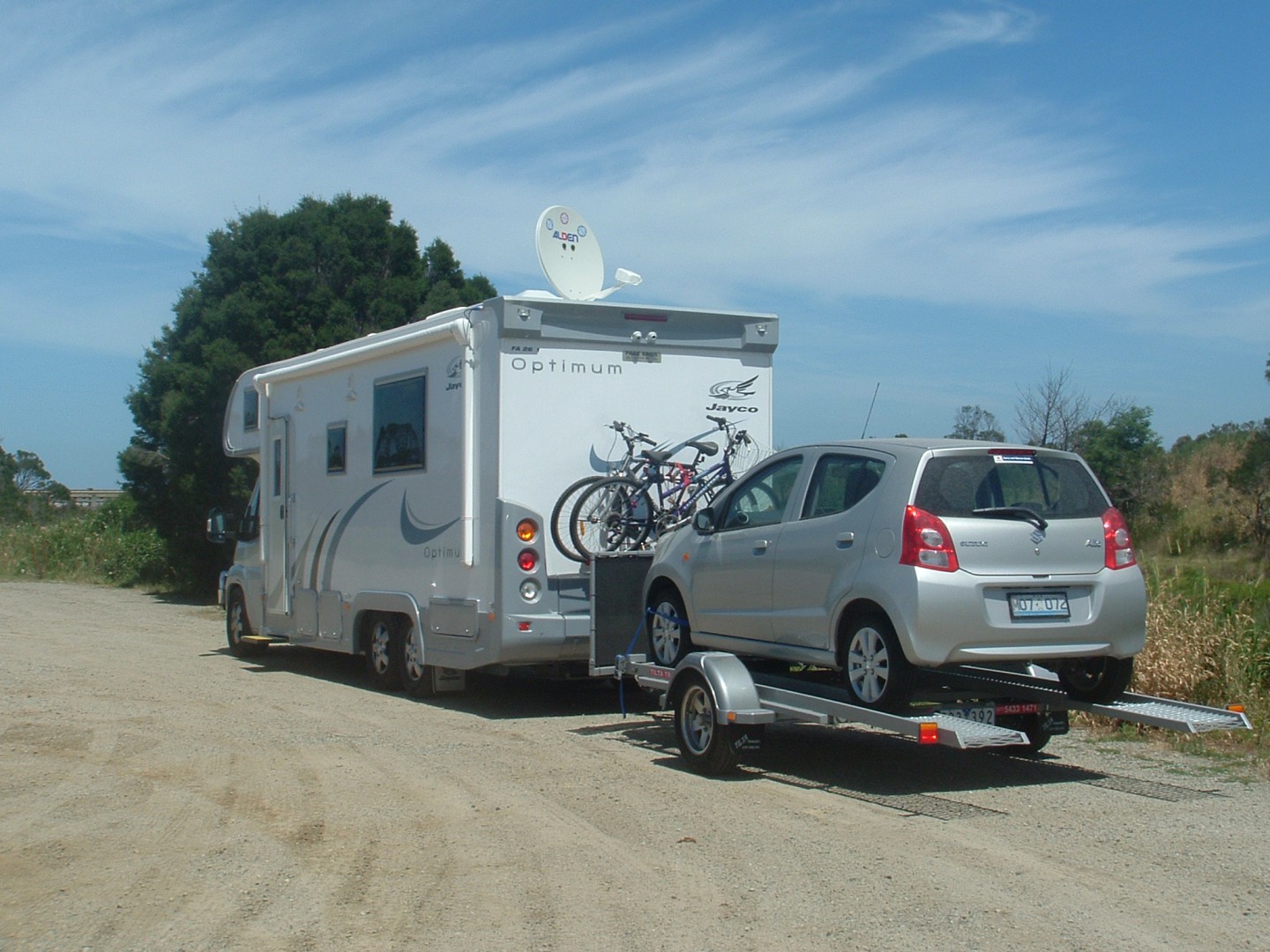

2foot6 said
10:31 PM Sep 19, 2014
We tow our Suzy on the trailer Suzy 895kg and trailer 300kg = 1195 kg which meets the towing capacity ...just another alternative...cheers Peter .
In NSW they take the gross weight of the towed vehicle which includes passengers and luggage. My friend had to sell her optimum and buy one with a higher rated tow weight. But if you put it on a trailer and its total weight is below the limit its ok. Now work that out.
NoelLee said
01:13 PM Sep 20, 2014
From what you guys are saying it looks like the Suzuki Jimni is not an option at 1000kg unless I can get an alloy trailer under 200kg.
jade46 said
09:20 PM Dec 29, 2014
No a Jimny definitely not an option if you have a 6 wheel Jayco similar to the above picture.You need to find a car with a GVM under 1200kg and if they want to be difficult that also includes the weight of the abar which is deemed to be part of the vehicle.
