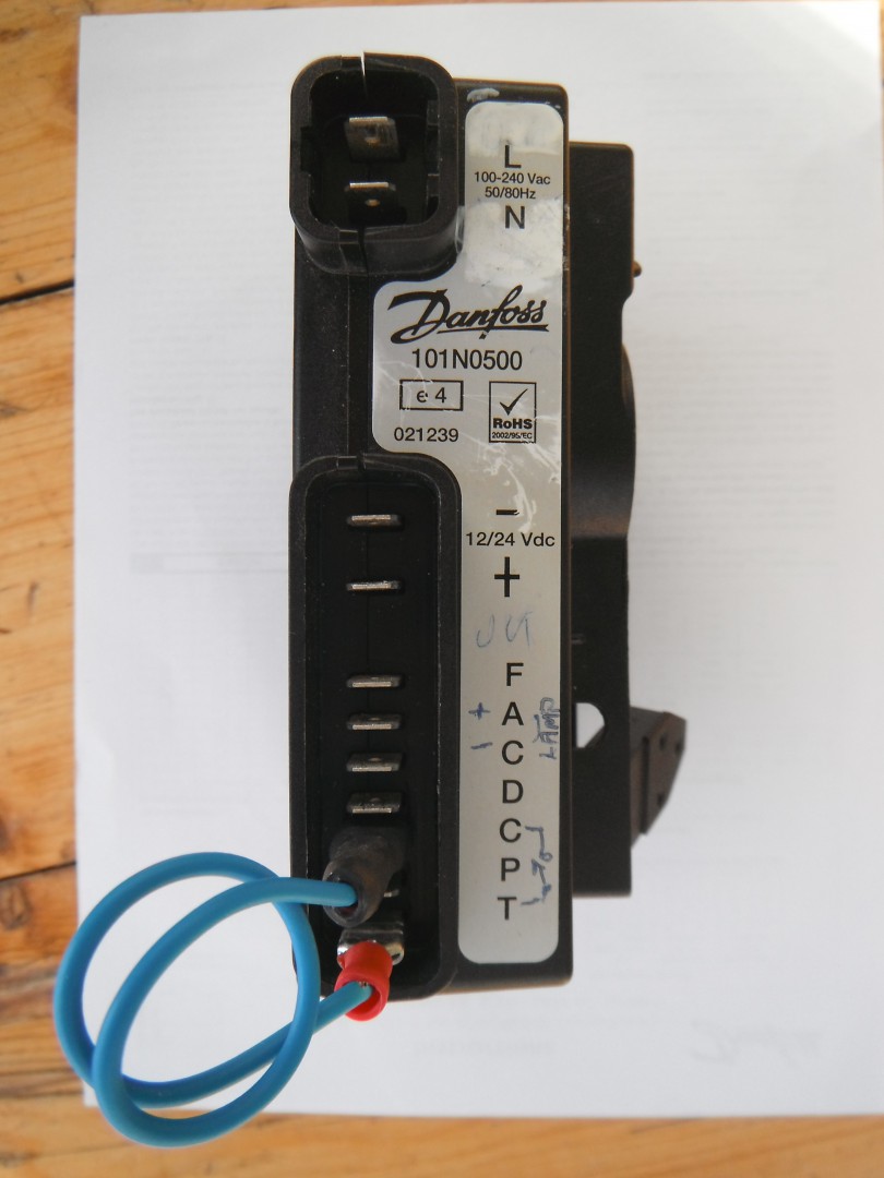

I belive the CR-140 fridges use this compressor controller. It has the 240V powersuply built in. If its doing the same on 12Vdc & 240V then its not likely to be low voltage. Is this fridge still under warranty?

If its 4yrs old, does it have this control module on the compressor? Need to establish what controlers are used & pictures are easier than just words when trying to diagnose problems.

The controller is mounted on the side of the compressor. Most fridges have to be pulled out to see anything.
