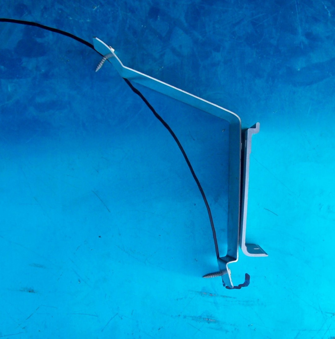

oldbobsbus said
07:37 AM Sep 16, 2014
This is a mock up of the way I attach awnings to curved roofs of campervans..
Black line is the roof line..
Bent aluminum bracket (2 x by about 150mm wide with 3 screws ) to make the awning sit vertical..
Screwed and glued to the roof with Sikaflex.. (to seal the screw holes and also make it secure..
2nd bracket represents the awning that is then screwed to the vertical part of the roof bracket..
This does away with the need for roof racks that cause a lot of drag..
-- Edited by oldbobsbus on Tuesday 16th of September 2014 07:38:08 AM
Thanks Bob, that certainly looks like the way to go.
Much appreciated,
