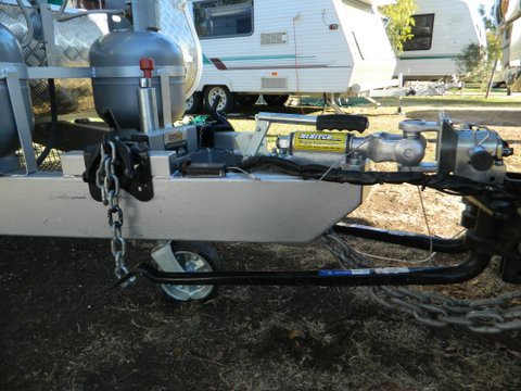

Hi Ascot . Yep we have one ,magnificent in a word .Our is a supreme Classic 2400kg 240 on the ball.We also have a WDH [with sliders and it all works perfect after 3 wks and 5000 kays last month] thats it mate pure and simple.!! I would only take heed of any comments on this topic from those that have one otherwise it is only ones opinion of an item that they have never used.I also recently had ESC fitted but as I have not been on a journey of a worthy distance as yet I too am not a reliable user of this item as yet . Cheers John P.S. ring The Co for advice as they bend over B/wards to assist.
I am a mechanical engineer, and in my opinion I would not use one of these hitches unless I saw the full engineering calculations around the universal joint and flanges.
Universal joints are used to transmit torque, and a small amount of accompanying rotational shear stress.
As a caravan coupling, these components are transmitting axial loads including bending moments and axial shear stress.
I would take a lot of convincing before I would ever use one.

Universal joints are designed to run at a minimum degree angle and a maximum degree angle and if they fall outside those parameters they will prematurely fail. They are not designed to run level as in the hitch travelling up the tar.

There are max deg angles when rotating, in this situation there is no rotation.
oldboar said
04:10 PM Sep 16, 2014
I love seeing the "X" spurts knock anything different particularly items that have undergone stringent design & testing procedures before being offered for sale. We have the 3.5 tonne older McHitch on our 2.75 tonne Coromal which has now done more than 40,000 km around Australia with no problems. We initially chose it for two reasons
1. Makes the van far less attractive to thieves due to the tapered pin rather than the far more common ball, &
2. A van rollover is far more likely to merely lift the rear of the tug, rather than rolling it as well.
Another point we've since noted is that with the movement not being at the ball less stress is placed on the drawbar with extreme angles & that ball wear is non-existent.
During our trip we've seen two snapped balls & a bent drawbar. All were the 50mm ball & coupling system. I wonder how many rollovers were.
Darrell & Sandra.

Darrell, you have had your Mchitch for a while, it has done a significant number of KM, thus you will be able to answer the concern I posted earlier.
Does the forward unsupported part of your hitch still sit up, or has the uni joint slackened off and the free part sags ?
I am particularly interested in this, as it would be critical with the new automatic version with the horizontal pin.
Basically this is the only thing holding me back from getting one, and I have just been waiting for the opportunity to talk to people with McHitchs to confirm that it is not a problem.

Plendo, still sits up firmly. Thankfully, as I use that facility to hitch up solo ie tilt the front section so that when the tapered pin hits the rear of it's housing the front section is pushed down. Once I see that occur in my rear vision camera, I know I can complete connection without further movement of the tug.

I dont have one as yet but looking at them, from what I see there are two of the uni cups that appear to be screwed in, hence the two holes in the end of each cup to accomodate a special tool, this being so maybe they can be adjusted if they should become loose due to extensive work.
As for this being knocked already , have a look at the hy-land hitch. Two studs fitted through a yoke & screwed into a cast tow ball cup , the hole van is attached to the tug via these two studs.
As a comparason, H/D towbars went away from the two stud bolt on tounge to the 50mm receiver many yrs back.

Oldboar, I am glad that you are happy with your coupling.
I don't wish failure on anyone, but when I see a mechanical component being used outside it's primary design purpose, with vastly differing load and stress applications, then I have to question it.
If as you say, the company have done their due diligence with engineering and testing, then it is quite possible that they are right and I am wrong. The original opinion (and it was only an opinion) that I expressed did state that I would want to review their data prior to using their coupling.
The past 22 years of my working life have been taken up in designing, building, and testing new lightweight components for marine hydraulics. Whilst these components had to be lightweight, they still had to pass all the Marine Survey testing and accreditation, and had to be reliable in service.
The universal joint in this coupling just plain looks like it is wrongly applied. It is the primary connection between tug and van, and in the event of a failure, only your safety chains and your skill as a driver to rely on averting a potential disaster.
Perhaps I need to think outside the box more, but at this stage it is a no go for me.

Peter, as you say, it is the primary connection between tug & van. However, I don't recall ever seeing or for that matter, hearing of, a universal coupling being virtually torn in half which would have to occur before the van & tug could part company. I have however, seen & heard of a number of 50mm tow ball shafts snapping. Is it not the primary connection in a ball & coupling system?

Uni joints do fail,, I've replaced a few years ago that failed,,, cars and trucks,,,, but on tailshafts and that is axial load at high revs/load

Darrell, I agree that conventional couplings do break, be it the ball shaft, or the coupling, or how the coupling has been mounted.
Also don't dispute that there has to be a better system. One that immediately comes to mind is the Military type couplings, but they are noisy in use and have some fore and aft slop, so caravan owners probably would not like them.
I have seen the results of U-joint failures - automotive, agricultural, and industrial.
One of the most common causes of U-joint failure is due to not making sufficient allowance for shaft increase in length due to thermal expansion. The thermal expansion puts an axial load on the joint - exactly the type of load that this coupling will experience. (That is axial load caused by towing, not caused by thermal expansion.)
I just hope the manufacturers have done their homework.

just seeking any updates on personal use of the hitch.
Hey mate weve just joined the site looking at the mchitch and WDH whats your wdh and your tow tug weve got THE 2014 bt 50 SUPREME 2015 EXC
CHEERS
