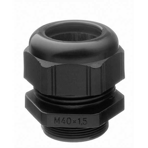

My Troopy is an ex-ambulance. It still had all the gear inside such as fibreglass cupboards, seat in back roof rack on top etc, and all the associated wiring. I removed the wiring myself and it was basically a pruning excercise in clipping off where it had been attached to the OEM wiring harnesses, and carefully and securely taping over where the joints had been made. The extra wiring is usually heavier than original OEM wiring and is generally soldered into the OEM harnesses. One point to note is where it has been routed to the outside of the vehicle for lights and siren etc, through nylon gland nuts, you need to remove the gland nuts and get the holes repaired by a good body repair place. In mine there was no sealing of the bare metal where the glands had been fitted and rust had started to form around them.

Nice to hear from another Sprinter fan, Troopy. Understood it all right up to the gland nuts I think they are the connection inside the engine that Ive seen? Great thick tube. Craig (Aurora Conversions) was great he took me through the wiring and Im sure he will be able to do it. I just wanted to speed things up a little. But I think Ill leave it alone as I dont have the mechanical expertise to do it. Instead Ill just amuse myself with removing some of the stuff I can do. Cheers di

My ex-ambulance isn't a Sprinter sorry didi, it's a Toyota Landcruiser Troop Carrier. The Nylon Gland Nut looks like this:
and is used to pass cables through panels. For example, through the roof to the roof rack electrics.
