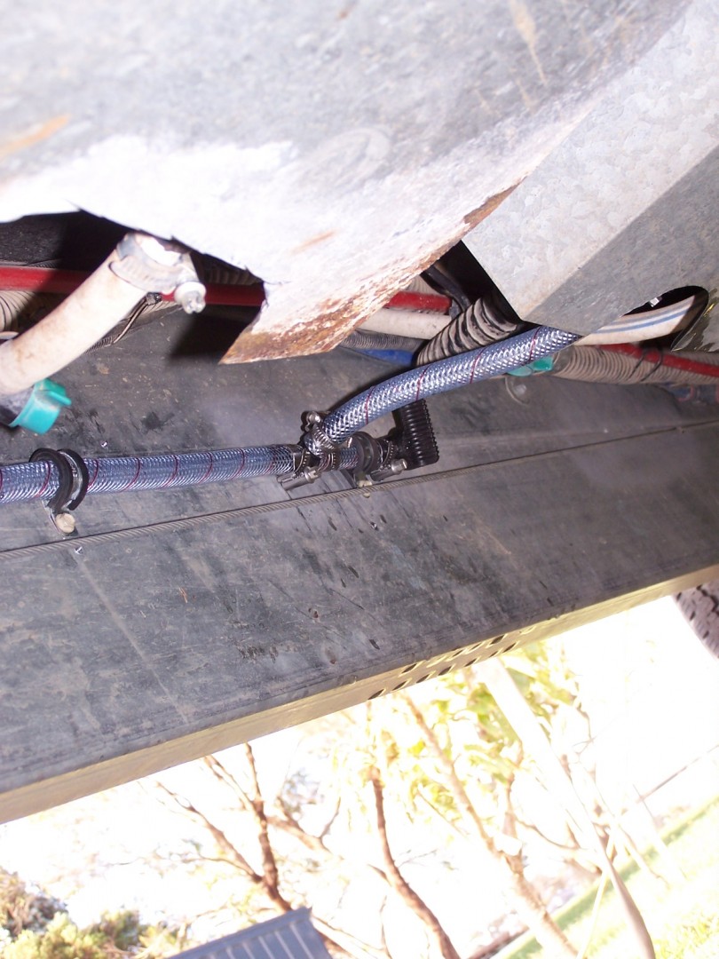

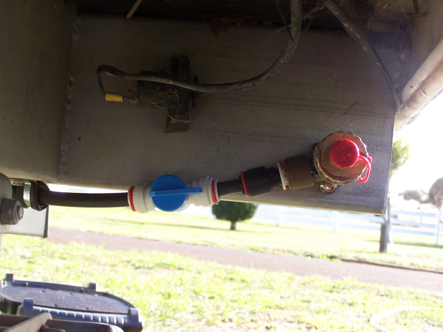

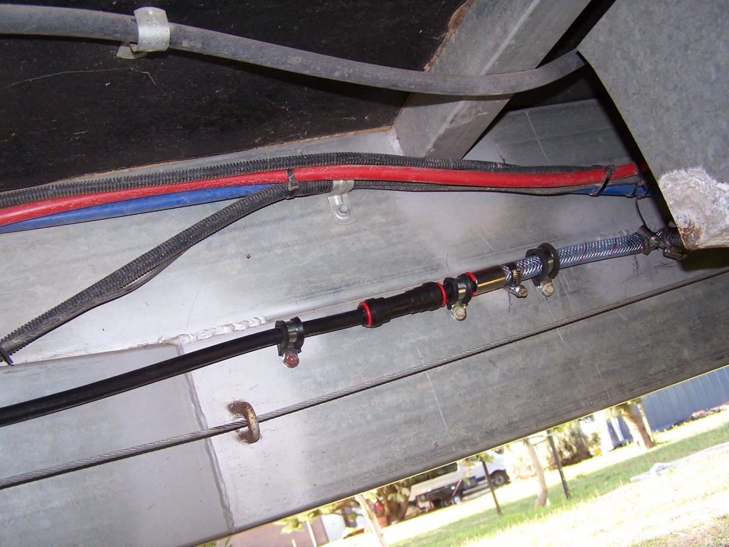

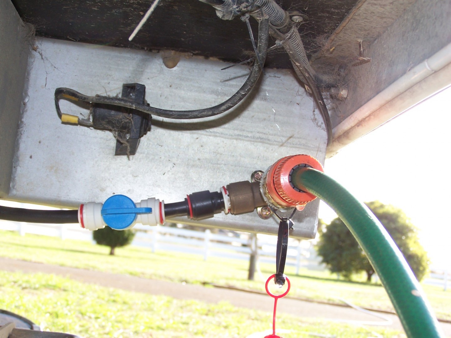

hi m an d , ours were the same a real mongrel to fill , big improvement was to get under and make sure tha that the filler hose once it leaves the fitting you put your fill hose into , dosent have any bends in it if it does go up and down over a chassis rail or whatever it will create a air pocket and thus water blow back , cant get past the air pocket , we did this , found one small rise and fall enough to make it blow back every time , staightened it out , and big improvement or once again also check your breather tubes although unlikely , but you neve know , good luck or try this , use your over flow or drain bungs in your tank coupled together , to a non return valve , a nylex brass hose fitting and connect to tap , drain tap at end of line you use to connect the tanks , use your normal fillers as breather when filling we did this in the end , we get a lot more in our tanks too and no blow back , i,ll attach a few pics

I had the same problem but with all my tanks. Problem was when filling to overflow (from the inlet) it also fills the breather pipe and so I always had no ability for the tank to release the air. What I ended up doing was put a "T" in the drain line with another valve, added a snap on fitting and now fill from the bottom of the tank with the hose. The breather is now the fill pipe. Got the idea of another forum contributor and works a treat.
