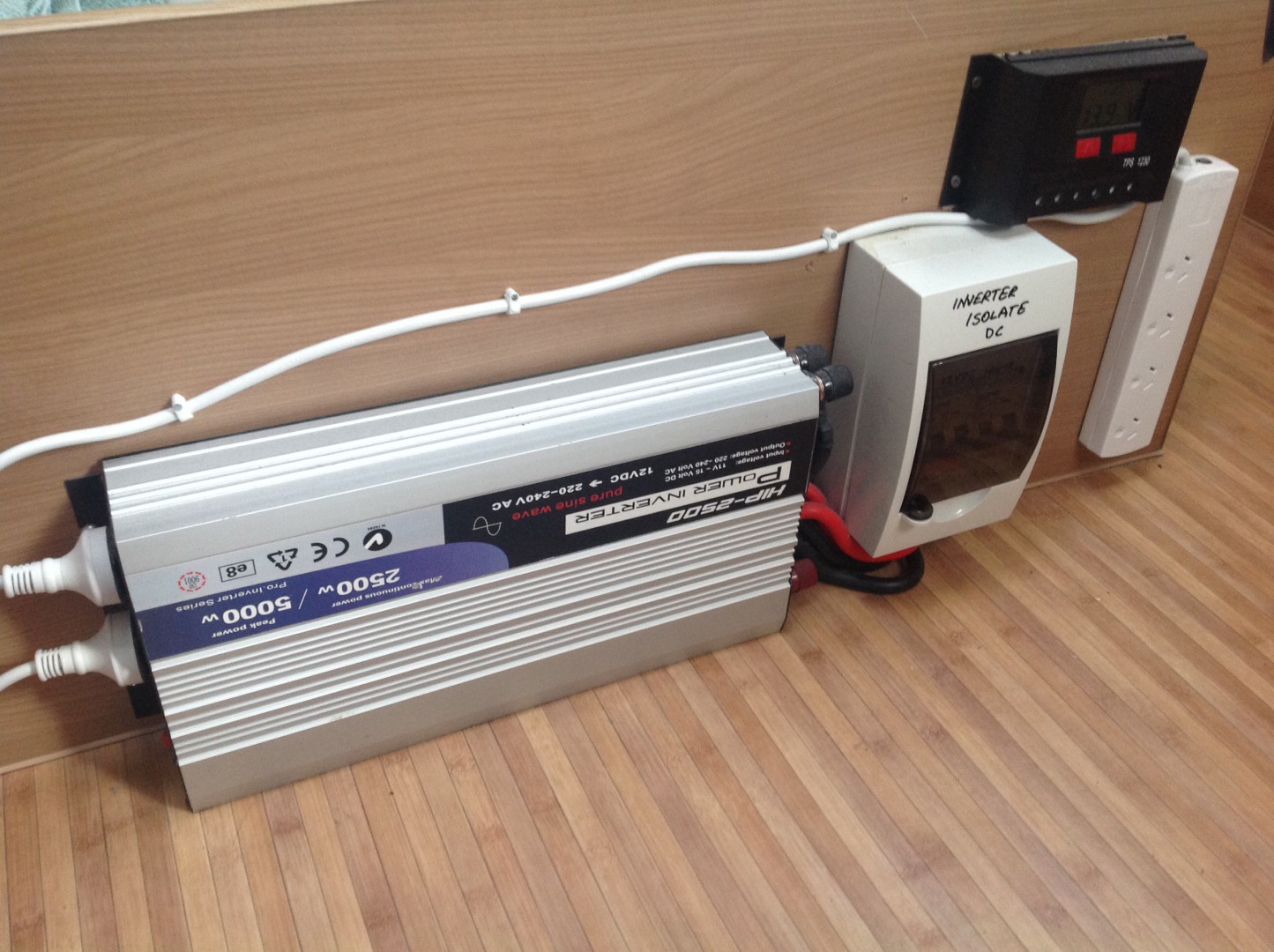

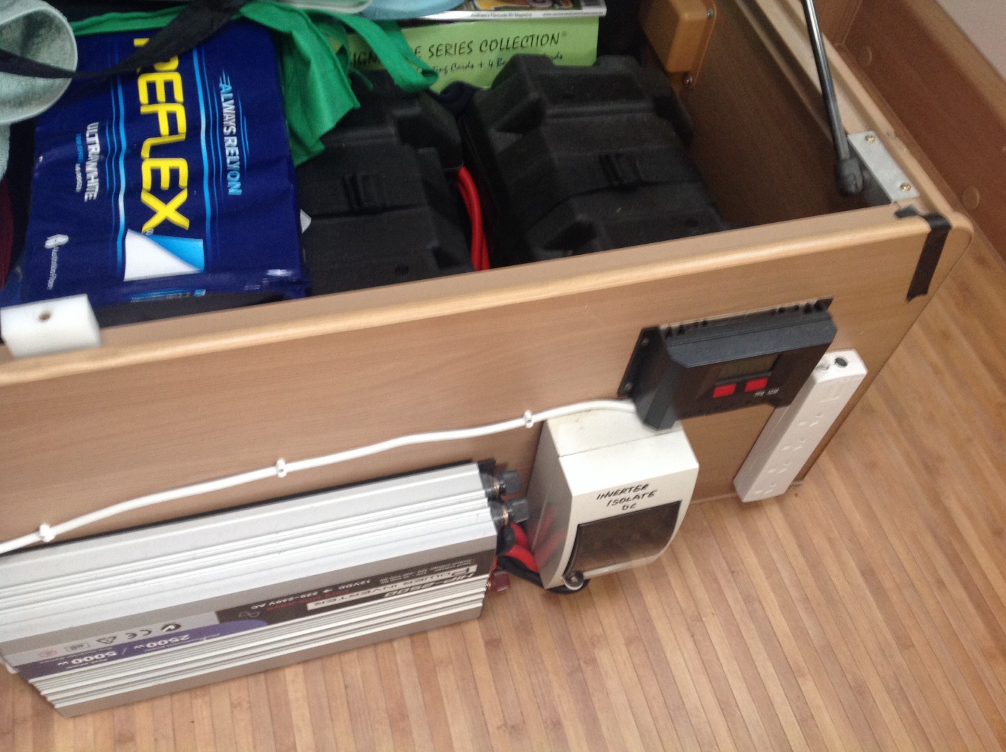

I installed ours at the front of the bed under the bit that lifts up. lucky for me the batteries are just behind. The key is short runs (no more than 300mm) of thick cable, or even better 2 thick cables each terminal. Good airflow is a must for these beasts, they can get hot.
Be aware that a 1500W hair dryer will be dragging about 150 amps or so from the battery, this will flatten them very quickly, and create heat in the inverter.

Thanks for your input guys. the hairdryer is a low wattage one so would easily work without flattening the batteries too much (and i shall be monitoring the time too). it looks like I will have to install the inverter inside the battery compartment (vented to outside) to avoid long leads and closed space. I can run a power board to the inside and the remote panel will act as the on/off switch. I notice that on the photo you have installed a DC isolator Phil, is that important?

Yeah I think it is important Marken, firstly it protects the batteries from overload as they are circuit breakers, and is a place for isolation to protect the inverter during down time. I see you mention an on/off switch may be enough to do the trick. As long as the DC side is fully disconnected.
They are 4 gang 80 amp AC circuit breakers that do in fact work on DC during an overcurrent allbeit slower than if on AC.
Maybe Im a little too safety conscience.
Be careful if you install inside a box, make sure there is plenty of fresh air to vent the beast.

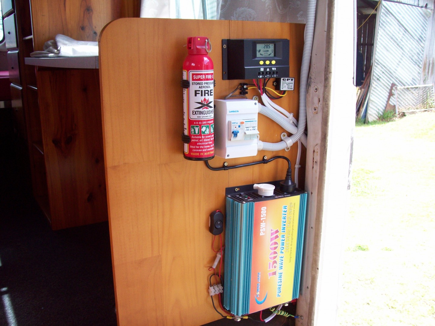

This is how I have our current project set up..
beside the circuit breaker is a 3 way selection switch so I can select Up for Shore power, OFF, and DOWN is Inverter..
