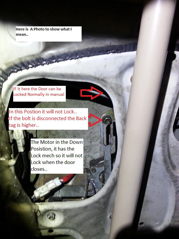

Here is a Photo..
The Bolt shown is the Link from the on/off motor/solinoid, If the bolt is Disconnected the Door Locking system is Allowed to Operate in Normal Mode.. ie you slam the door the Locks will engage..
- From what I have worked out the electric motor is so that when the door is in Autoclose/open mode, it releases the door Lock mech so that door will open..
I'm not sure if I have an issue with the motor you see or some other issue..
So if you Know About coaster and you happen to have the Electrical Diagram for this.. Please..

Here is a Photo..

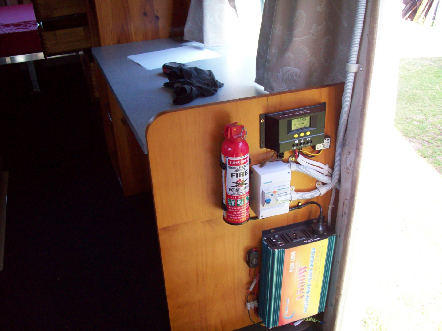

The Kitchen area with the shower at the end of the bench and just for you the electrical department..
