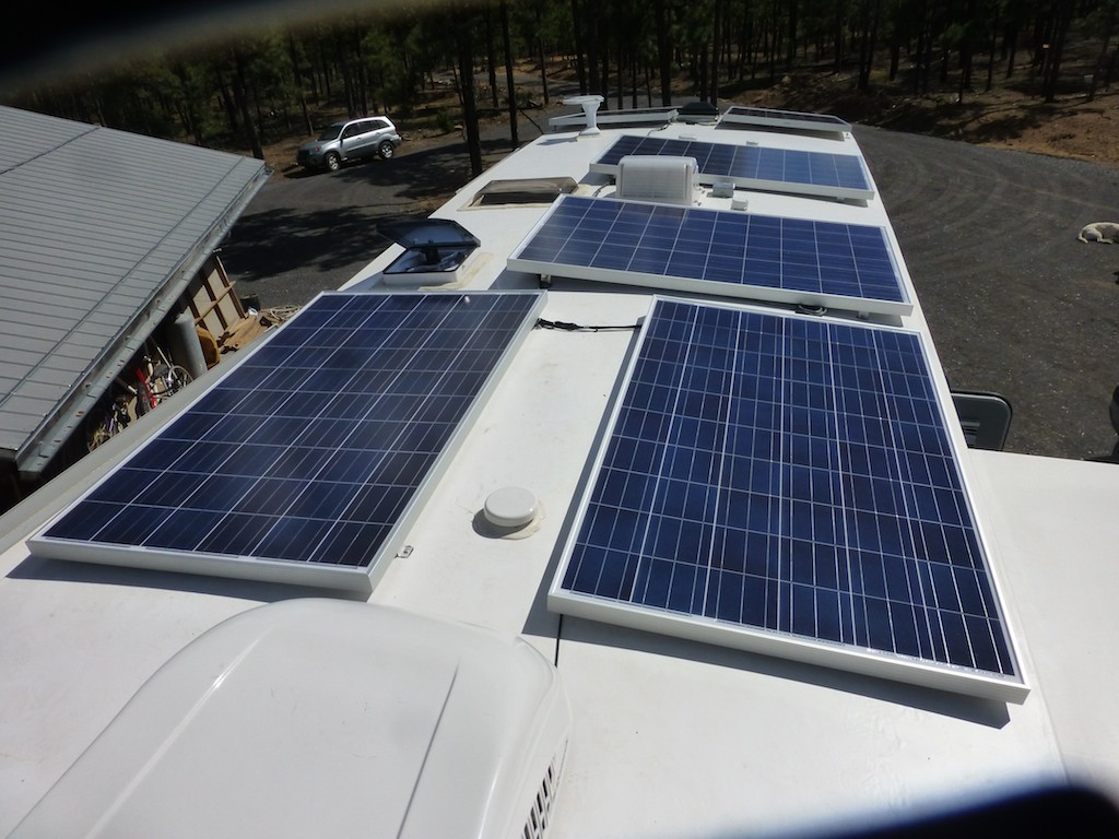

This is the basic rig we have been using for three years. It is the second Open Range 337RLS (337 stands for square footage when slides are open) we have owned. Open Range is a lower medium level manufacturer. The first was totaled March 2013 in Mexico between Puebla and Vera Cruz in a 70 car pile-up (no one killed). Mexican first responders were first rate as was the hospital. It is 34' (10.2 m) long. The 337RLS nomenclature is the square footage with slides open. It weighs 8400 pounds empty (3800 kilos) with a 4000 pound payload (1800 kilos). It carries 81 gallons of fresh water (290 liters) and 4 x 20 pound propane containers. The ground clearance is excellent and though not designed for 4 x 4 roads, it does handle dirt, gravel, sand quite well. We pull it with a 2006 Chevie 6.6 liter 4x4 diesel with dualies. We do have a 50 gallon Transfer-Flow auxiliary tank which gives us a total of 85 gallons or about 920 miles range pulling through the mountains. Diesel is about $3.80/gallon in much of USA (up to $4.50 some places) and around $2.75/gallon in Mexico.
The trailer is insulated for four seasons (folks in Alberta winter in them) and has double pane windows. These make a real difference in both hot and cold conditions.
Our older son has been in alternative energy for 25 years and was first licensed alternative energy contractor in New Mexico. He completed a 1.8 megawatt system for power company a few months ago. He told us that we really had to have solar when we bought first rig 7 years ago. This was transferred to the first open range and consisted of 700 W of solar and 4 x glass mat batteries. He really wanted to see if he could design and fabricate a solar autonmous rig. This one has 1420 W of solar: six 235 W panels ganged in two series of three. We have gotten 1300 W to controller on rare occasions. Voltage goes to Tristar MCCT-45 at 90 V so we have had a maximum of 14 amps. The power goes to a bank of four Manzanita Micro lithium iron batteries (each battery is composed of four China Aviation Lithium cells). Each battery is 180 Ah at 12V nominal. These are then in series to provide a bank at 180 Ah at 48 V nominal. This is about 9600 W-hrs. Power is supplied to 5th wheel via 4.0 kW PSW Magnum inverter and 12 V controller. The solar/battery combination is sufficient to run Dometic refrigerator, micro-wave etc and up to 4 hours of Dometic (power hog) a/c. Photograph of solar panels taken at son's place at 8000' (2430 m) in mountains above Las Vegas, New Mexico. He is entirely off-grid with 7000 W of solar. Daughter has 7000 W in Las Cruces, NM and gets back $60/month from power company. Brother-in-law has 4000 W. New Mexico is a great place for solar. Have read that caravaners in Australia have made more extensive use of Lithium batteries than folks in the US.
We had real problems with "dirty" line power in Mexico and burned out a micro-wave in Baja California and another in Yucatan. Line voltage went from 80 to 145 V. Son came down with family (by air to Cancun) to spend a week on beach and brought down a battery charger. 110 V (which is used in North America) then just goes through charger to batteries to inverter etc. He designed current system to do the same. We have tossed the 50 amp cable and only use the 15 amp cord now for the very few times we have plugged into line power. We do have a 1 kW Honda which we have only run sporadically to make sure it still works.
The batteries have lasted for six days of strong usage in heavy shade. Photograph of spot in Arizona where we had total shade for that time. We were only down to 50% depth of discharge but LFP are supposedly good for 2000 cycles down to 80%. Managed to take off a few branches going in and going out - but panels remained.

We retired and sold our "sticks and bricks" seven years ago and have been on the road since.

The power system consists of the following components:
Solar panels are 100W light weight semi flexible panels (1.3kg each) glued on top of thermal panels, then directly to the roof of the van.
Each set of four panels is wired independently to the boot on the front of the van where they are connected in parallel to a fuse, then through a solid state relay to the solar charger.
The solar charger is a PCM 5048 from MPP Solar, it is a fully programmable 50 amp unit. This unit was selected because the charging voltages are fully programmable, it also has some smarts tracking state of charge (SOC), and some switching circuits that can be programed based on things like SOC.
http://www.mppsolar.com/v3/catalogs/PCM5048_8048.pdf
I have mentioned the battery earlier, it is made of eight 200ah cells, inked in series as two blocks of four cells (two 12v batteries in series). There is another fuse on top of the battery, then to a main power switch before it is connected to anything.
240V alternating current is produced by a 3Kw (max 9kw on overload) low frequency (the type with a large transformer) inverter, it is heavy (31kg), but it delivers great clean power. The only problem is the high idle current mentioned earlier. It now also has a remote switch installed inside the van.
http://www.yiyen.com/portfolio/apc-series-pure-sine-wave-inverter-charger/
The microwave and washing machine are standard, but the standard air conditioner was a roof mounted unit that draw almost 1,700W on cooling, and even more on heating. It also consumed valuable roof real estate. We deleted the standard unit when the van was built, and fitted the Fujitsu split system with inverter technology, it draw up to 700w and delivers as much cooling as the standard unit.
This is a link to the Fujitsu unit:
https://www.fujitsugeneral.com.au/product/astg07cmca-(cooling-only)---2.1kw(c)?category=Lifestyle%20Range&roomsize=SMALL%20ROOM#specificationsTab
and this is a link on the American web site.
http://www.fujitsugeneral.com/wallmountedRLS2_specs.htm
The fridge is a 230L vtrifrigo unit, commonly used in marine applications. It is very quiet, and runs on 12v. It simply works as you expect a fridge to work, keeps stuff cold in the fridge, and frozen in freezer, and it is quiet. Just does the job.
Our van a Retreat Brampton is built to be energy efficient from the start, it is well insulated, all led lights etc.

You wrote Solar panels are 100W light weight semi flexible panels (1.3kg each) glued on top of thermal panels, then directly to the roof of the van Discussed this with son and he does not like the heat buildup when panels are glued to roof. There is a definite drop off in efficiency with temperature but it has to be purty durned hot but it can get there. The weight sounds great though.
We have a TriStar MPPT-45 controller (maximum power point tracker a term I did not know till a few days ago). It is fully programmable and the battery bank has a sophisticated BMS (may have written this already)

I understand your son's concern re solar panels without an air gap under them. I understand the performance degradation with heat, my panels get to well over 70 degrees C, and at that level they are about 83% efficient. However using lightweight panels allows me to use more panels, and this far outweighs the effect of the thermal degradation. It would be ideal if I could devise a way to mount these panels on a light weight structure to form a tropical roof, but given the wind effect on top of the vehicle, I could not devise a good mounting system. It is a great big (and expensive) experiment.
I definitely believe that your choice of greatly reduced coast and ease in mounting is preferable to weight and problems in mounting. As you note, spacing them 3 or 4 cm above the roof does cool the panels to some degree and does provide a "tropical roof". If you did make a light weight structure for your semi-flexible panels, you would still have to emplace them on the structure via adhesive.
There have been numerous discussions in Open Road (RV.Net) about means of bolting/gluing/taping panels. The best installer in US is probably AM Solar in Oregon and they install their rigid panels via adhesive strips. They also sell a lot of kits with the same means of using adhesive tape to hold down the panels. It is our son's belief that flexible panels do not have the efficiency of rigid but that they are improving greatly (as are a lot of things in solar world). He has his paradigms and I am not arguing. I have always found that telling professionals how to do their business is not appreciated - but I still sometimes do it without meaning to.
Black surfaces can really get hot in the SW of the US.
