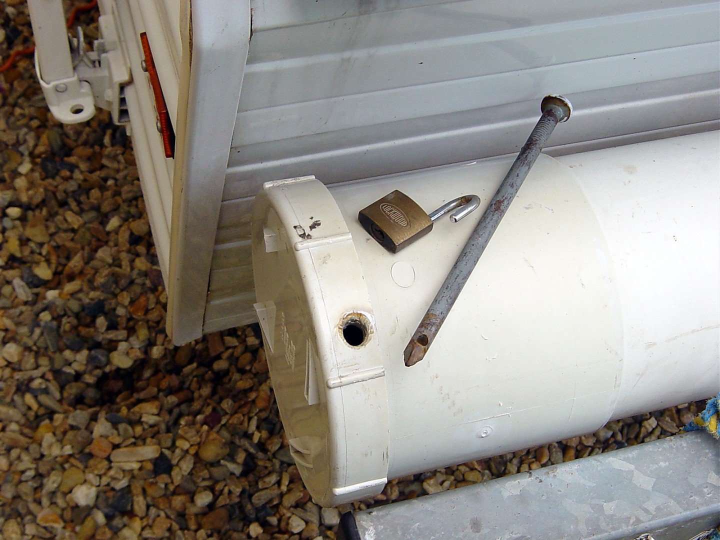

Cupie said
09:58 PM Sep 2, 2014
I fitted 100mm PVC thick walled sewer pipe on top of my rear bumper, secured with the metal clamps used by plumbers.
At one end I glued & screwed an end cap with a bit of carpet & foam glued to the inside for extra protection from sliding pipes. On the other end I glued a threaded end to accomodate a screwed cap, again with the extra protection.
For the essential security I drilled holes thru the fitted screwed cap & pipe and inserted a very large 'nail'. I drilled out the end of the 'nail' to take a small padlock. I have a set of 4 keyed alike padlocks for securing stuff around the van.
Another similar set up has been used on the roof racks for long fishing rods.
Had them for 15 years & 200,000km without problems. But I don't do dirt (bumpy) roads.
-- Edited by Cupie on Tuesday 2nd of September 2014 10:04:18 PM

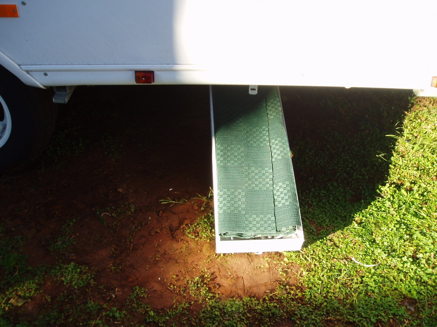

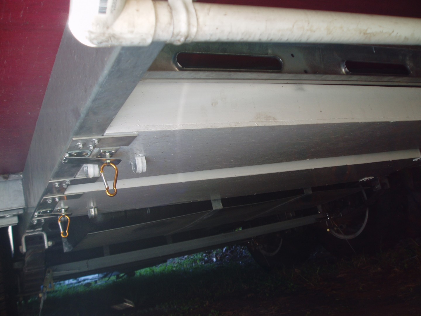

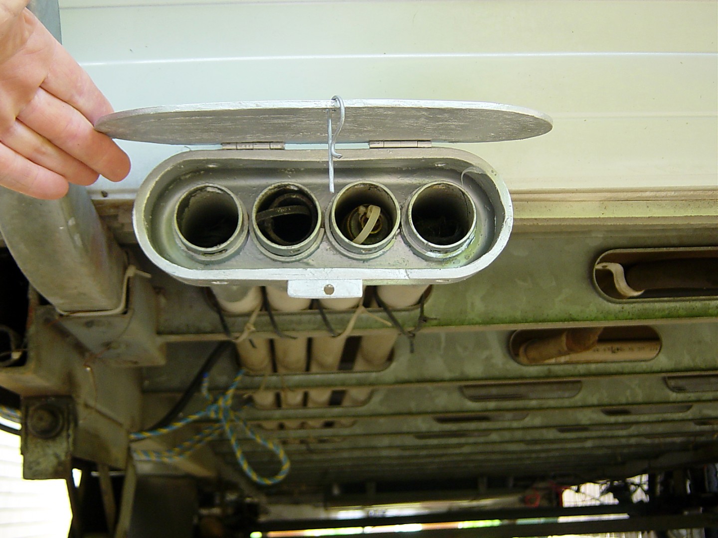

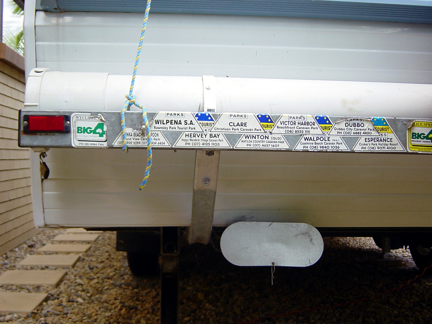

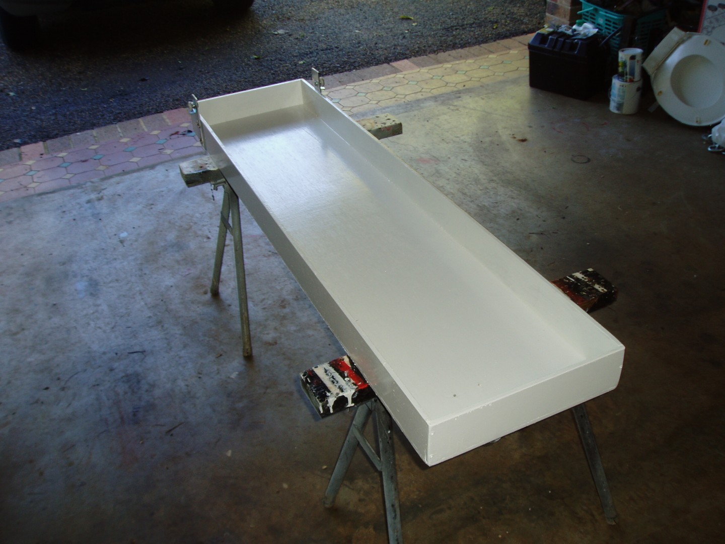

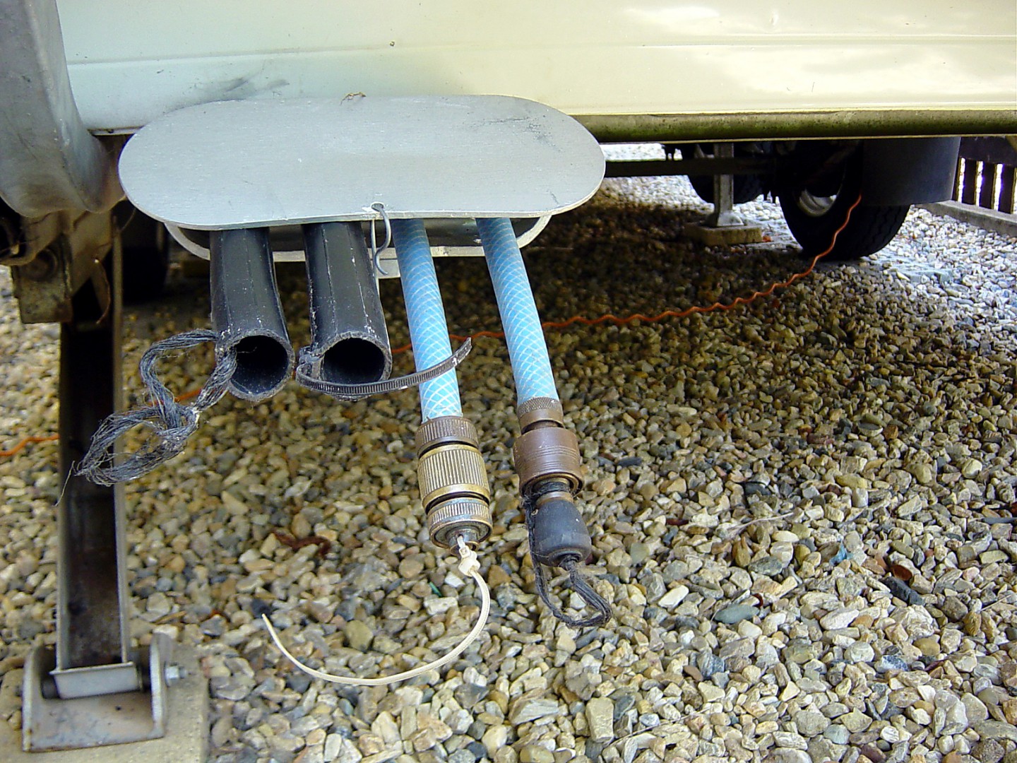

I have a Jayco and built two sliding draws that fit between the cross members of the chassis
What a great idea.
I'll look around my son's junk heap to see if I can find suitable material to do the same.
Might have some issues with the 40?mm conduits that run thru the slots in the cross members. The conduits hold my sullage & water hoses. See attachments.

Cupie said
10:10 PM Sep 6, 2014
DEBnWEG wrote:
on a previous van, the previous owner had PVC pipes installed front and back and used a modified tent peg that had a hole drilled thru the straight end (not sure if you can buy them) and used a pad lock. There was a hole drilled thru the end screw cap of the PVC pipe. Worked a treat. Thinking I might install similar to rear bumper of Jayco to keep my fishing rods in check too.
Similar to the arrangement shown in my previous post on this thread?
What a great idea.
