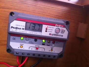

aussie_paul said
03:36 PM Sep 2, 2014
So, what is my Setec ST Series POWER SUPPLY ?
Plendo said
03:50 PM Sep 2, 2014
Paul, I believe it is PWM.
aussie_paul said
03:53 PM Sep 2, 2014
Ok David, thanks. I looked at my Prostar/ not Setec regulator today and it was showing 5 amps input to batteries. I removed 240V from van and it went back to .8 amp??
-- Edited by aussie_paul on Tuesday 2nd of September 2014 05:23:21 PM
Plendo said
04:29 PM Sep 2, 2014
That would indicate that it is charging from multiple sources, thus a combined charger.
Hopefully it is a smart multi stage charger designed to opttimise the operational life of your battery.
aussie_paul said
05:17 PM Sep 2, 2014
Ok, went out again for a look, now overcast. The solar amps were showing 2.4 so plugged in the 240V and now no solar amps. I guess that means the 240 charger is taking batteries to a higher voltage than what the solar regulator is set to?
aussie_paul said
05:22 PM Sep 2, 2014
The Prostar regulator says "solar amps" BUT could it be showing the 240 v Setec charge input as well? Ooops I said I looked at the Setec charger, it was the Prostar.
-- Edited by aussie_paul on Tuesday 2nd of September 2014 05:24:01 PM

aussie_paul said
07:12 PM Sep 2, 2014
Now that I have stuffed up with the identification of components, what would my Prostar be?
Paul
Take a look here
http://www.setec.com.au/jayco-customers/
Jeff
Paul
It is a PWM but a very good quality.
Take a look here
http://www.morningstarcorp.com/products/prostar/
Jeff
-- Edited by Sharke on Tuesday 2nd of September 2014 07:37:04 PM
Thanks Jeff.
