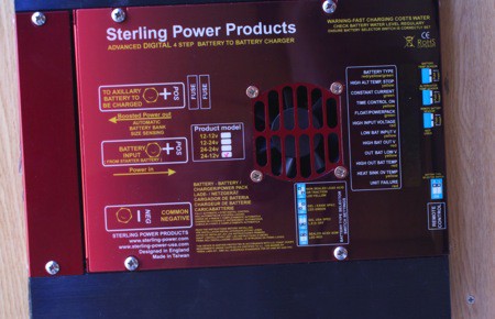

Isuzuswag, on reading info on the Sterling website, re their Battery to Battery chargers, I found this statement For best effect use open lead acid batteries, avoid gel, sealed and AGM batteries

Mr Sterling has a "bee in his bonnet" about any battery except wet cell LAs.
He makes some great products, but is completely out of touch on this issue.
