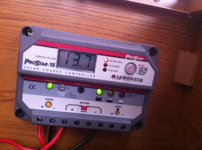

Peter, when we bought the van it had a 120a/h battery in it. I had Jayco Ballarat fit a 120w solar panel and the regulator. I am wondering if it should be married up to the original set up?

Paul it is set up as a charger.
Some of these units have the ability to limit your load so you do not drain your battery too far, still others have the ability to track your state of Charger (SOC) over time.
Often you will find two or three different versions, all using the same plastic case. On the other hand it may just not have been connected.
It will still work fine as a charger.

Thanks Dave, is the power that is arriving at the regulator from the solar panels ac or dc?
03:26 PM Aug 26, 2014
Paul, I have the exact same regulator except it's Pro-star 30. Mine aren't connected at the Load either. Came like that when I bought the van.

There is no need to connect the load terminals it dosent effect the way the controller works
but if you want to connect it just run a black wire from the - terminal to a earth and a red wire from +terminal
to the positive side of one of the switches that is easy to get to

The battery is the load folks. Connecting a "load" Only draws parallel current away from the battery charging.

No worries Paul, just an afterthought the battery acts as a capacitor storing energy for the final 12V circuits. Now before everyone jumps up and down about the capacitor comparison the solar regulator adds to the charging during operation (obviously daylight).
I cant understand why there is a load terminal on board.

The Load is a Source of power from the battery that can be programmed to operate via a command from the Solar Regulator..
- Ie you can have a Light Programmed to operate for a set time via the Solar regulator..

Paul, the controller and any other multi stage charger is best being mounted close to the battery. They charge better if there is less voltage drop in the cabling between the charger and the battery.
Using the load terminal is handy if it could be done but it will take a bit of doing in a Jayco. I use the load current meter function to check on the loadings of things as they are switched on. There is also a low voltage disconnect function associated in it to protect your battery when it gets discharged. (There is no load time switching with this regulator.)

Phil, I think you may have misinterpreted the "load" portion of the controller, yes for the charger part the battery is the load. In this case these terminals are used to control the supply of power from the battery to a separate load.

Yeah I got that Plendo, I was not aware that the regulator can be programmed for a load. My mistake was that I assumed the "load" was from the solar panel, asked myself why a light during the day?
This is my solar regulator and am wondering why there is no connection to the "load" terminals?
