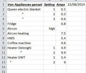

Electric blankets was what I was looking at CC. All research into learning about all the requirements and possibilities available for us. Conducting the research is interesting to say the least.

Paul
You don't need a very big inverter for electric blankets may be 1000 watt would be big enough

Thanks Cyril. I have 2 x 100 amp/h batteries, 120w solar on the van roof, and 120w portable solar. I think I have a 1000w inverter somewhere BUT after shifting I cant seem to lay my hands on it. Hopefully find it before we get to conducting longer free camping. We still have 3 lots of 5 day Travel Auctions at Portarlington, Apollo Bay, and Loxton to use up before March 2015.

Ok Guys, I get the message. I obviously do not need such a large inverter for my needs!!! Laptop charging and electric blankets are the only "requirements." Thanks everyone for your input.
