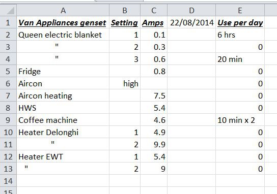

I didn't think you would part with your "U Beaut" coffee machine Paul.
Back on topic now.
Good info there Paul, Interesting to see the different current draws.

Yes Doug, I thought it might be interesting for some.

Heating really does soak up power, I found the same, so plan to fit either a gas or diesel heater.

Paul Love your Figure in the table could you Please add time that you expect to use the item's..
That will help in working out how many AH you use...
That is far more important amp's over Time...
My coffee machine uses about 600- 1500w of Power when its making the coffee but then that is only for the times that the system is pumping/heating the hot water so no more than 20sec Per 150ml shot of water..

Might possibly use microwave, say several x 1 minutes, to reheat coffee after chatting to other GNs!!!! I guess there could be 1 hour of the Delonghi 4.9 amp heater in the morning and evening if we don't have either gas or diesel heating installed yet.

Ran tests yesterday to give me some idea of how much current draw the 240V appliances have. Running off the genset..
