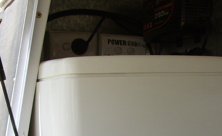

Thanks for the replies. This is the set up I have seen. It seems to be common in production vans. This one is a millard. The front switch selects electric or battery. The rear switch selects car or van.
I will only be charging the van battery with solar. I agree with your comment Murraman re current draw. I believe the 3 way fridge draws around 15 amps on 12 volt?????
Can anyone suggest a selector switch that would be rated 20 amp or better. I have found some that select batt 1, batt 2 or both. I don't want to connect both batteries.

HI Pete
Clipsal do have 20A 2WAY 240v AC mechanism
So I would imagine that is the ones shown in the pics
