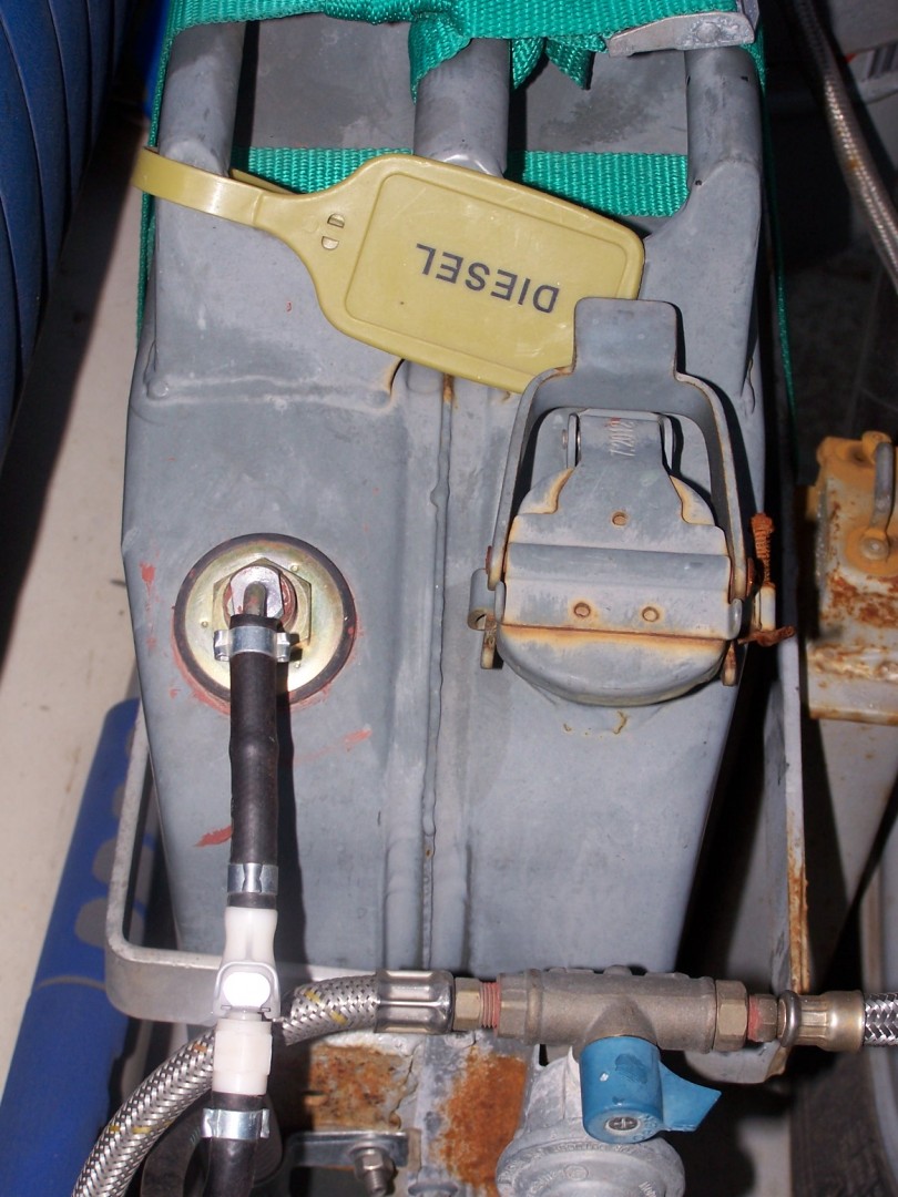

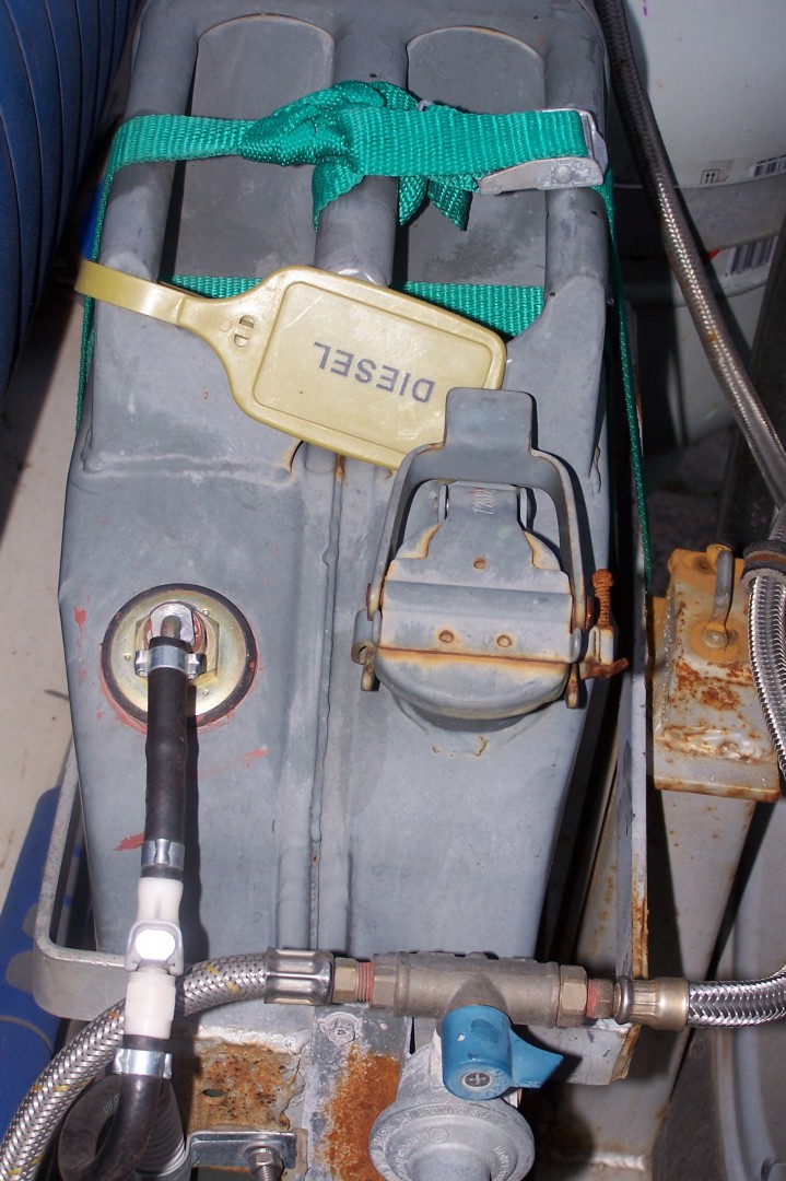

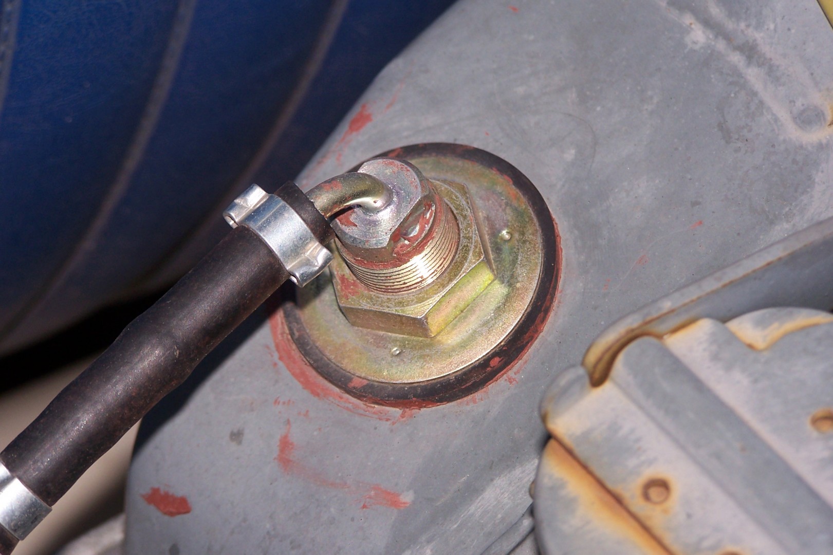

my dilemma is my jerry can fuel contaier for the diesel heater , it has always been ok till this time went ot take it of to fill it and it was all caved in both sides , is this a cause of no venting from the cap or maybe a poor quality steel can , got me a bit puzzled , this is the first time we have run the heater and got the fuel container really low ie volume , thinkiing maybe poor venting would make it worse when it was low , anyway we will apprecaite any thoughts greatly attached a few pics of our fuel container

I would think the vent (if there is one !) is blocked. If there is no vent the vacuum created by the fuel being pumped out will collapse the side walls of the container.
Drill a 1 mm or smaller say 0.5mm hole in the Jerry can locking cap to vent the can. The smaller the better. Or make sure you release the locking cap each time you use the heater.
I would be fitting a small water proof vent fitting in the new Jerry can.

Jerry cans are inherently sealed, so unless the pickup arrangement has a (blocked?) vent built into it, you will need to either unlatch the filler, or add a vent of some kind to prevent this happening again.
You may be able to restore your jerry can by pressurising it with compressed air... slowly AND carefully!

G/day mate, Jerry cans are designed to be air tight, they are not designed to be used as a reservoir from which you draw fuel,
the only way it can work is to install some sort of vent.

I used a 10 litre plastic outboard oil reservoir tank which I had spare works a treat I do have one spare if anyone comes my way and wants one

I still think a little none spill Fuel Breather valve would look neater. They have tiny breathers for Motorbike and Trail Bike tanks that let air in but prevent fuel leakage if the bike is laid down.
-- Edited by elliemike on Sunday 17th of August 2014 07:07:01 PM
stick one of these little bugga's in it..
www.ebay.com.au/itm/Red-Petrol-Tank-Fuel-Cap-Breather-Gas-Vent-Hose-Tube-Motorcycle-Dirt-Quad-Bikes-/160935302279
