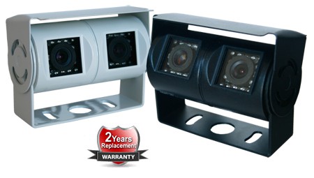

Glenelg wrote:COUPLE duel cams for you. black or white one cam points to floor the other looks at traffic coming down rd
Dougwe wrote:
David I read somewhere on the forum that someone had two cameras on the back of the van, one set so you could see the for reversing and one for see further behind so you could see the traffic etc. They also had one on the tug looking down to hitch up. You just change the view on the screen to suite. Sounds a good way of doing it. Yours is cheaper though.
i read that as well Doug. would like to get it on mine from memory cam looking down is 90d or 120d and other cam is 40d for longer distance
The dual cameras would be an excellent option for people setting up a new camera from scratch.
