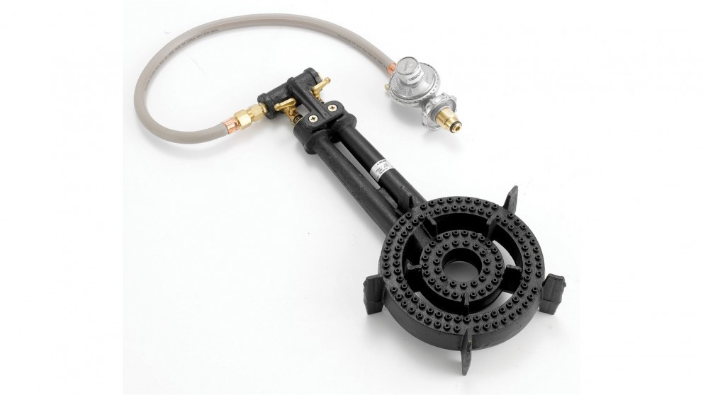

If your running your webber on a baynot on the van do you still need the regulator on the webber hose?
same question goes for a protable gas stove

Check to see if you have a regulator between your gas bottles and the gas line. We have, and run the weber without its regulator hose.

no i have a ziggy bbq with a bayonet fitting installed to van and it uses the same regulator fitted to the van,
the portable gas stove may be different pressures so you would need to check that out ,
as i understand it the hose that fitted to my ziggy has a large hole but on some bbqs the hose has a very small hole which is a higher pressure so would need its own regulator,

The regulator should be on the main gas bottles, no need for another. Just check to make sure.

Most portable gas stoves run on high pressure gas they will not run with a regulator in the line, if it is a high pressure gas stove it needs to be connected directly to the gas bottle.

Ignore the last one, Allany. Another case of people not reading the post correctly. Webers, Ziggies & virtually all gas barbecues are low pressure requiring a regulator in the line. If your unit presently connects to the bottle via a regulator, provided your rig has a regulator between the gas bottle & bayonet fitting, you'll not need a second.

I stand by what I said in my post most portable gas stoves are designed to run on high pressure gas they are not designed to run on low pressure, go and have a look at some portable gas stoves in your camping shop, they are meant to be connected directly to lpg gas bottles, in most cases these are small gas bottles, but they can be run on larger bottles.

Suffering hell, guess we'll be seeing the obituary of Roving dutchie sometime in the future. Butane stoves (Coleman, Campmaster, etc) run on their own specific cylinder types. To attempt to run them on Propane (LPG) without a regulator is a shortcut to a box. By the way, LPG stands for low pressure gas.

i had a look in snowy's today half the portable stove were high pressure, other half were low pressure the low pressure needs a regulator without it you may blow yourself up.
