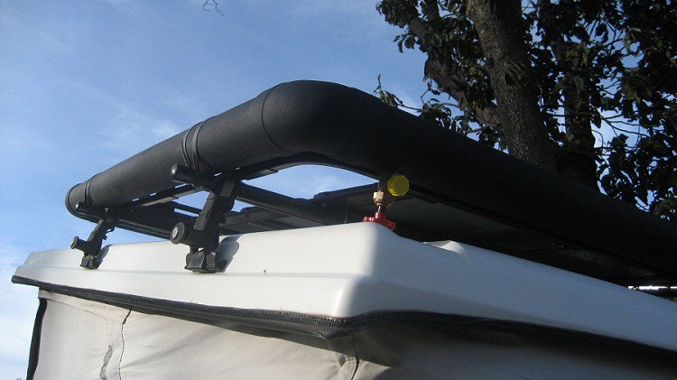

Maybe 2, 3 or 4 large PVC pipes running the length of the vehicle or around the edges with some switch over flow system could work? You would have to work out a safe weight limit for weight up that high.
The idea of Water up High on any vehicle is stupid, if you are going to be traveling..
If you want to have water up high to get it hot then there are systems that you can do.. While traveling, the best location for the water is as LOW as possible.
