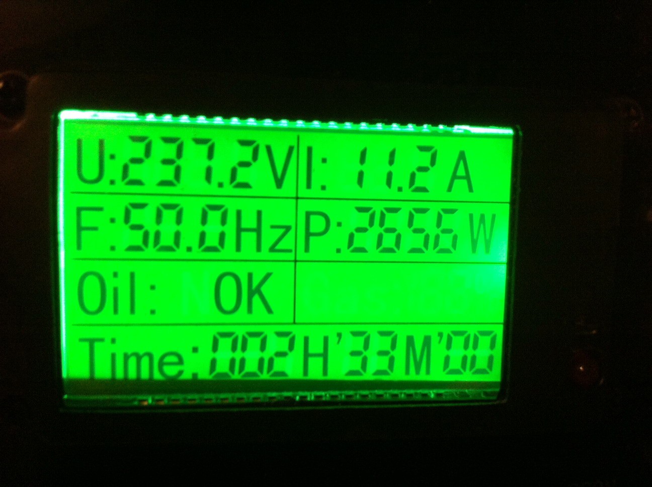

Thankyou all for the great input, i have purchased a 4 Kva digital inverter generator, its supposed to be silent, i suppose i'll hear when i try it out. Happy travels Fran

I bought a 2Kva on Ebay but it would not drive the van aircon. The fine print said it was only 1600 watts continuous!!!! I then bought this one for $580 and it runs the aircon or a fan heater. Sunday I had it running 2656 watts at 11.2 amps and it still had some reserve.
http://www.ebay.com.au/itm/4-4KVA-SILENT-GENERATOR-INVERTER-PURE-SINE-caravan-camping-tent-fishing-hiking-/160861456562?pt=AU_Hardware&hash=item25741708b2&_uhb=1
