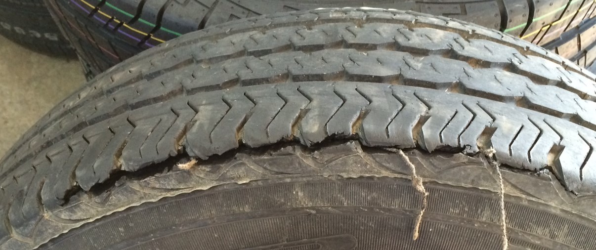

I recently posted in the Tech area regarding advice on tyre brands.
My tyres were 6 years old and only done 12,000 klms
This pic is what was happening to an inner rear tyre. Another tyre was showing a similar problem (much smaller) and the issue was missed at a recent (1 week ago) service other than a comment that I should get the wheels balanced.
It really pays to have your tyres checked regularly.
Reposted here as this is a real concern for safety.

That's a worry Mike that was missed by your service people. Maybe time to rethink who does your service.
Tyres seem to be like us humans, as we get older we get wrinkles and cracks

Mike C, those tyres look like that could be recaps, not a good idea to use recaps theses days, not a big saving on price between the two types.
Mike C said
08:12 AM Jul 29, 2014
Hi Wombat
They were not recaps I would never use a recap on this type of vehicle.
They were the original tyre supplied by IVECO when new and manufactured (the tyres) in early 2008.
What you are seeing is the result of the steel bands delaminating within the tyre and then starting to breakthrough the outer casing.
From what I have read tyres can look brand new on the outside but the aging affects the internal bonding of the steel reinforcement internally which can result in a sudden disintegration of the tyre.
I am thankful that I didn't have to have that experience.
Dougwe
The service guys were shocked when I called back in and showed then the pic. These guys have always been pretty good in the past and as this was an inner tyre probably not that visible without removing the wheels, I will give them the benefit of the doubt this time.

My tyre supplier informed me when I replaced the low milage 6year old tyres on my wife's little car. That all the new tyres are starting to fall apart at about 3 years now because of the high quantity of synthetic used.

What brand of tyre are they that were supplied by Iveco ? My Iveco had Maxmiler tyres made in Indonesia. I had a blowout on Ipswich Freeway last May and replaced all 4 with Pirelli. My tyres were 7 years old.
Mike C said
09:15 AM Jul 29, 2014
Hi BG
They we're Pirelli
Mine is the 6.5 ton Iveco with dual rear wheels.
Mike

I had exactly the same thing happen to a tyre on my van.
It had been a (covered) spare on the back of the Jayco since new ... around 12 years ago & had never been on the road ... until I had a flat when in Melbourne & put it on the van.
After the trip back to Bris from Melb & another return trip to Sydney, the tread began to lift coming back to Bris from Ballina. Fortunately a passing motorist alerted me to the lifting tread.
I am now very conscious of tyre age & replace them at 5 years irrespective of tread.
Same for the Patrol ... Had an old Cooper tread begin to lift on a trip to Esk a couple of years ago.

We had a similar situation to many others, namely a blow out, but at high speed. We were on the Hume F'way and doing a sedate 110kph when a van tyre exploded. Unfortunately it was on the right hand side and we were going around a slight left hand bend which meant much of the weight was on the right side. My wife was driving at the time and she remained very calm and didn't panic and gradually steered the vehicle off the road safely.
Our van is a large Off Road Camper Trailer with high profile A/T tyres and they appeared to be in mint condition despite having been fitted as original equipment ten years prior. Nobody warned us about the lifespan of tyres and we just thought that if they had decent tread depth and weren't perished, then they should be fine. We now know better and our little drama could have ended very differently.
Most vans probably don't travel enough klms to wear out the tread on their tyres. Always check the date stamp numbers on your tyres before setting out on a trip. If they are over five years old they need replacing. Far better to be safe than sorry.

in Australia tyre life is 7 years,[Ozone, & wasing the tyre in certain "Soaps," Oil/ Grease. will cause a shorter tyre life] tyre "Ageing" failure is only 8% of a tyre problem, first look at your picture told me straight away that is purely "Under Inflated" "Over Loaded".
Tyres made in "Asian" countries are generally no different that those made in the UK or USA as they are more than likey owned by a Major manufacturer anyway.
IMHO any tyre made in Oz is well worth staying away from, we just cannot build a good "round" tyre, first choice for me would be Michelin, BFG [owned & manufactured by Michelin] or any tyre made in the UK, Germany, France. On saying that, if the pressure is not relevant to the weight being carried then any tyre will fail after a period.

I think a big part of my issue was that the truck sat for the first 4 years doing only 700k
The last 11,000 taking the next two years.
Inflation was by the book at 75 psi.
The new tyres are continental and are a 121/120 load rating vs the original at 118/116
The guys that changed the tyres felt it was caused by agin has the rubber also was very hard and dry.
I am no expert but sure glad I changed them.

When you say only 8% of tyres fail due to ageing what does that really mean?
Only guessing here but if the average driver travels say 20k per year then the average driver would wear out the average tyre in say 3 years One then has to wonder what % of tyres are still on the road at say 6 years of age?
assuming the average above it would be a reasonable guess that maybe 10% to 15% get to hang around that long as the majority get worn out before they get a chance to age.
If that assumption is correct then one could assume that (based on an 8% overall tyre failure cause) somewhere between 53% and 80% of tyres over 6 years old will fail due to aging?
or am I getting confused here?
Mike

Mike I have been told by the tyre people that when a tyre gets to 6yrs old it is time to change them.
I always change my tyres around 4-5 yrs depending on wear,i also look for any small cracks developing between the tread a sure sign of the tyre starting to perish.
