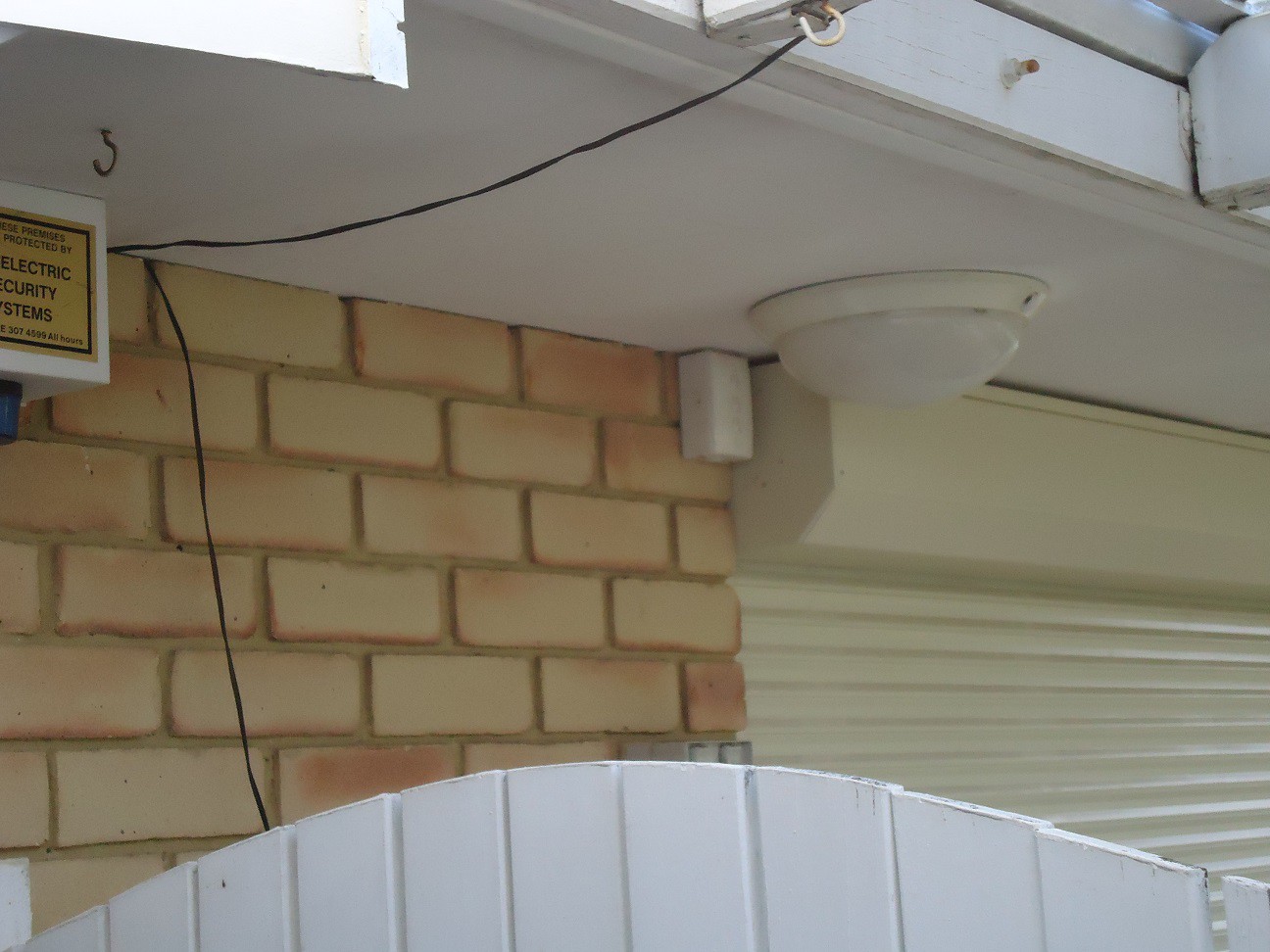

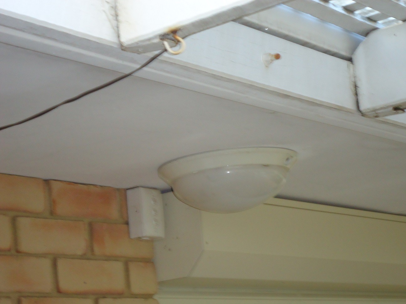

This is what they are like and location. They are a three gang plate with three vertical switches, no neon light like the one in the odd picture but the plate and switches are similar.
There is an open lattice pergola leading off the eaves. I think the leads shown are for Xmas lights, presumably 240V off a transformer.
The owners said the triple gang light switches are for outside garden lights, installed prior to their ownership.
Note the round sensor light near the switches, one further down under the eaves is full of water due to water leaking from the roof into the eaves.

I'll pass that on Juergen. Yes the mounting block looks like it has a knock out bit for conduit like you might find in a workshop or garage etc. Is a 3000 a circuit tester????

The switches being high up under eaves In the corner would normally be considered in a weather proof location, as would be the light fitting
But if water is getting back into the eave,sI would be very worried about the rear of the light fitting getting water in
I do hope the metal base of the light fitting is effectively earthed & the home has a RCD fitted on those circuits

The wire alone is not legal if 240v I don't see an earth either. if 12v DC it's not a problem .. Should be saddled, supported way better ..

I don't know where those loose wires terminate AK, they look like they go through the brickwork, probably into the room on the opposite side of the wall, I am guessing being Xmas lights they are probably running off 240 plugged into a socket inside the home via a 12V transformer like a lot of Xmas lights are.

The wires coming that appear to be coming out of the wall are actually only pushed in between the brick top and eaves fibreboard, they are for fair lights working on 12 volts, the down one leads to the control box (I couldn't see where that was or where it plugged in etc.).

From memory if switches etc under eaves or out of weather . If it's within 45* angle from eave it will be fine..
Yes it can be squirted with a hose . But so can any power point!

Had a talk with them this morning, yes the had an RCD fitted so all good.
We already had our RCD fitted so won't have to worry about that.
