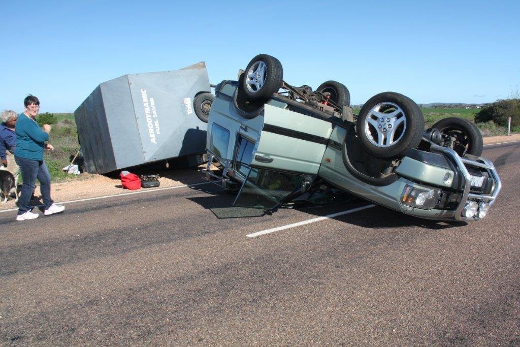

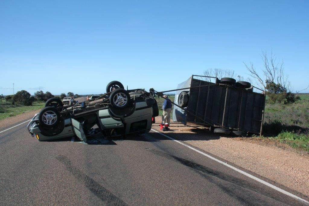

My towball survived this roll-over I had.....so did I..I was still hanging upside down in it when these were taken...quality towballs can take a lot of punishment obviously......I still have it..looks fine but I will never use it again....my beloved Landy either.....Hoo Roo
What a bummer of a thing to happen. So my question is, are you towing again or do you intend to after experiencing a rollover?

I still tow my Heritage and Horse Float...I have a re-newed very healthy respect if either starts to weave/wobbles.....I guess you all know the feeling.....my Heritage has stabilizers of course however that fully loaded Hire Furniture trailer didn't.. and blew a tyre on a sweeping corner with high winds near Cowell township on Eyre Peninsula..my first accident in 49 years of driving..I have never even had a speeding ticket in that time either, how boring am I?... and driven in all States bar Tasmania at this stage......
If it had not been for my trusty folding pen knife I would still be strung up, upside down, like a Xmas turkey by my seat belt....it was such a relief to cut the belt and fall on my head in the cabin...diesel engine was incredibly still running for a while upside down and I couldn't get my hand to the keys to switch it off.......I will never travel without a folding penknife in my pocket again....notwithstanding what the law dictates...the person who was first on the scene who rang the police, gave the wrong address as Cleve instead of Cowell and I was hanging for some 20 minutes whilst Ambos, SES and Police raced towards Cleve instead of Cowell......
I also learnt to keep my keys for such things as the secure locked towing hitch handy on my car keys as well, as it could not be unlocked by SES to separate from the up-turned vehicle...
