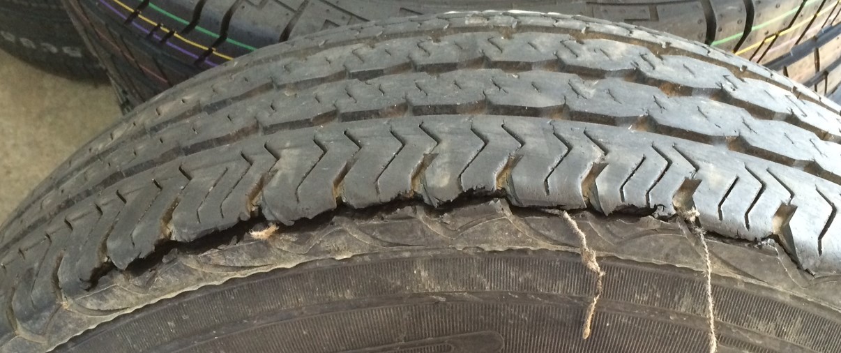

Mike C said
09:34 PM Jul 28, 2014
Had The continentals fitted today.. Wow what a difference in the ride.. like floating on Air.
Glad I changed as once removed one could see that two tyres were about to totally fail on me.
The pic is of the worst one.
Its doubly annoying in that the van was serviced only a week ago and this issue was not spotted other than a general comment that the tyres could do with a balance.
I had mentioned to the service guy that I was thinking of changing the tyres due to age and got the impression that they felt it was over kill and a waste of money.
The tyres were manufactured in early 2008 and had done just on 12,000k
one point to remember when buying tyres is the age of the tyre BEFORE you buy them, on the side wall of a tyre is a code, it looks something like this LMLR 5107 the letters are of no concern the numbers are what we are interested in, first two numbers (51) are the week in the year that they were made, second two numbers (07) are the year they were made, go check when yours were made.
Mike C said
09:19 AM Jul 29, 2014
Hi wombat
0208 early 2008
New tyres are 0414 so pretty current
_wombat_ said
10:24 AM Jul 29, 2014
Mike C wrote:
Hi wombat 0208 early 2008 New tyres are 0414 so pretty current
I once had tyres fitted and they were not cheap, saw the date while still at the tyre shop and they changed them to newer ones,wonder how many times they have gotten away with that in the past on other customers, needless to say I do not use that tyre shop anymore.
