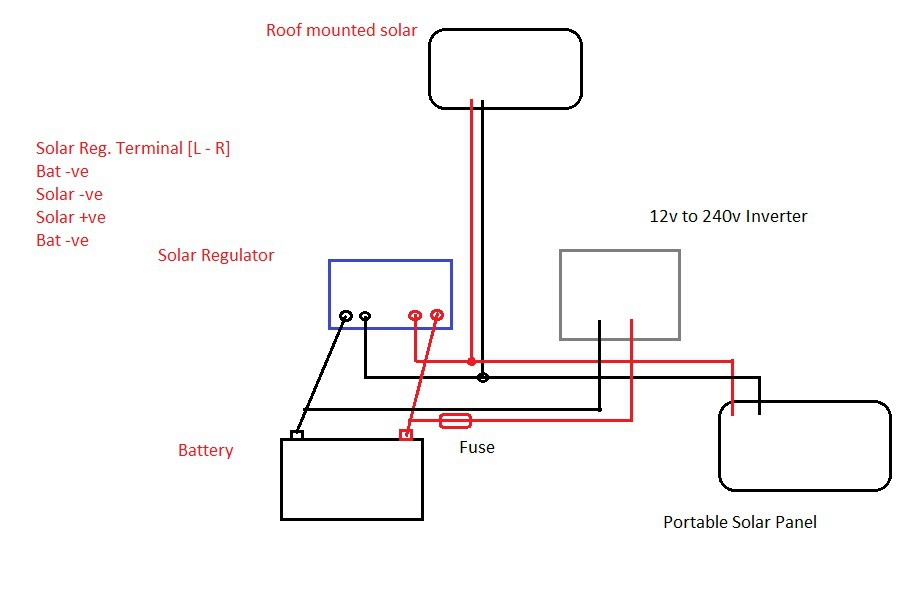

SnowT said
08:05 PM Jul 14, 2014
Tom I'm not sure what you have..
But a Basic of just the DC side.. At least What I understand..
Yeah that's what I've got Jurgen .... except I don't have the portable solar yet and as it's regulated I figured I'd go direct to battery's via clamps once I boost the size form 4mm to 10mm cable for easy removal, I can't really see the difference (pretty much like adding a portable 9ish ah battery charger from another source).
-- Edited by TizTom on Monday 14th of July 2014 10:29:33 PM
Ok It seems you are now referring to the solar REGULATOR As as converter
The sole pupose of that REGULATOR is to control the charging of the batterries
IT SHOULD be set,[If such sttings are available] for the BATTERY type
Model umber of the REGULATOR may help in that regard
It should be as near as possible to the batterries so it sees the true battery voltage & REGULATES accordingly
It also seems you do have an INVERTER to run 240V gear
As pointed out earlier you will have energy losses between 10&20% using an inverter.
Do you have the Specs for theINVERTER & please read Snow's thread on inverters
Depending on the inverter it will have a no load current or sleep mode
it will be drawing power the whole time it is CONNECTED to the battery, even if not supplying a load
THe Cable run length & cable size between the battery & the INVERTER can play a significant part in the INVERTER performance especall yunder heavy loads
Is the Fridge the only 240V .appliance you run from the inverter??
The solar will do very little for & should not supply the inverter direct.
Both should be connected DIRECT to the Battery
In Snow's thread tyou will find an explanation by me, of the effect of lower voltages at the inverter's 12V input.
I would still suggest you need to recalculate your TOTAL daily Ahrs or WATTS use.
IMHO, you are underpowered & the batteries may be coping a flogging
Do you have a low voltage cut out fitted for battery protection from over discharge
Best if you can give useage during Solar charging time & when solar is not inputting [ say from 2PM to 10AM]
Charging Lead acid batterries requires about 30% more Amphrs than was taken out & that varies with battery age & health, so night time [nonosolar time] can be a significant problem
That will assist in determining how much solar you may need to keep the batterries near fully charged
PeterQ
-- Edited by oldtrack123 on Monday 14th of July 2014 11:23:44 PM

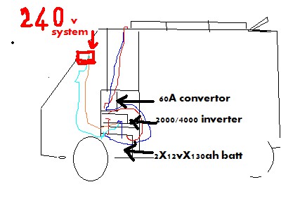

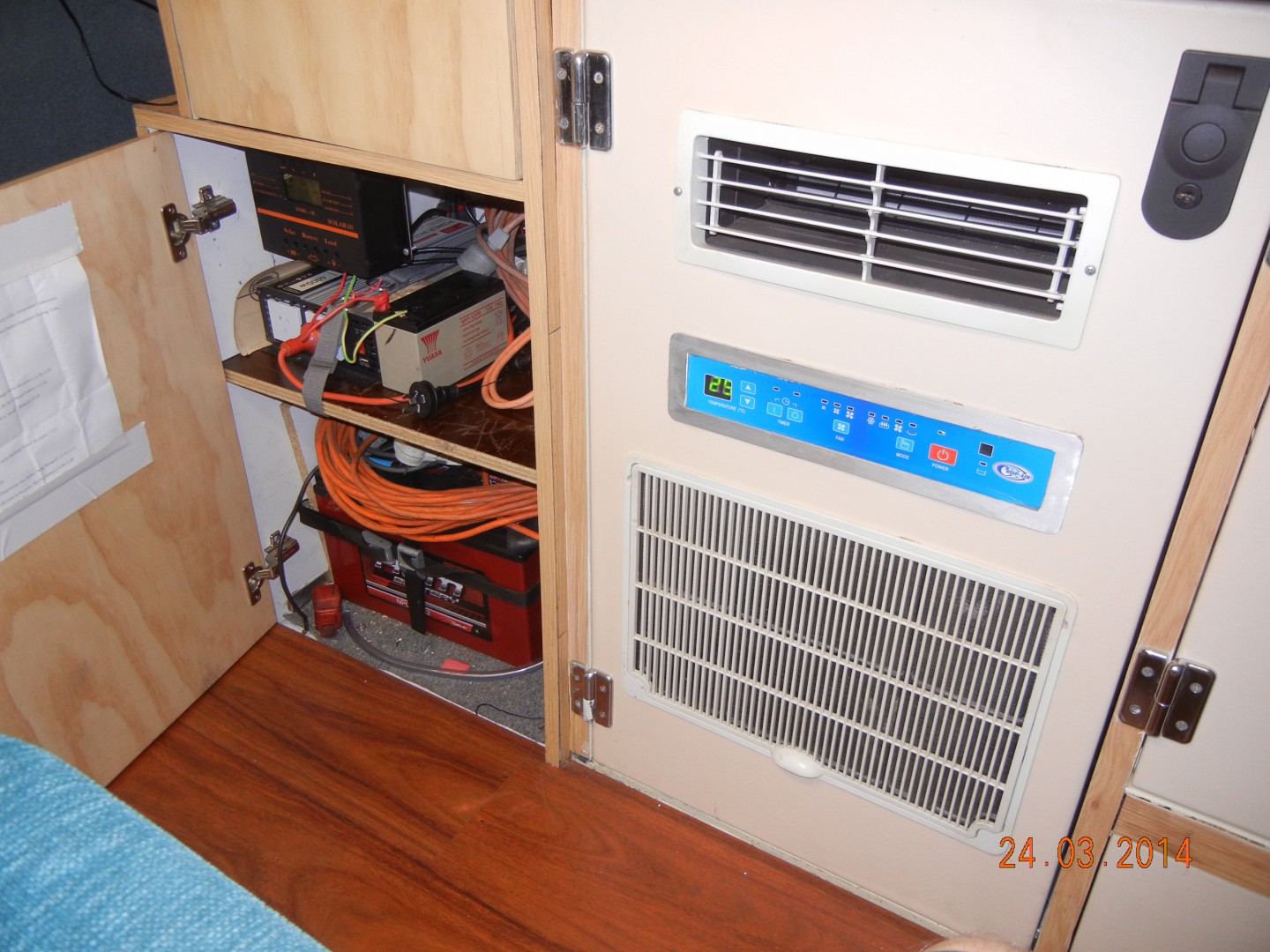

Sorry mate, I always get regulator, inverter and converter mixed up so here is what I have, all battery cross cables are ex starter cables from Subaru's with 13mm+ and 10mm- core black or black and yellow thin wall plastic, all battery's are linked and earthed separately.
Sorry, the solar on the roof is connected to the CONVERTER only The Converter is connected to the battery's The battery's are connected to the INVERTER The portable solar will be connected to the Battery via 10mm copper core cables and Anderson plugs once modified for ease of removal
I hope my stupidity is now understood and thank you for your patients, I've been living in here hard parked for 8 months so it must be pretty right though only a couple of weeks free parking, I just want to know if I'm getting the optimum from the cheap nasty crappy system that I have bought
The convertor is about 400mm from the batterys and uses 13mmcore copper cable, the batterys are 300mm from the inverter also using 13mm copper core cables. The cables from the 3 panels are joined above the roof at the entrance, they are approx 1.6m from the converter, they are 10mm copper core +&- joining them.
-- Edited by TizTom on Tuesday 15th of July 2014 12:45:15 AM

Your Solar regulator Needs to be as CLOSE as possible to the Batteries to help cut down on Voltage Losses..
You would be better off getting a Folding Panel that has No regulator and as Long as the voltage supplied from the panel is near the output of the panels on the Roof just supply yourself with a Parallel connect across the cable from the Roof solar.. Use an Anderson Plug for it..
-- Also make sure that you incorporate a Fuse on the circuit..
-- Also Have a Coated Stainless Steel Cable securing the Panel to your RV.. for security reason's..
Ok hope this helps you..
Juergen

HI Tom
