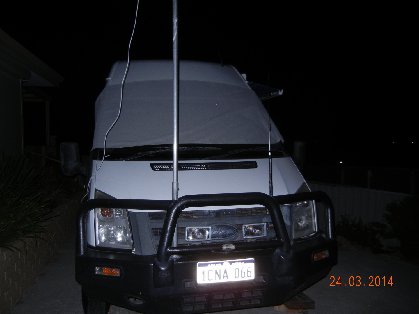

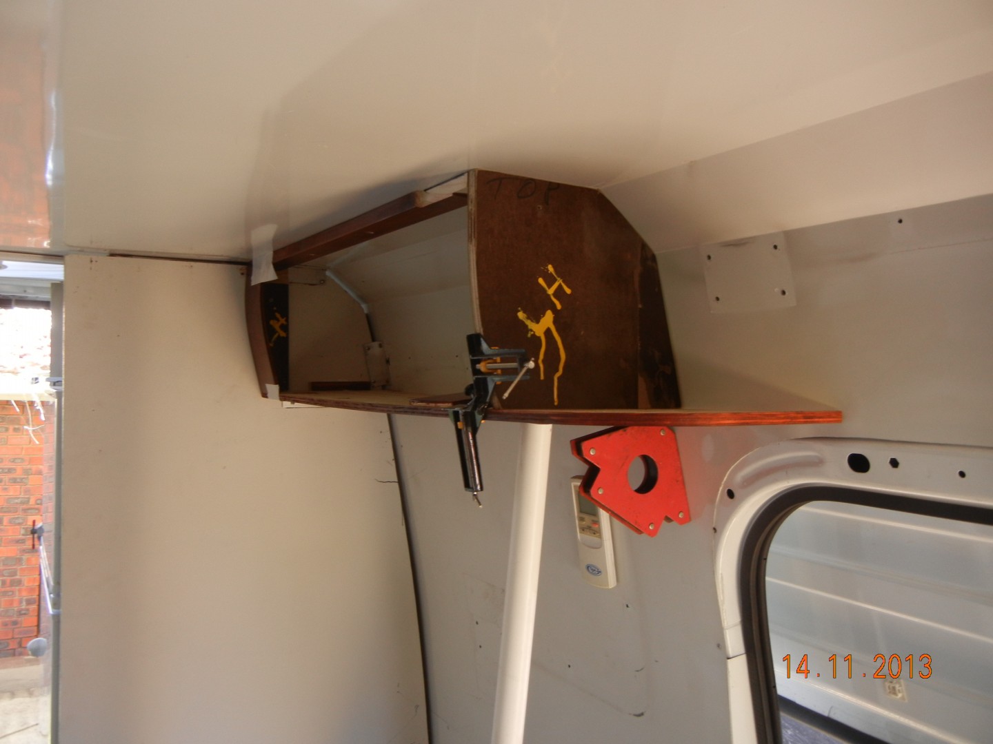

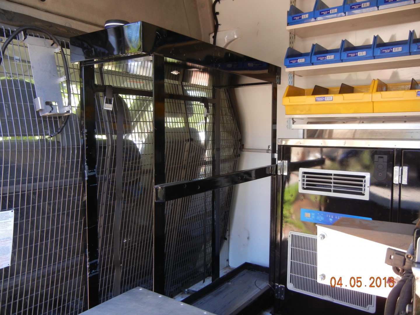

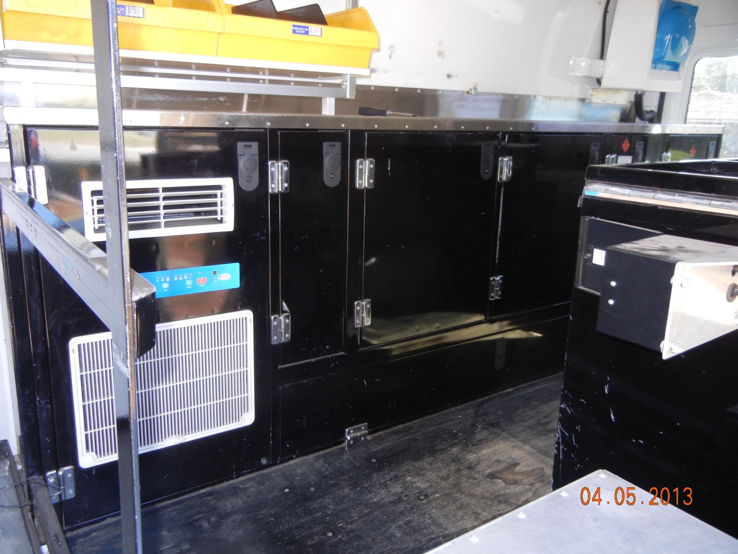

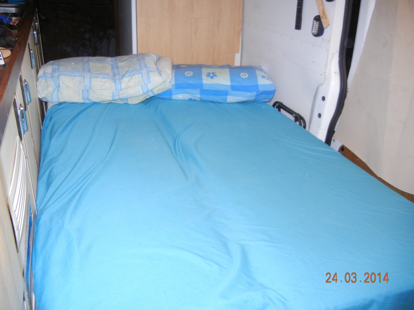

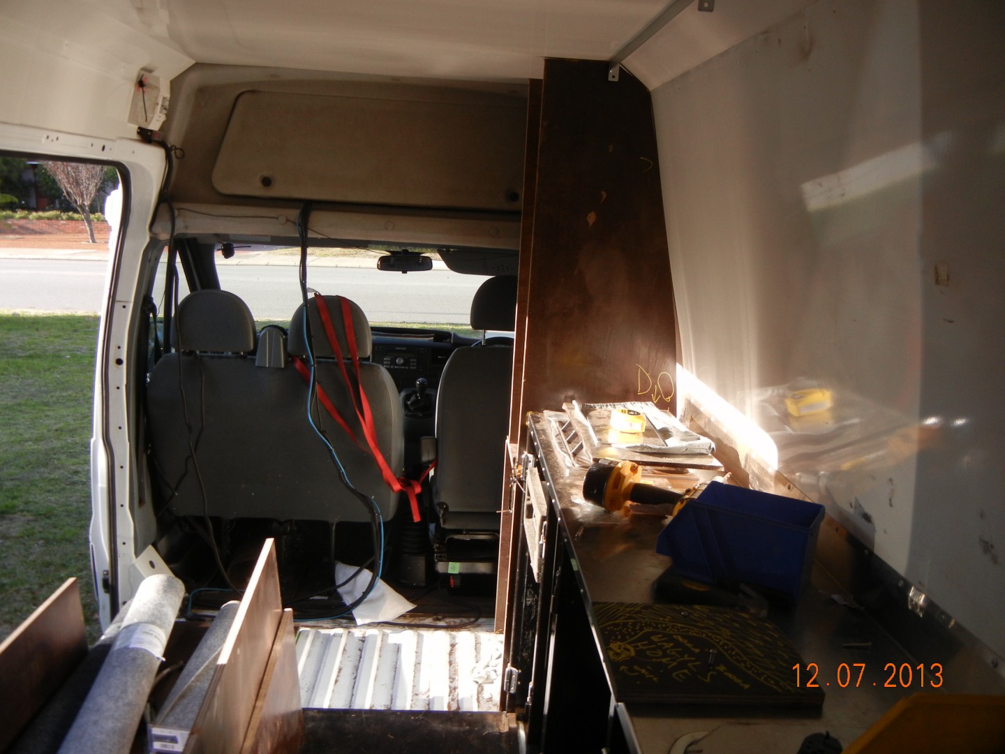

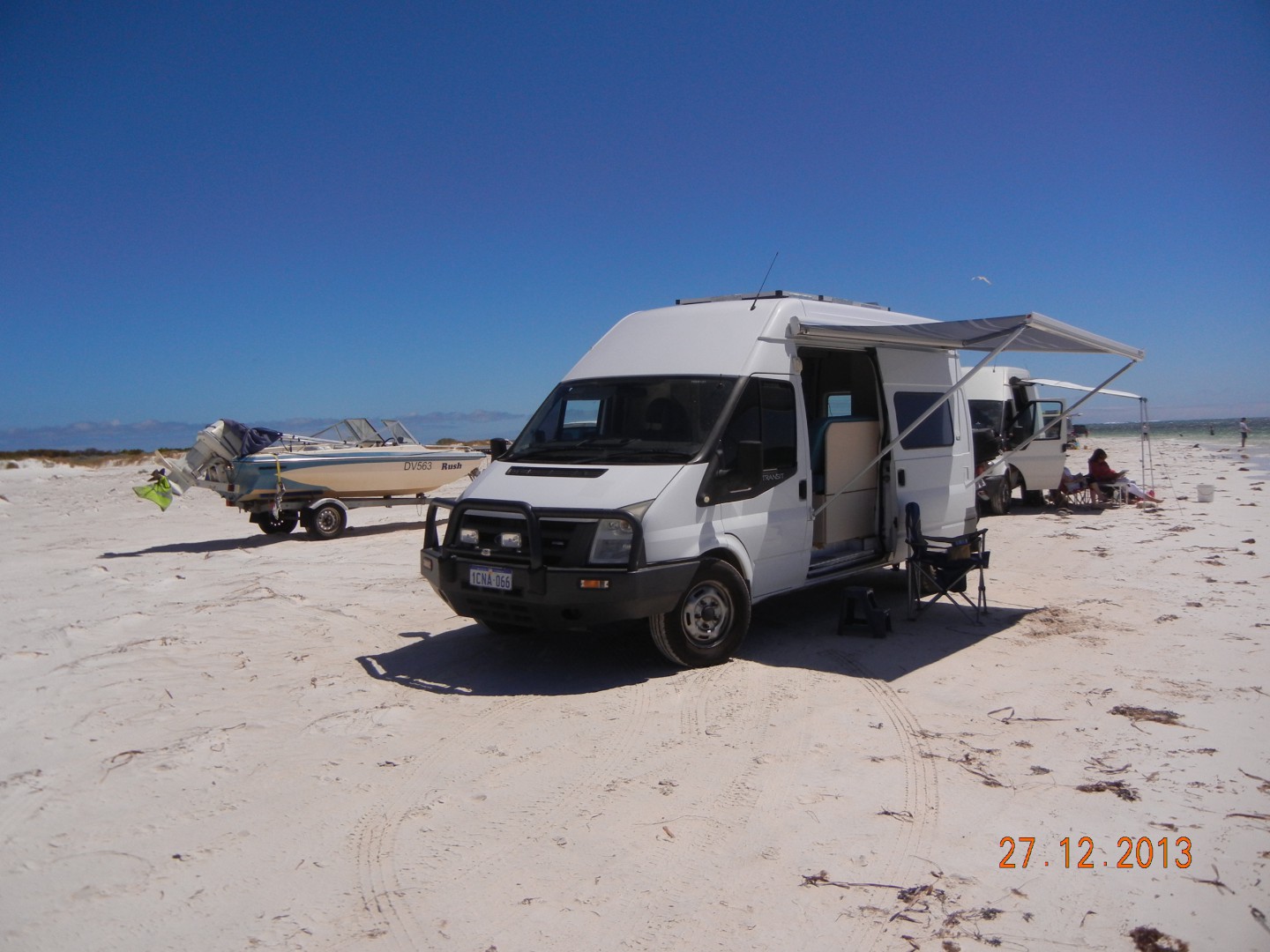

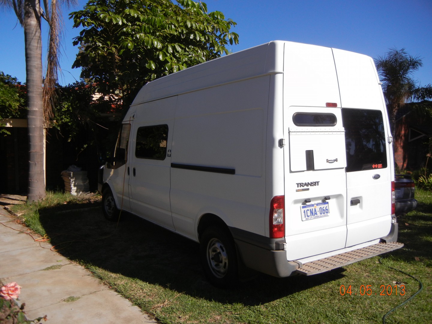

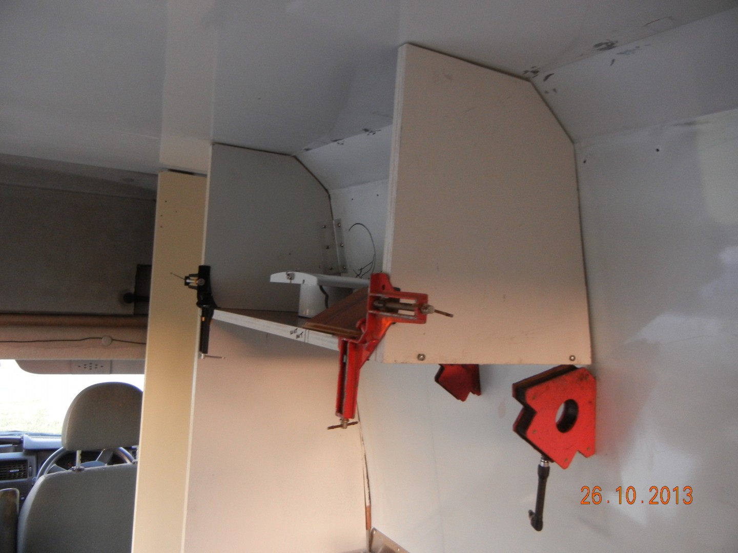

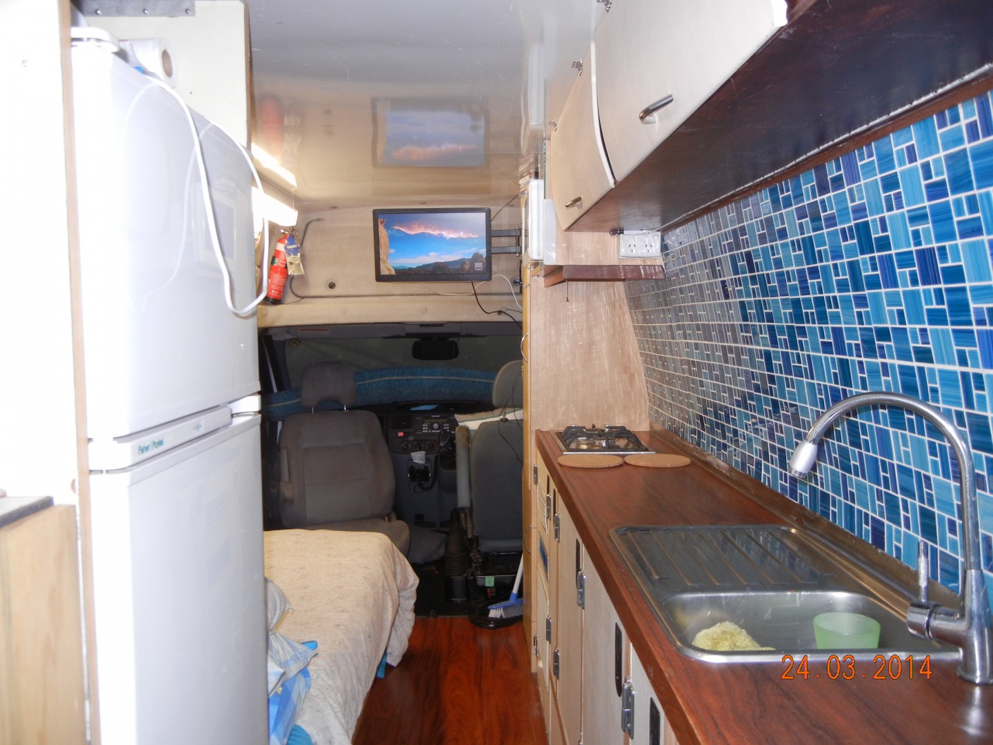

Hi everyone, well this is the rig I built last year after deciding I needed something to do between hospital visits as it wasn't safe health wise to go back to Thailand where I'd been living for a while.
It was a pretty quick decision, sort of thought about it for a couple of days then next thing I know there is an 07 ex Telstra optical fiber repair - Ford Transit sitting in the drive
It's a long wheel base high roof 2.4td 6 speed with 160k on the clock in excellent condition. I paid 22k

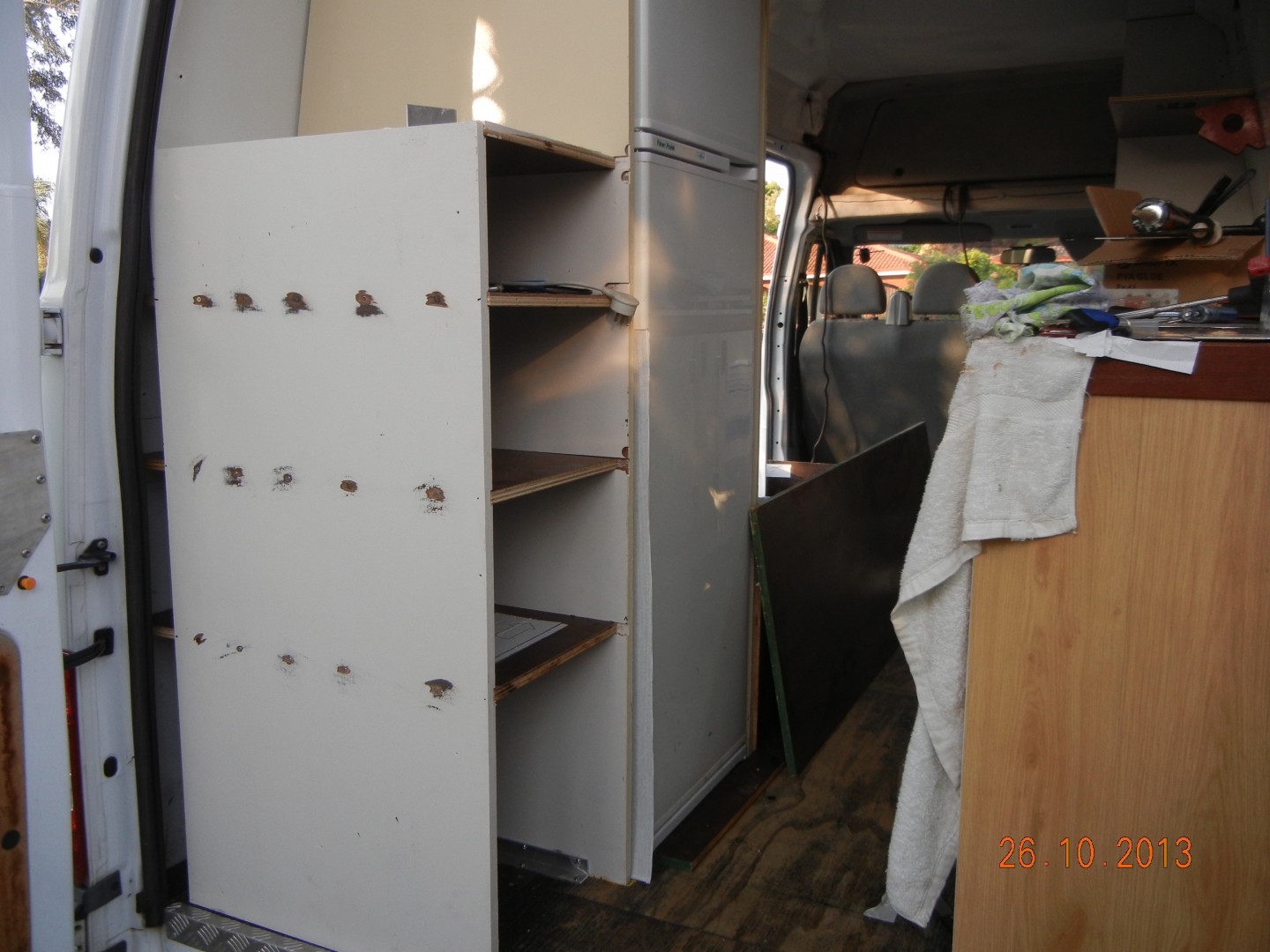

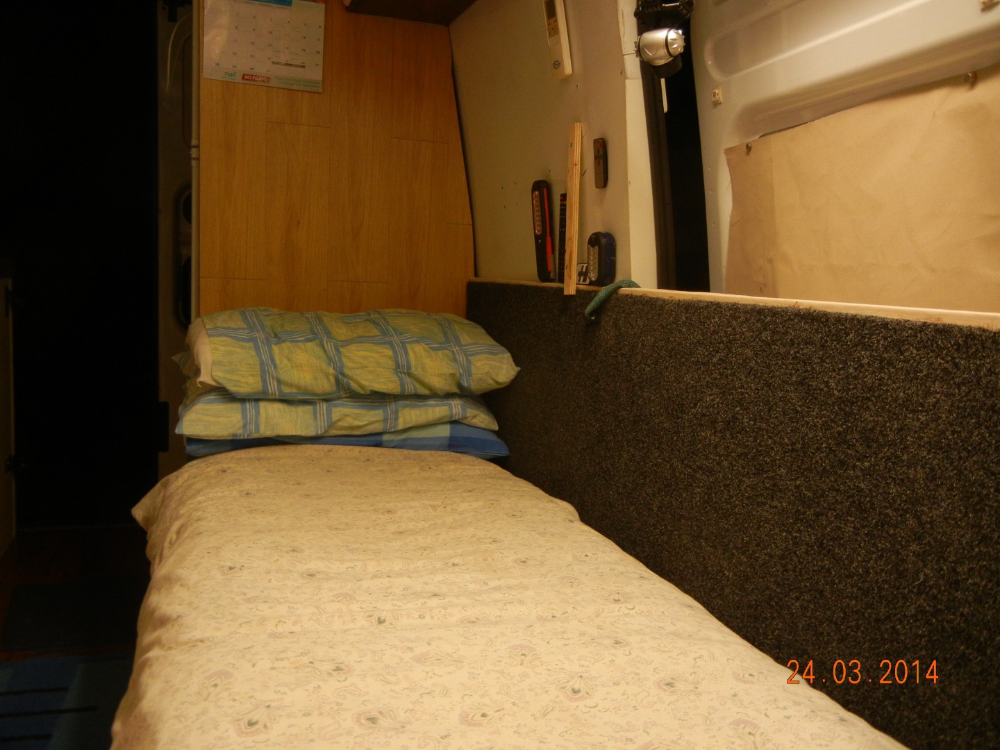

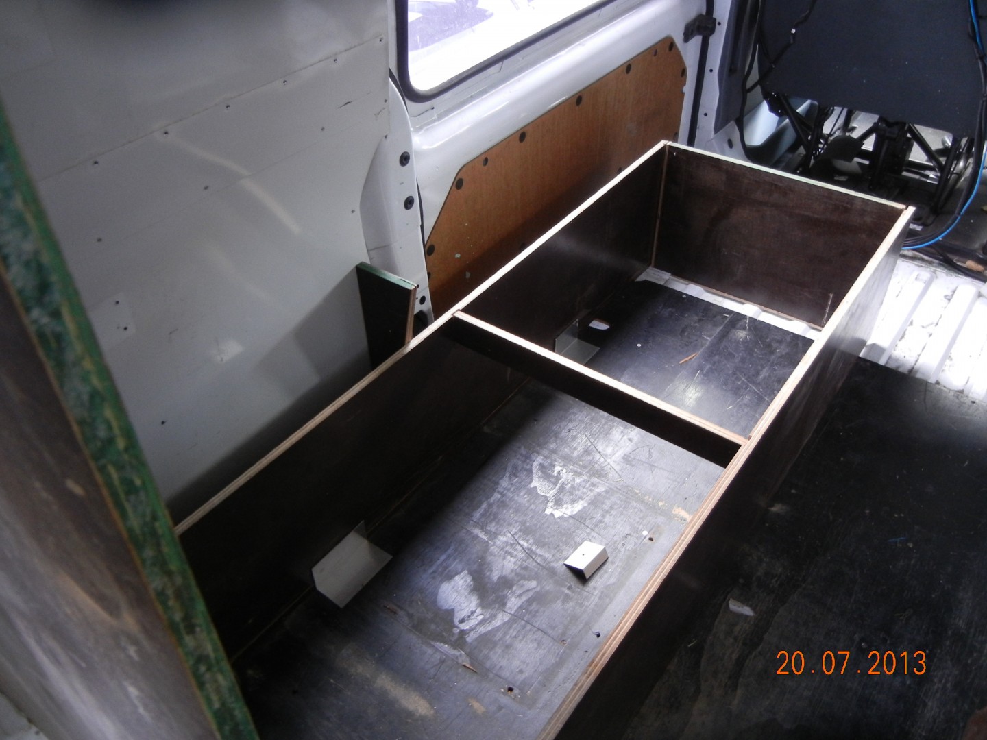

I can honestly say I've never been in a motor home or stepped into a caravan for at least 30yrs so it was all guess work and making everything around an existing bench as it had the r/c aircon in one end and the built in gas cabinet at the other, and being roughly 3m long it was a handy size to put a sink and cooktop into the stainless top (which I hated) the bench is the 4th pic as I bought it.

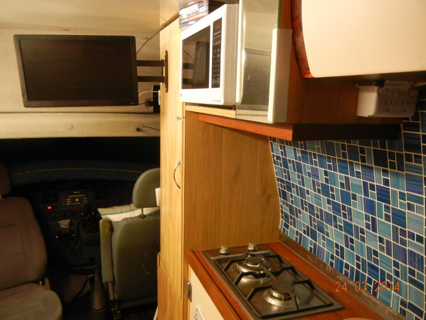

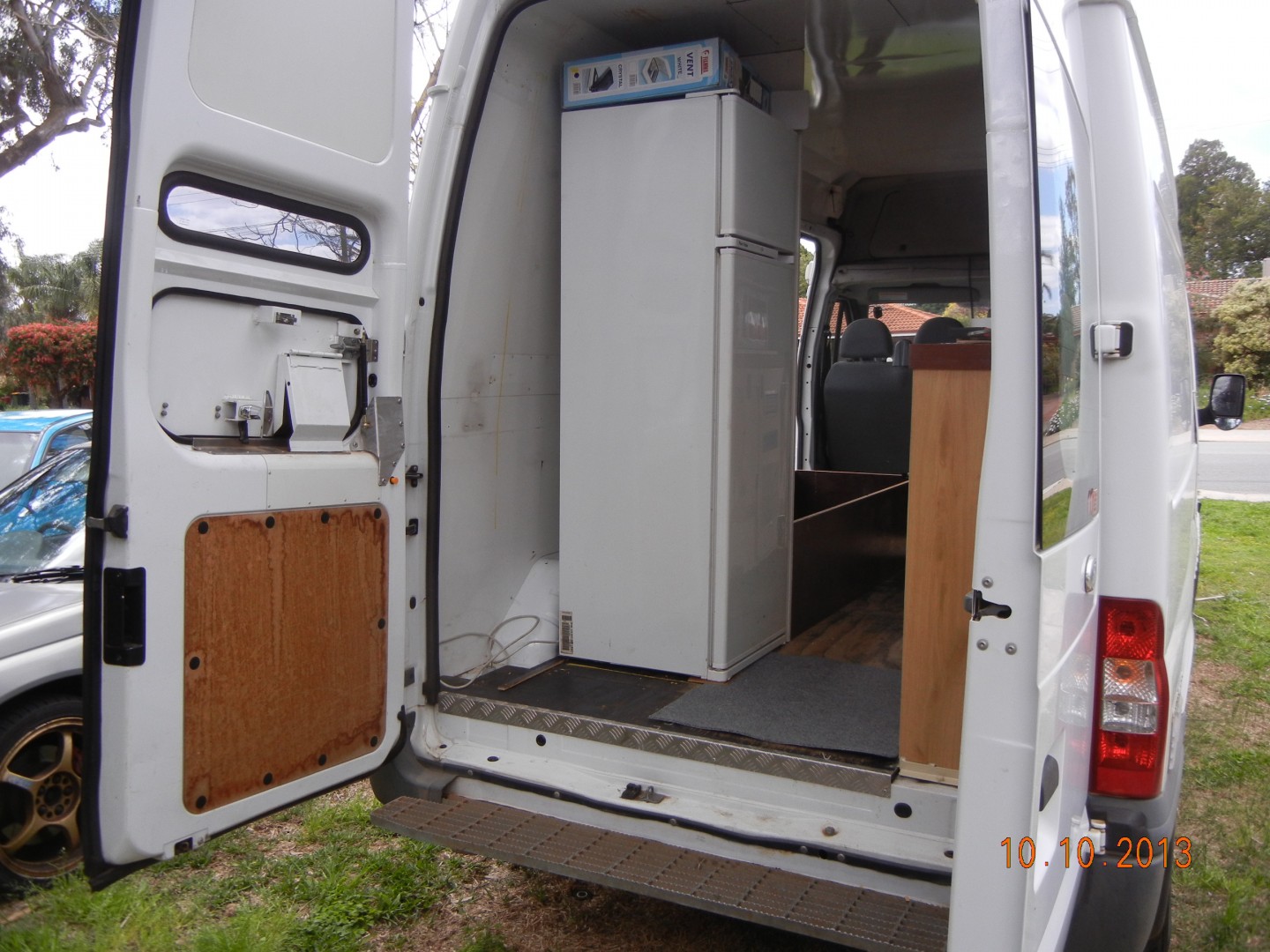

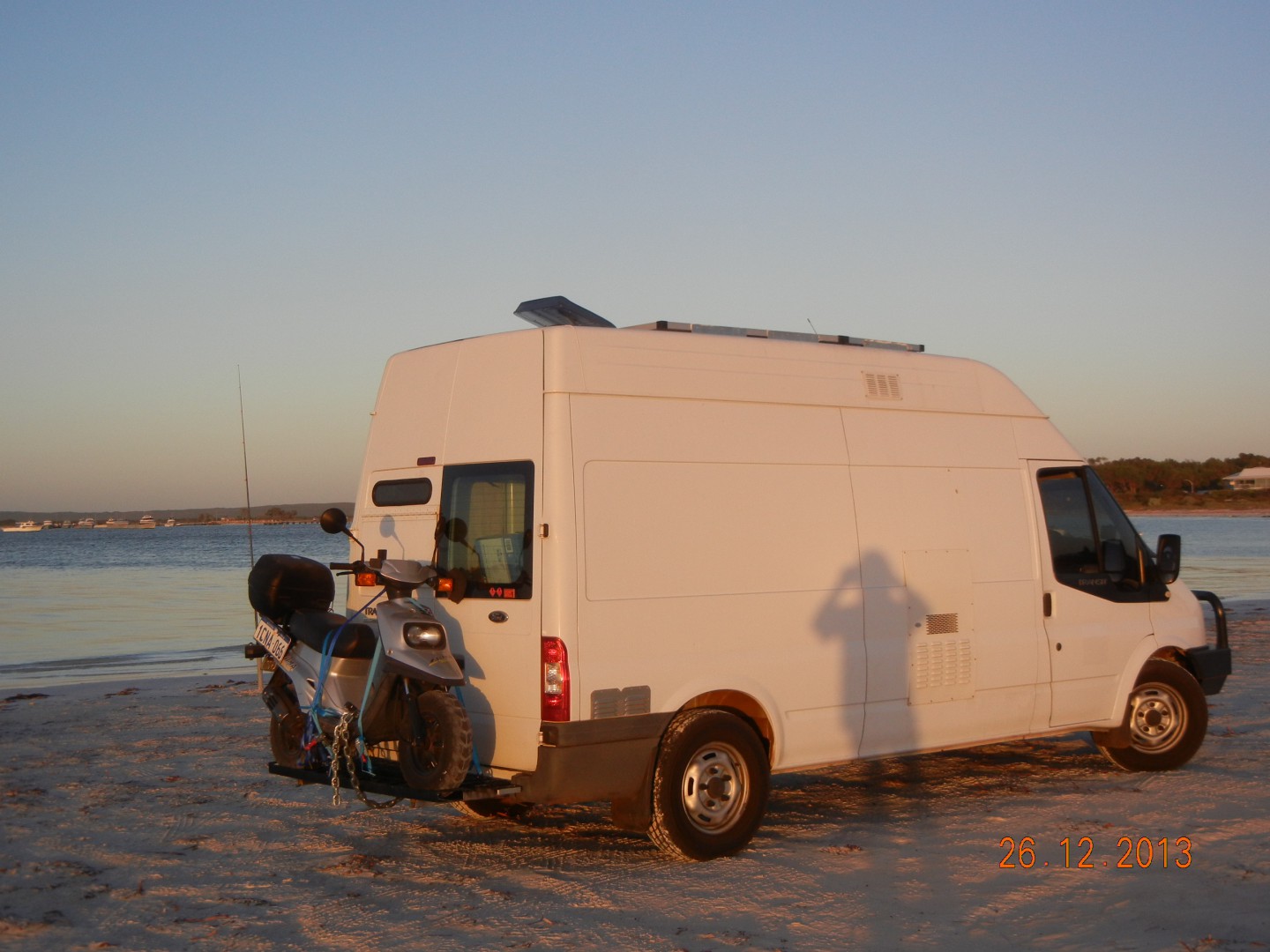

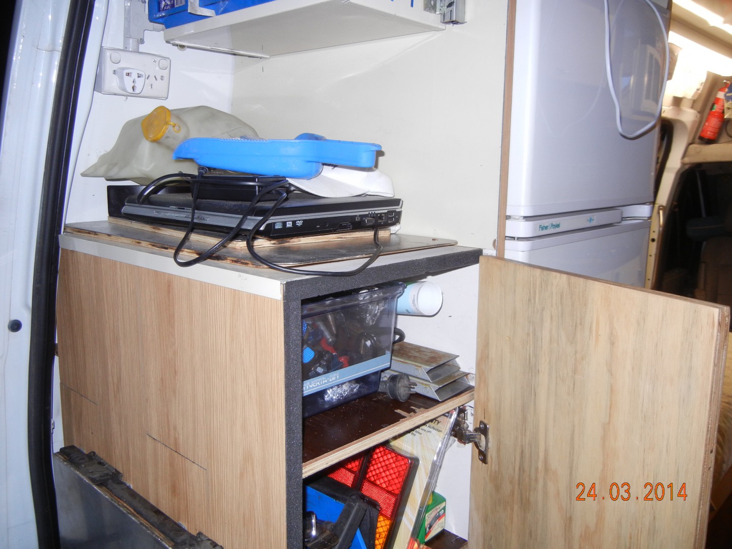

You'll notice I got rid of the double seat in front and replaced it with a Subaru Forester seat which almost matches, also got a 250L 240v fridge, 330w of solar and about the same ah of batteries, scooter rack slides out a little to become a small verandah, tiles are swimming pool tiles held on with flexible grout, cupboards and bed base covered in cream vinyl, bench and floor covered in fake jarrah surrounded by real jarrah, all the framework is 18mm construction ply (4 sheets for $100)

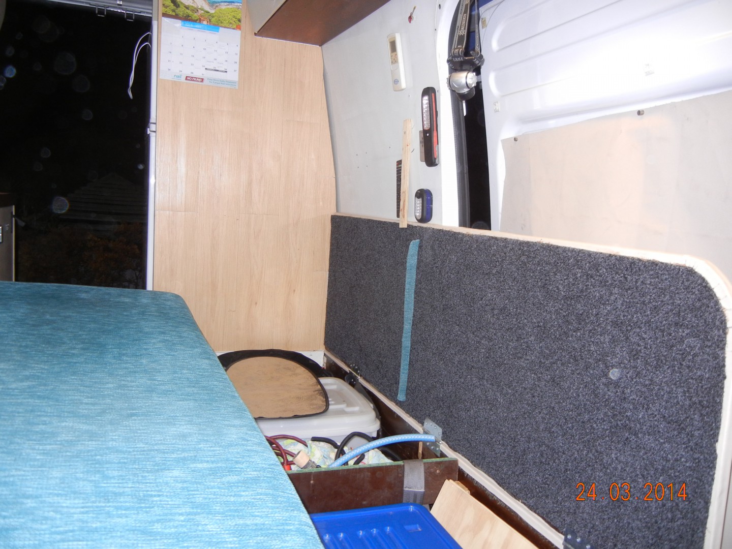

Fresh water I have 82L under the van and 7x20L bags if needed under the bed, also carry enough tools to re-build an entire car, even have a small arc welder, 2kva generator, 2 portable dunnys, I recently did a 5 week trip and realised I had way too much so managed to make a bit of room.
I think one of the best things I thought of was the windscreen cover, keeps an incredible amount of heat out, I also found covering the sky light with alfoil made a massive difference.

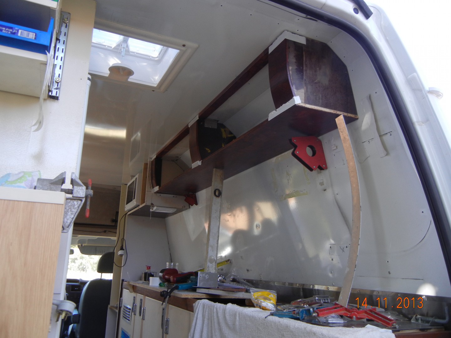

When I had mine (posting as Duh then) I was thinking of adding overhead cupboards and shelving or something inside the upper rear door recess, but never got around to it. Mine was a home made job also, but not done by me. See;

Good to see you didn't fill yours with extra windows, so much harder to keep cool, the insulation in this thing is brilliant and the company who did the initial Telstra build did a great job.
The only help I had was a little with cutting the 18mm ply as it was heavy and wiring up the 240v to the 13 power outlets.

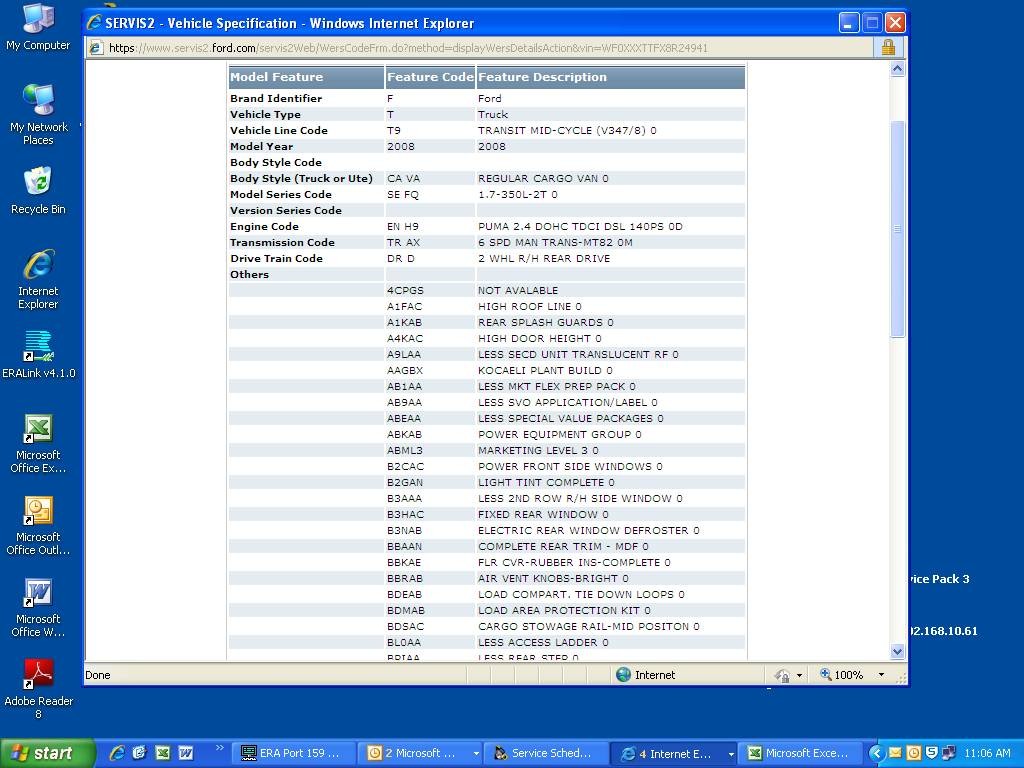

Sorry TT, you are right, it was 2.4, not 2.7 (see specs pic).
