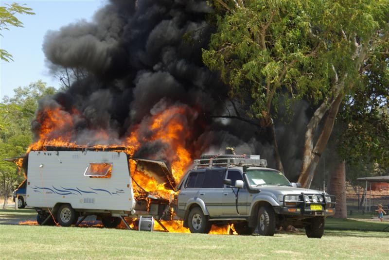

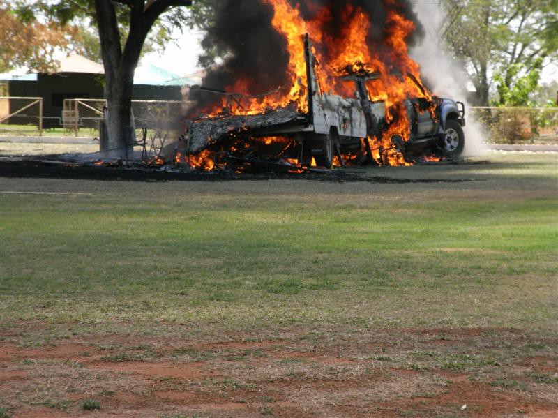

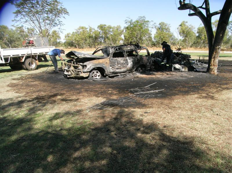

Here are some shots from another explosion at Banka Banks Station some years ago caused by fuel vapour from a jerry can that had been opened (pressure built up inside) and it was ignited by the pilot light of a gas fridge under the annex. The owner was going to fill up a generator. Both he and his wife were severely burned, luckily their kids were out playing. Photo's taken by the manager at the time.
