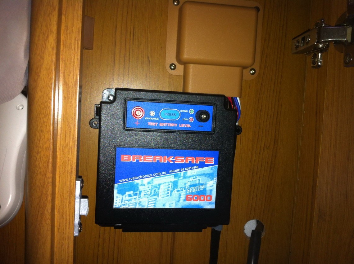

aussie_paul said
05:26 PM Jul 8, 2014
How big is the break away battery as I have not found it yet? Today my 120w portable solar panels arrived. So to test it I connected it to the brake away Panel that has red and black inputs. The battery was showing almost flat and the solar charged it up.
So I a not sure yet what actually charges the brakeaway battery. I will ask tomorrow when I will be talking to Jayco tomorrow to see if the rear right mould is on its way so we can get the damage fixed and the club lounge taken out.
-- Edited by aussie_paul on Tuesday 8th of July 2014 05:27:13 PM

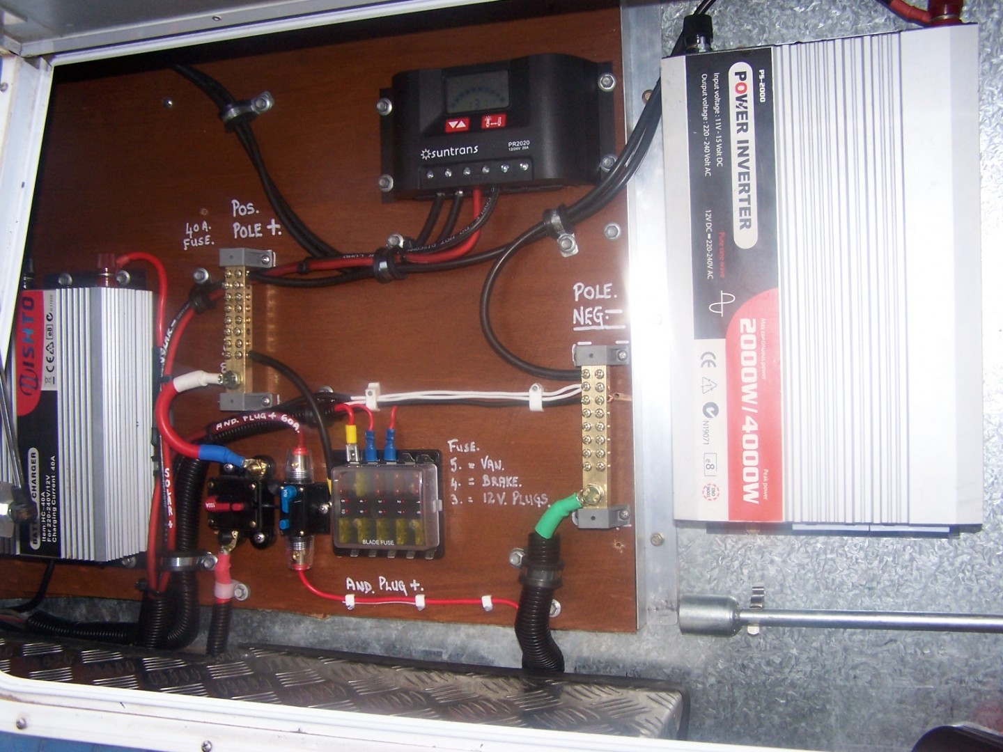

hi paul our is the same as your photo , we have ours wired directly to the main fuse board off our house batteries , so when parked it will draw a small current of the house batt and when travelling gets topped up by andrson plug feeding charge into house batts, good question , re where it is , i havent chk ours yet but am told its behind a cover on the main unit , not a really big battery , we were told to replace it periodicaly every 2 yrs , not sure if this is correct , we re wired our van s main pwr area and made sure it ran thru a dedicated fused line to the main pwr feed , hope this helps
I've got a 2011 crusader manhattan. I had to replace the breakaway battery last year. The battery is enclosed in its own box hidden somewhere in the van. Mine is in a cupboard. The how to book recommends that the battery should be replaced every two years regardless how it tests. The most common battery is a 7 AH unit with slide on cable connectors. It cost me about $45 from a battery dealer in Mareeba north qld. Hope this post helps. OF/GN.
