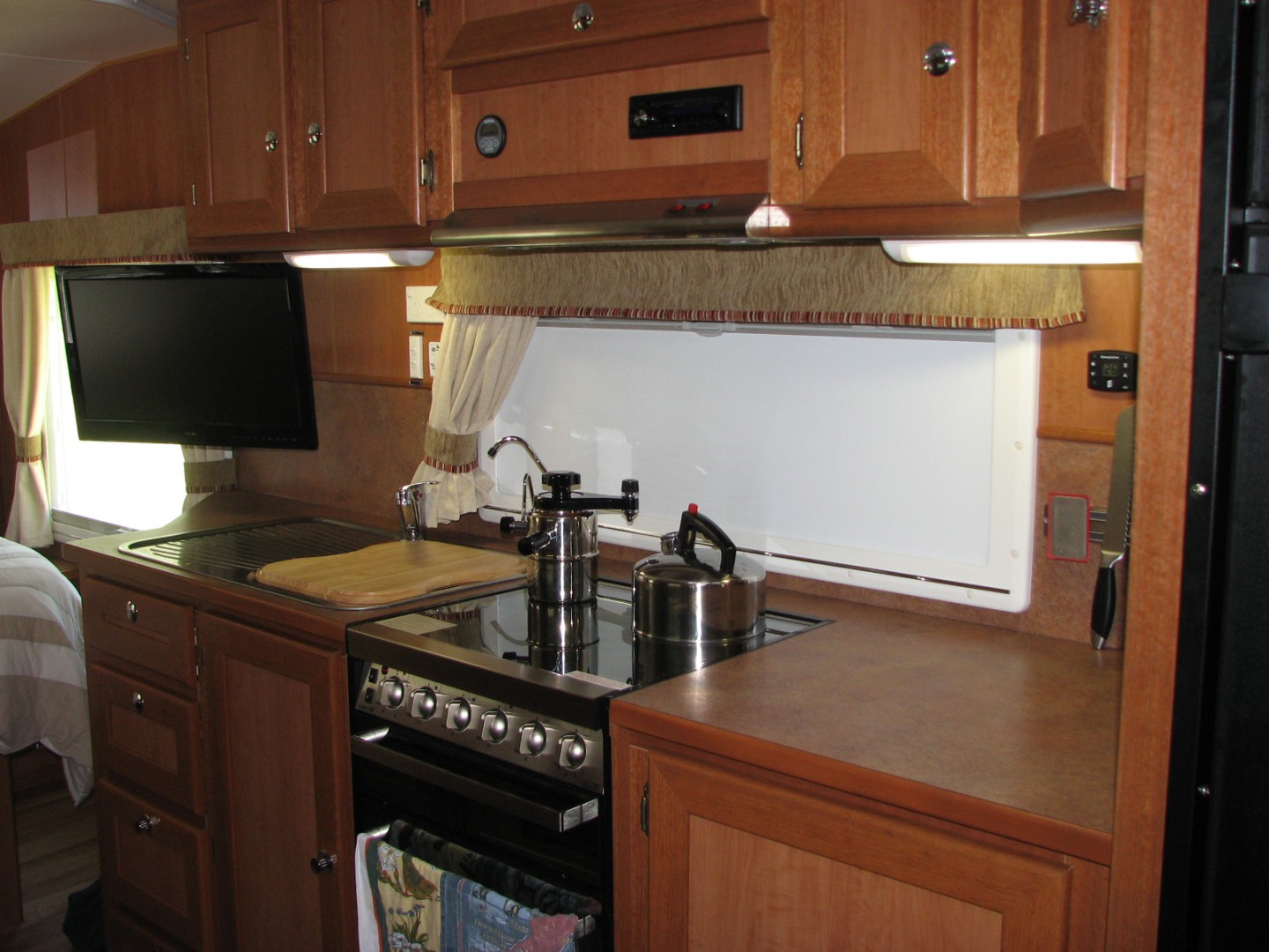

this my Bellman coffee machine, makes espresso for three, six or nine cups. Also steams/froths the milk for cappuccino. Can be used on gas flame, on open fire, or electric hot plate. I only use on gas flame. Solves my coffee fixation.
-- Edited by Dunmowin on Monday 7th of July 2014 05:10:31 PM
Dunmowin, I picked up one exactly the same except it's branded Breville and is attached to an electric base, from a garage sale for $5.00 a few years ago.. it's very old looking but still works quite well. Maybe I can separate mine from the base and use it on flame too.
Dunmowin said
09:40 PM Jul 7, 2014
Here is the end product,not the buns, just the coffee, the buns came out of our bread machine...
Thanks guys, Im up for one of those coffee machines.
Safe travels

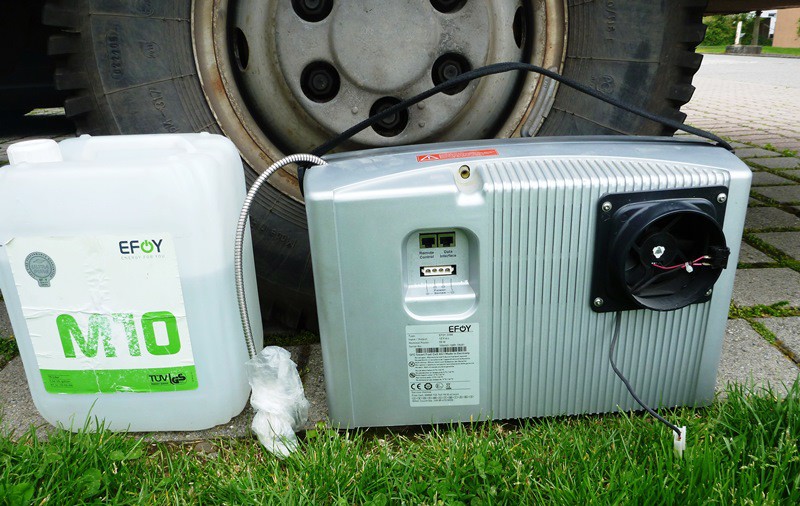

We have one of these in our MH in Europe.
Bought it second hand to cover the odd occasion when Scotland delivers several days of zero sun in a row, even in summer (just had one....).

http://www.efoy-comfort.com/technical-data
It is installed INSIDE the MH, weighs under 8kg, delivers 7.6A of automatic 12V battery charging and makes about the same noise as a compressor fridge.
One of the future directions of mobile electric power.
