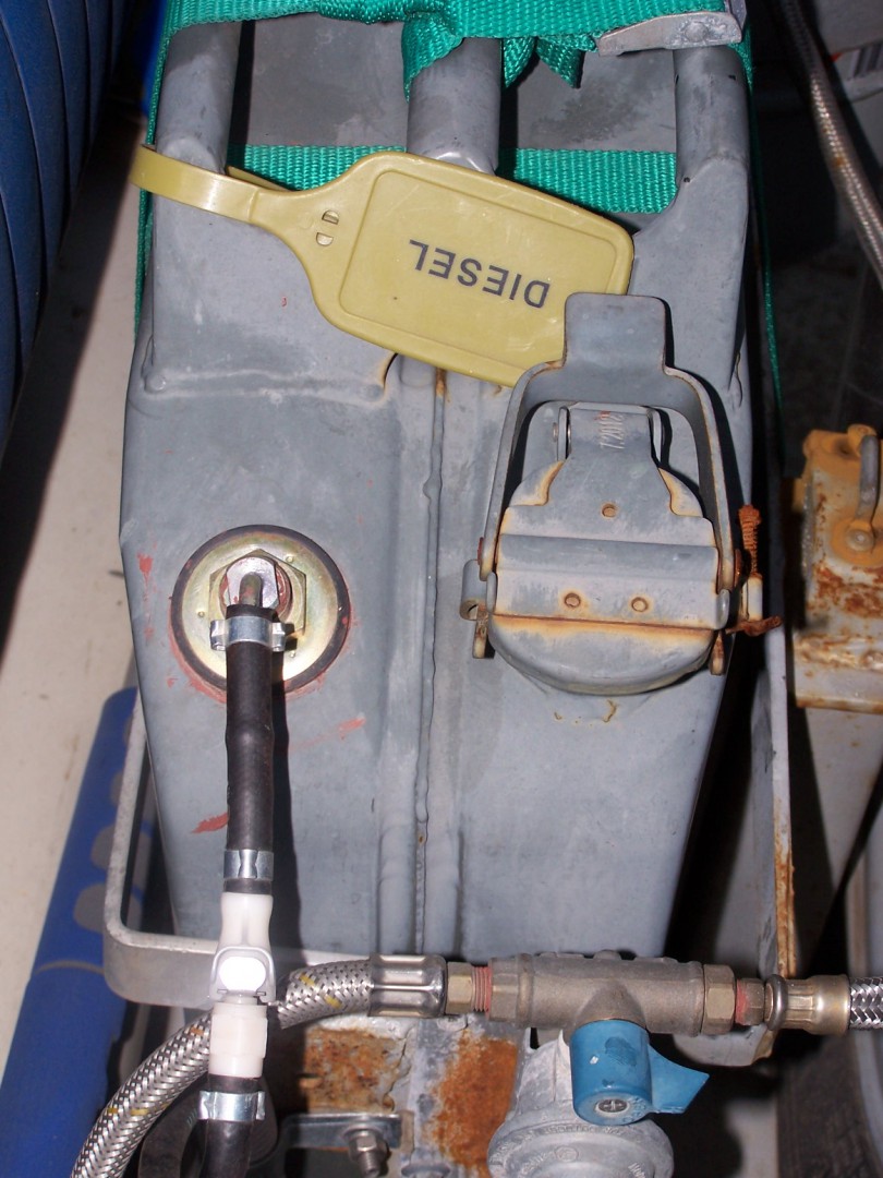

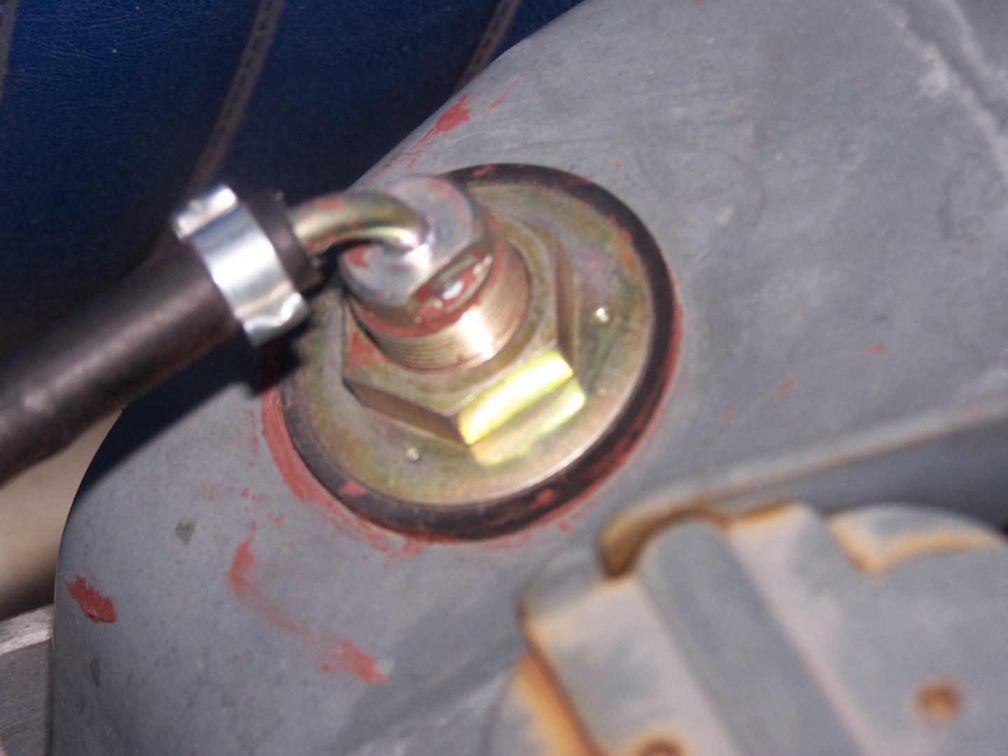

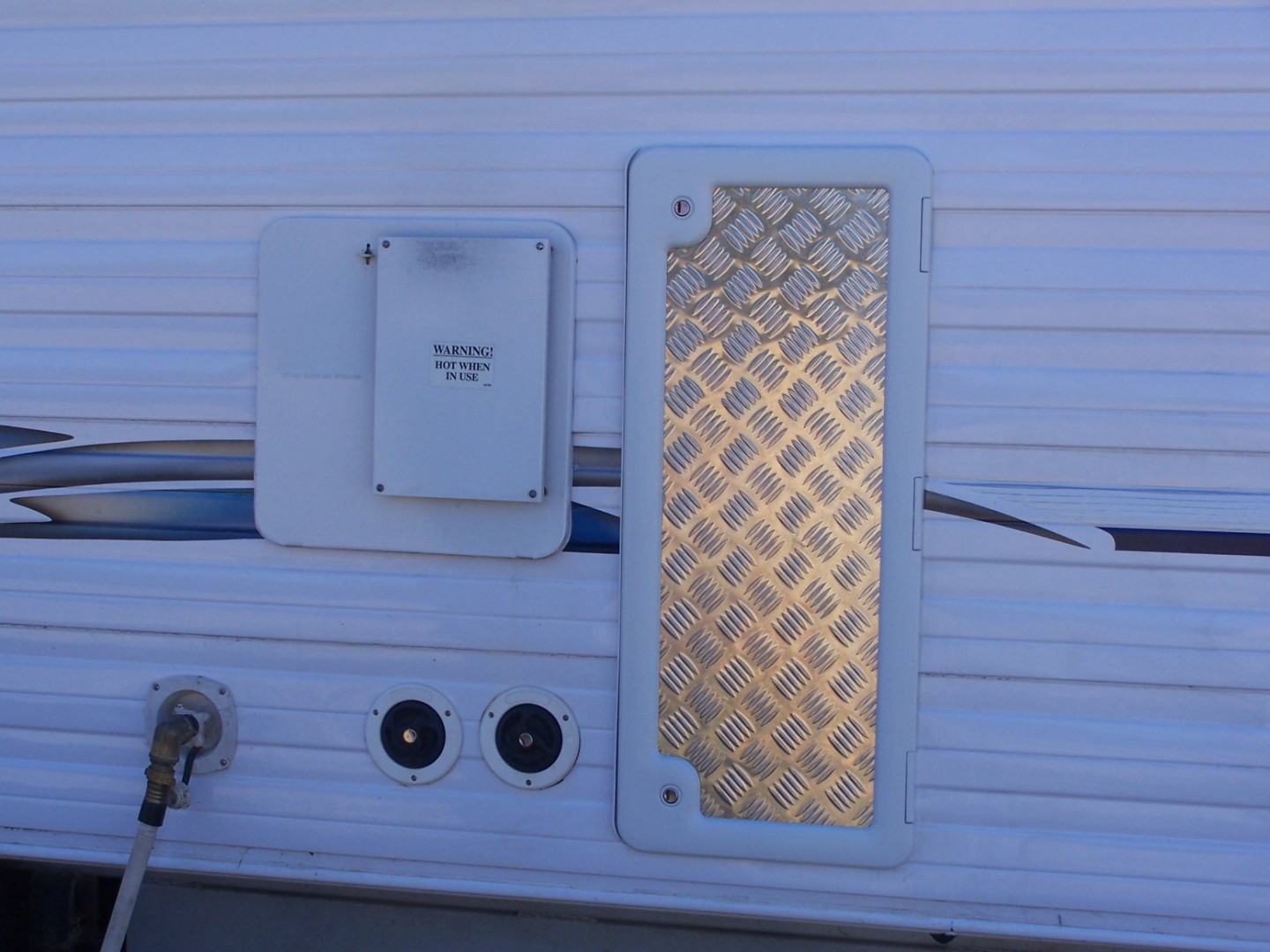

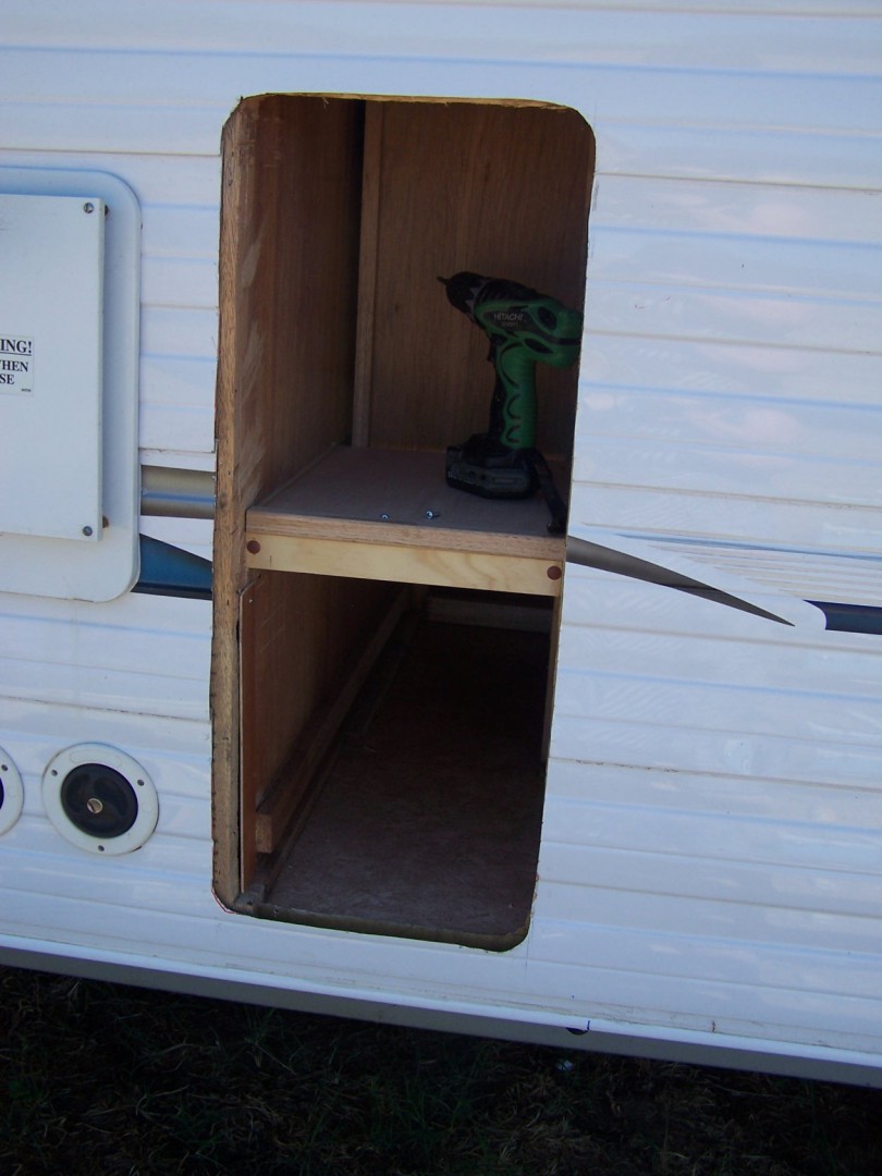

hi paul , good planning is the key , dont rush it , we took few days to come up with our possy, we were lucky as we cut a access door into the side of van where there was a hidden waste of space because of the kitchen l shaped benchs , we were planning under the bed and ducting towards the front living area , it really depends a lot too on what type of heater you purchase and the length of wiring harness , we basically worked ours just right to accomodate the lenght of the 3 harness needed to connect everything , basically everything is plug and play , ie plug it into the correct place and away it will go , hook up power via fused protected circuit and your off , your question too regards air etc , the air to mix with diesel comes via a small intke hose under the floor , the fuel via a hose via your pump via your fuel tank reservoir , the exhaust , try to make it past any windows or extend it to the rear , you can extend it quite easily , make sure you use a muffler too, the air intake is one end of the main unit , cold air in hot air out the other ducted to wherever you decide , our heater is a snugger , excellent value for money , its ticking away as i type this at 22. c , just nice , one tip another nomad put me onto was , if under bed or under a seat is the go , dont connect a cold air duct but use the cavity as your air intake area , put the grill mesh cover on the end of the unit and use a small house type air vent to access air from the rest of the cabin into the designated area for fitting the unit , this avoids a lot of noise from the ducting ie no ressinance from the duct against the floor or any structure , fuel line wont probally be enough but a tip to repco etc and a few more metres will get you there , snugger is good set up too for fuel reservoir too as you get a break away coupling , to stop air getting into the system like a outboard motor fuel tank and a pick up tube , if you would like some pics of how ours is set up , let me know happy to send you some wondering too did you have success with recliners ? here is a pic of our jerry can , and our new access door to access the heater and fuel pick up into it , great and easy to fill , not that you have too fil it often good luck graeme
good luck graeme
