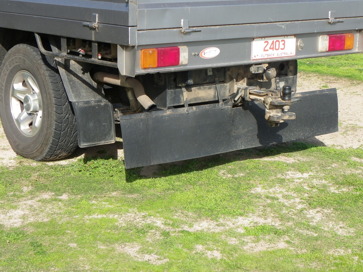

Baz421 said
01:11 PM Jun 26, 2014
OK I have Firestone bags on rear of Landcruiser ute,,, they can be pumped up to max of 90psi if I recall.
What you could try is to -
1 let air down to 5psi (the minimum)
2 put a marker next to bus body ie block of wood or measure with tape measure to ground
3 note the position of the rear spring hanger (see the LH side of mine in the attached photo - that's the correct position of the hanger)
4 put say 30psi in and measure the rise in body height AND position of spring hanger
5 put say 50psi and measure again
6 repeat at 70 and 90psi if needed.
7 you then need to gauge the best pressure to have the spring hanger in the best location -
ie if 30 psi raises the body enough and you drive it with minimal body roll on corners and it feels firm/good use that setting. If you need 90 psi to stop excessive body roll you should consider getting your springs reset and use the bags to assist only which is what the intention is from the outset.
This is a rough guide, but if your springs are really stuffed ie they sit "flat" with hanger back a lot (in practice this may be only 30-40mm further when the airbag is NOT taking the load) you need to get them reset,,, and this is often the most economical to do.
Could also think about a sway bar if there isn't one fitted to the rear..
Keeps ride and stable on corners..

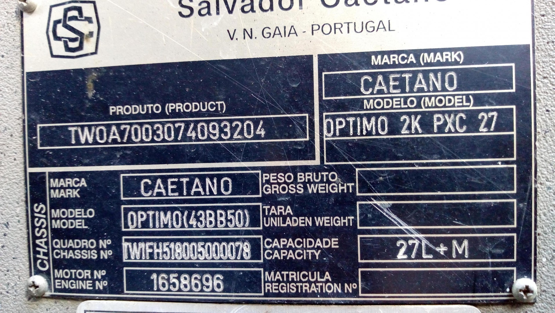

jlmor said
08:38 PM Mar 20, 2018
Thanks for the hints Jaan.
In effect, found the said plates crimped to one of the entry stair steps, see image attached. It carries manufacturer's data (product#, chassis# and motor#) but I could not check to which Dyna type/model it is equivalent.
From licensing papers the front and rear axles loads are 2600 and 4300Kg, maximum allowed load is 6800Kg and net weight is 4400Kg. Also, distance between axles is 3935mm, and Toyota's type/model papers indicate the bus to have the following 'Toyota codes': Model BB50 (the Portuguese vendor called it 43BB50), Motor 15B-FT, and transmission M-155. That's all I could gather...
Does it help to spot to which Dyna it is equivalent, and then to define air suspension kit I need?
Thanks for any feedback from the community :)

We learn something new every day I looked at Wikipedia and found this there with the other information;
The chassis of the Toyota Coaster was also used on the Salvador Caetano Optimo and sold in Western Europe. In the listing of various models; BB50, 15B-FTE 4-cyl Turbo Intercooled engine (2003-2006) 6sp. manual or auto.
So the BB50 is a genuine Coaster model chassis not a Dyna. It is not a model normally sold here but is sold in other countries. It is a long wheelbase with the 4 cyl motor and is rated for a heavier maximum load than our models. However the rear axle and suspension will be similar in all the models.
My suggestion is to use the information you have to enquire with suppliers and see what you get offered. I hope this helps
Jaahn
PS Toyota uses common parts for all their models when they suit. So the Coasters and the Dynas of similar weight carrying capacity have similar axles and springs anyway, as well as engines, transmissions etc. Caetano also made Dyna trucks and sold them in Europe too. BU100, BU200 ??
-- Edited by jlmor on Wednesday 21st of March 2018 01:22:43 AM
