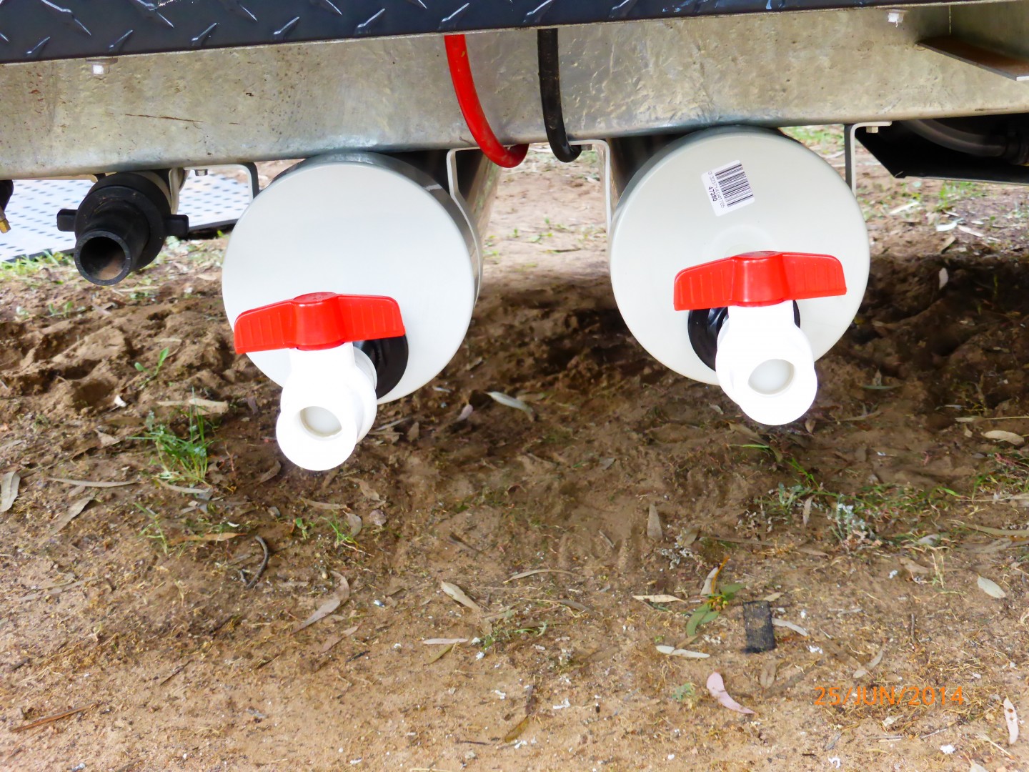

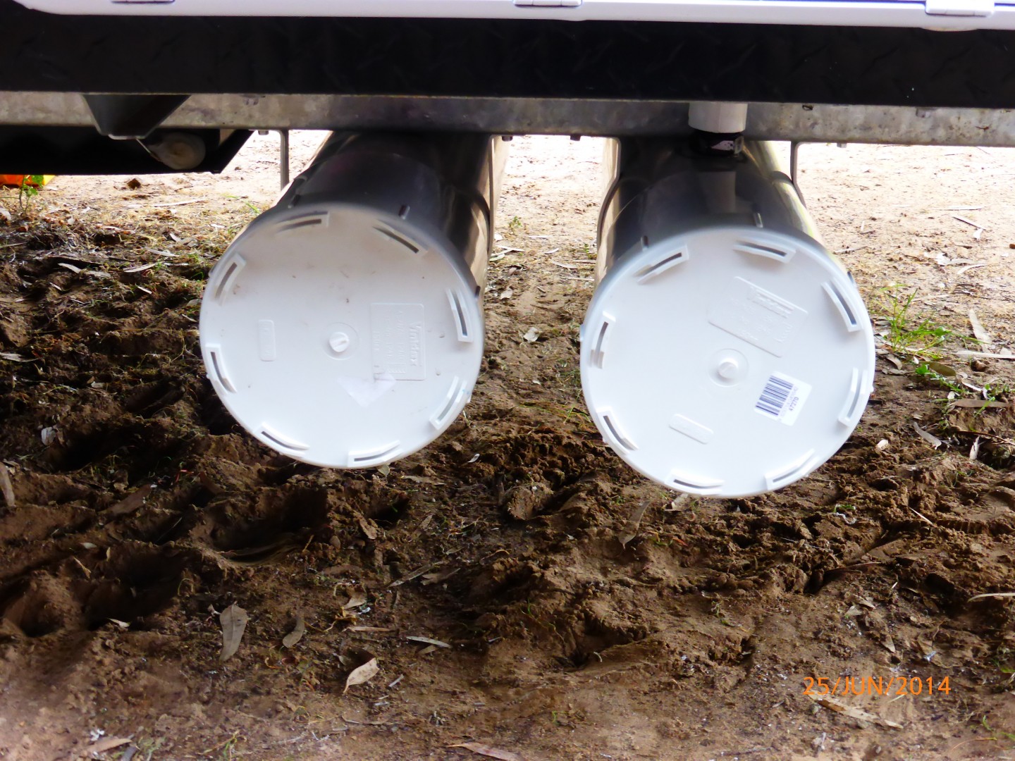

The issue of grey water comes up in this forum and others on a regular basis and has been concerning us for some time.A recent picture of a set up in the Caravan & Motor Home (Edition 203) gave me something to think about. After a couple of visits to the local plumbers, Plumbtec in Mildura, we have come up with the following.
1) PVC (sewer strength) 150ml x 1.85m plumbed into the kitchen sink and vanity. 2) PVC (sewer strength) 150ml x 1.85m plumbed into the shower only.
The tap end is fixed but the other end has a screw on cap to facilitate cleaning out with a hose. Each unit has a capacity of approx 32 litres.
Cost $230.
May help someone who has similar concerns with the issue of disposing of grey water and the need to be "self-contained".

Nomad, sorry but can I ask, do you store the water in those two pipes??

I've been looking hard at this system Doug. I don't have grey water tanks and can't fit one (40 liters) under my Iveco. JohnR states the pipes hold approx. 32 liters grey water. I think I can install this system and step up capacity to 40 liters. Yes the grey water is stored in the pipes until you release or empty them. I think it's a great idea.
If in a Caravan Park that has grey water drains, simply run your hose from one of the taps to the drain. In areas where you must hold the grey water, open the taps at a convenient location later or a hose from one tap to a Dump Point.

Seen it done like that on the jayco expanda website. Need to put a breather in. They had a tee at one end with the outlet in that so there was no way to break the valve off.

Yes, (pipes) are sewer grade PVC the first outlet covers kitchen sink & wash basin.The second pipe outlet covers the shower.
JohnR said
09:45 PM Jun 26, 2014
My first attempt was utilizing 100ml x 1.75m sewer PVC.My good lady and son did the numbers that showed the holding capacity would only be 13 litres??? A quick mathematical calculation from both the better half and son resulted in moving the goal posts to 2 x 150ml x 1.85m piping to achieve 2/31litres holding. (Total 62 litres)

I've decided to go ahead and install this system on my Iveco MH John. I think it's very simple and it will work. There will be a few minor variations, one will be to put a breather in one of the pipes, also a TEE in each pipe and join them together. My reasoning here is that the pipe accommodating the shower water will fill up before the second pipe servicing the sink and wash basin. By joining the pipes together, the grey water can be more evenly distributed.

A breather is definitely required - ours became blocked and water wouldn't flow into the tank because of the air lock. The other thing needed are non-return valves on each of the source points or at a minimum on the inlet to the storage tanks - stops the odour coming into the RV.

The basic idea seems to us to be superb. I am working on a system for our van and at present have adopted an old plastic 20L jerry can which had been damaged and is currently modified to be used as a container we can dump our GW into and then seal it to take to a dump point. 20L will just make it for two days to contain all our GW (that is shower, hand basin and kitchen sink.)
The need for a breather is seen, but what about some internal baffling to prevent surging / slopping movement of 20 - 30 Litres (that is 20 - 30 kilograms mass) and possible effects on driving?
JohnR said
06:05 PM Jul 5, 2014
Mobi Condo
Yes, breather holes have been placed in close proximity to the entry inlets etc. The weight in water is transferred from the fresh water tanks to the grey water holding pipes.However there is no great klms travelled while holding grey water. Last week we were at Murray Bridge that had showgrounds and allowed FULLY SELF CONTAINED RVs only. At the railway station there was a Public Dump Point about 6/7klm away. Powered site cost (electricity only) $10pn. Situation from what I am being told is that National Parks/Metro areas are forcing a policy of "Leave NO Trace". Already paying dividends.
Cost $230.
Mobi Condo
