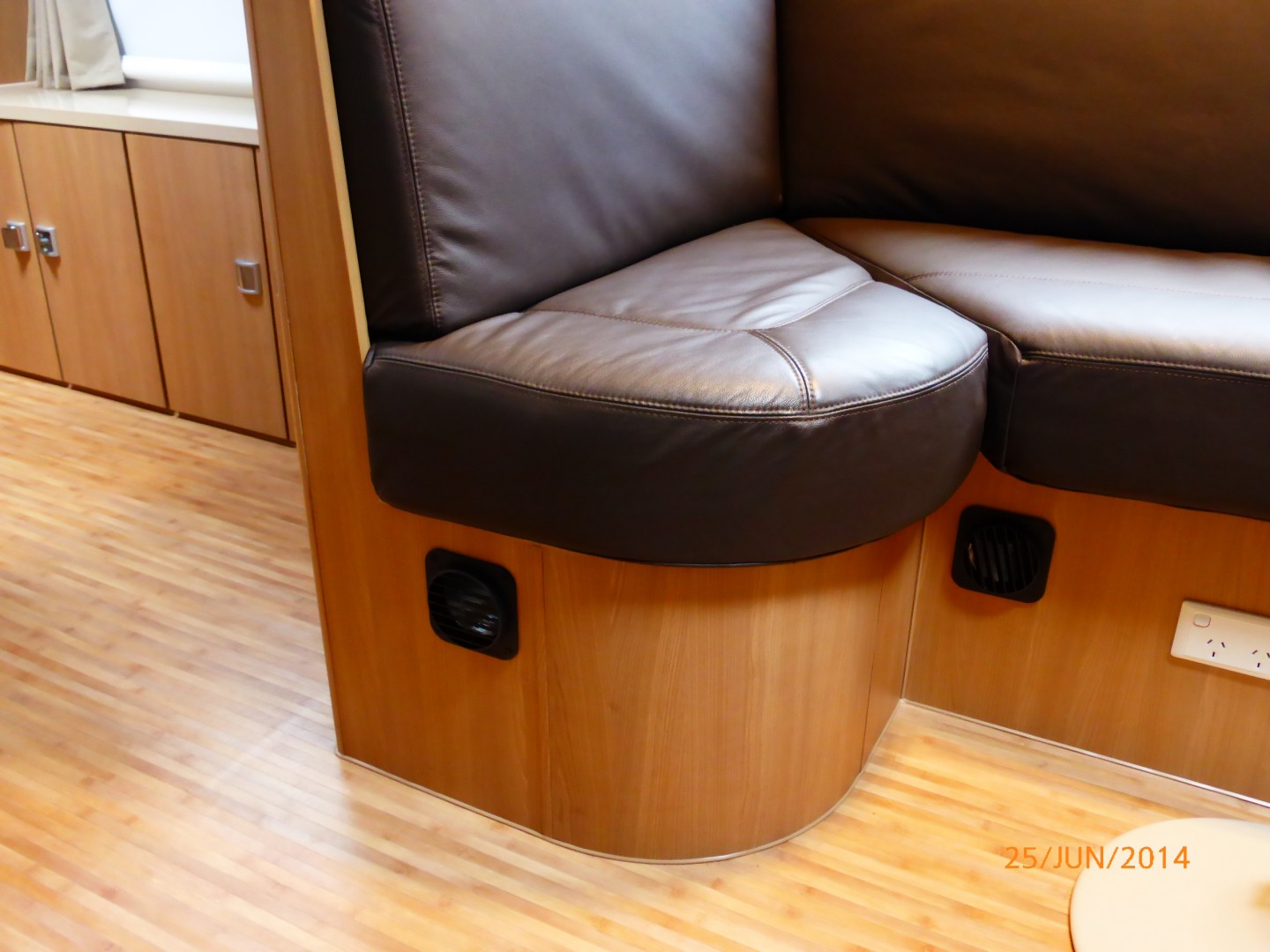

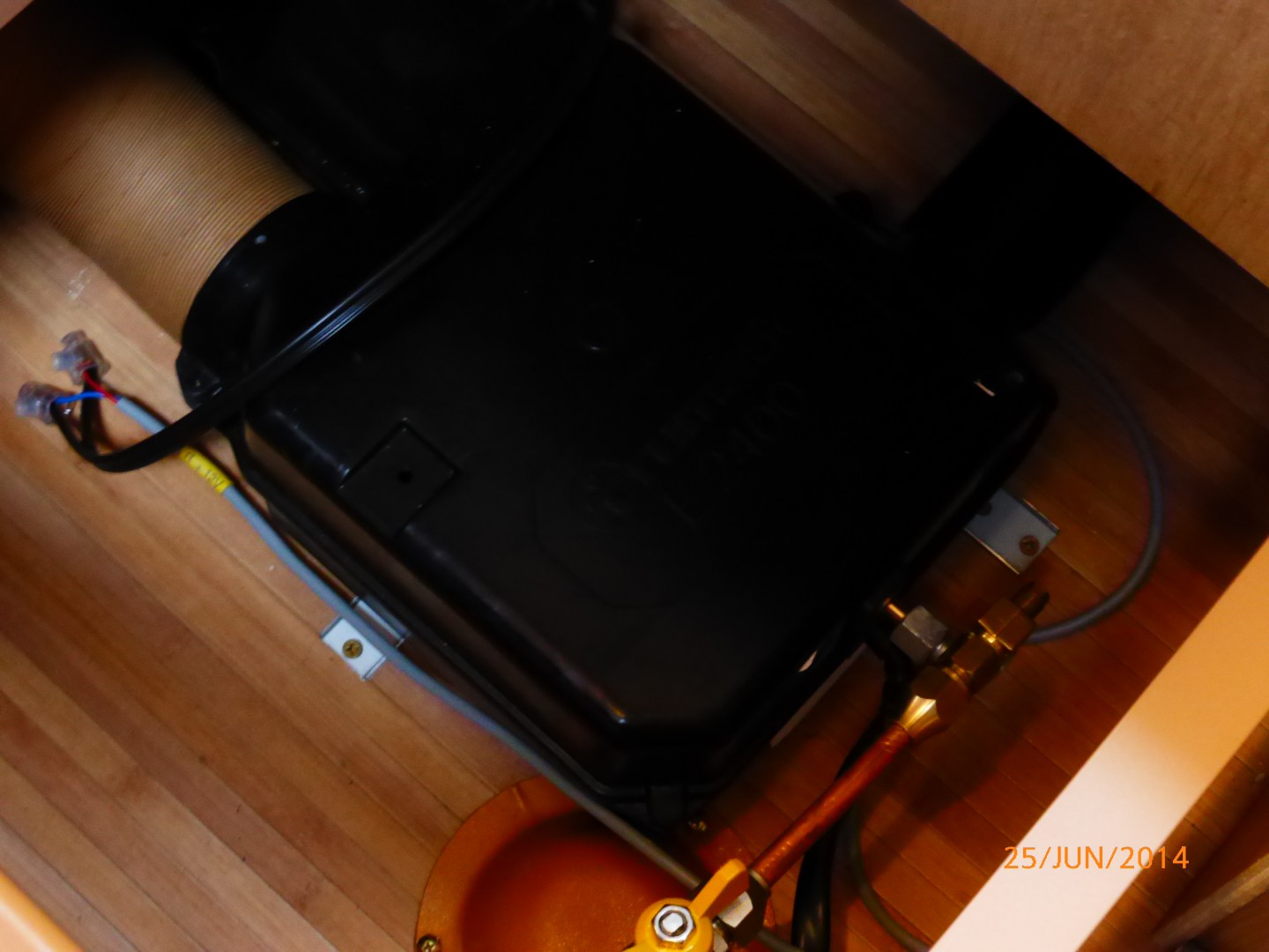

Gas heater installation now complete and certified under NSW regulations.Runs on about 3 to heat the van. Needed to have flue positioned below a window and consequently required window switch that kills the heater should the window in question be opened. Costing as follows Unit $1,500, Window Switch $89, gas fitter/certification $350-. For information and anyone considering installing gas heating.
