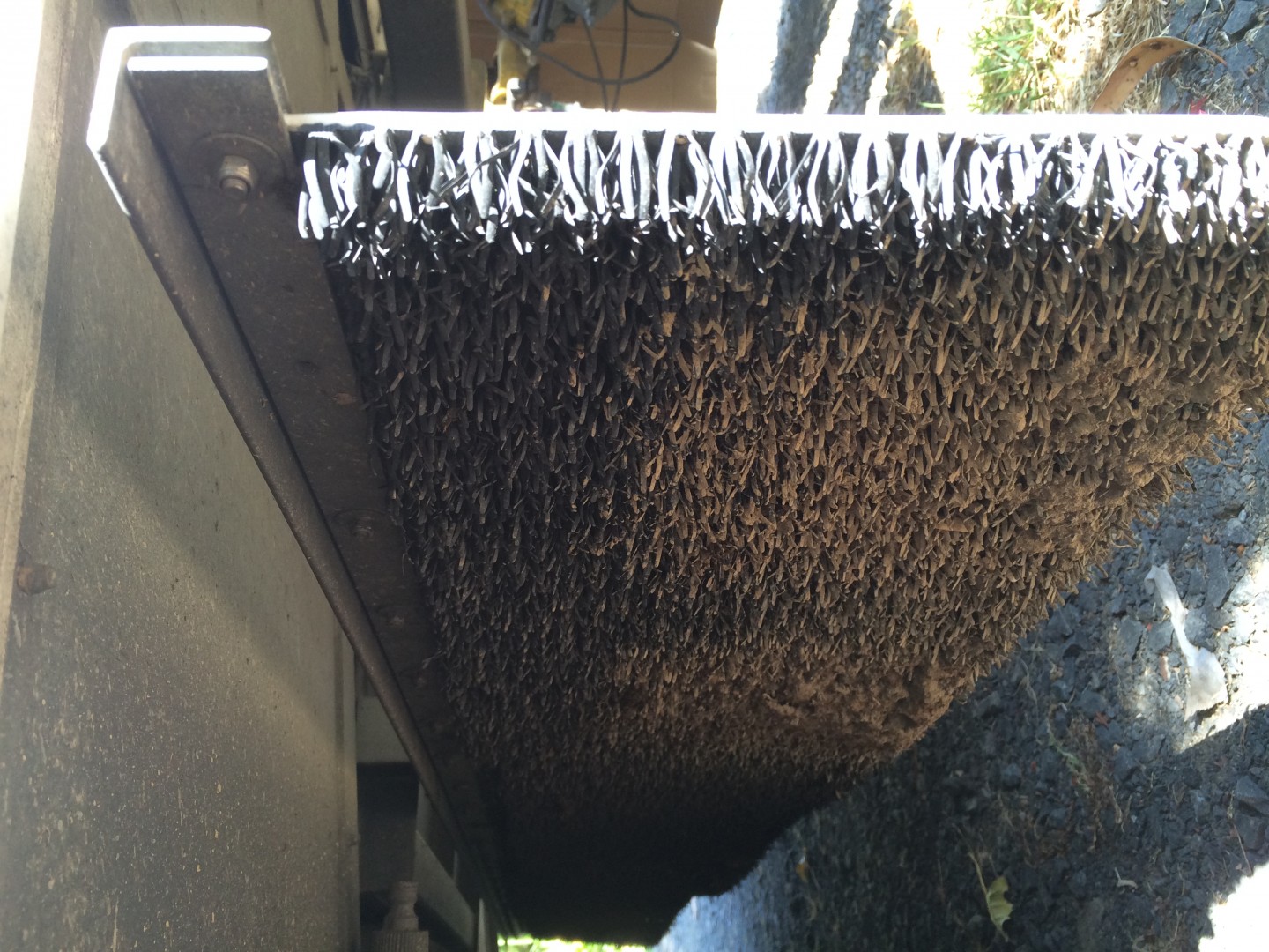

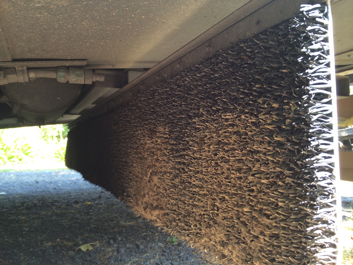

Don't have a cheap solution but I have the best solution. Just travelled to Cairns and back "mucho roadworks" towing my Grand Vitara. Spent days cleaning the tar etc off the motorhome but not a mark on the towed vehicle. The solution is the Stone Stomper.
www.stonestomper.com.au/
