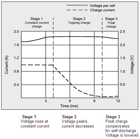

Lead Acid batteries Have a recommended min Draw on the Batteries of 50% SOC [ State of Charge ] - When charging the batteries the general rule of thumb is 50% - 80% SOC the batteries will take everything you can throw at the batteries.. ie Amp's.. - Once the regulator Registers that the batteries have reached 80%SOC [Which is a set minimum voltage] the charging drop's down in Amps and is pulsed..
So basically 80% SOC the batteries will only take a trickle charge till they are Full.. or close to Full..
The above chart is what you would see in the individual cells of the 12v Battery.. you need 6 of these to make up a 12v battery..
