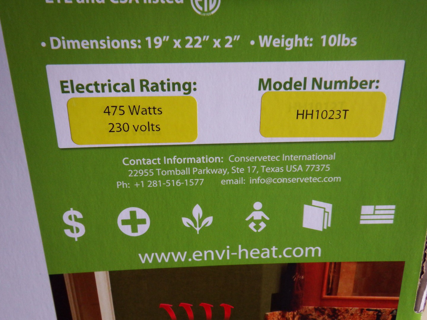

We purchased a "envi convection heater" on line www.envi-heat.com
Make sure you get the Australian variant for 240V

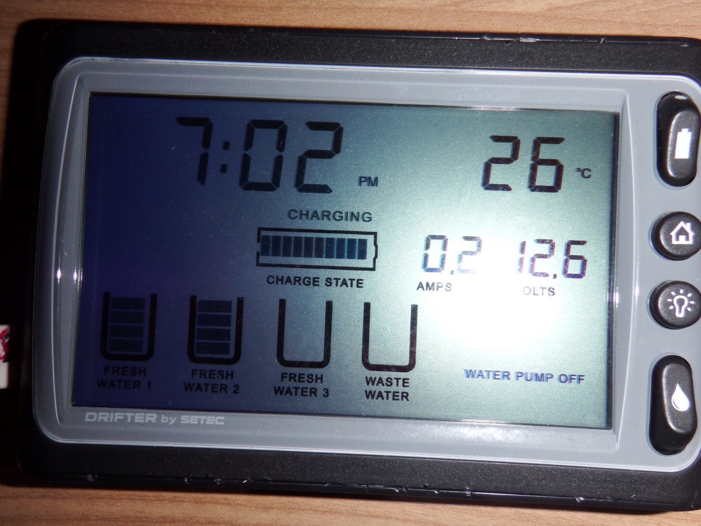

At about 7am the inverter started beeping with a low voltage. Start up charge was about 90%.

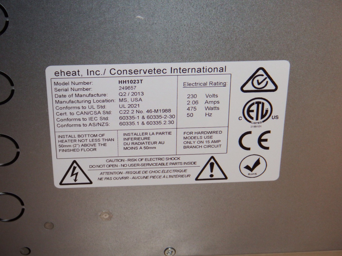

Phil C said
07:17 PM Jun 22, 2014
Hi All
here is the approval plate. Please note the current is worked at 230V not 240V

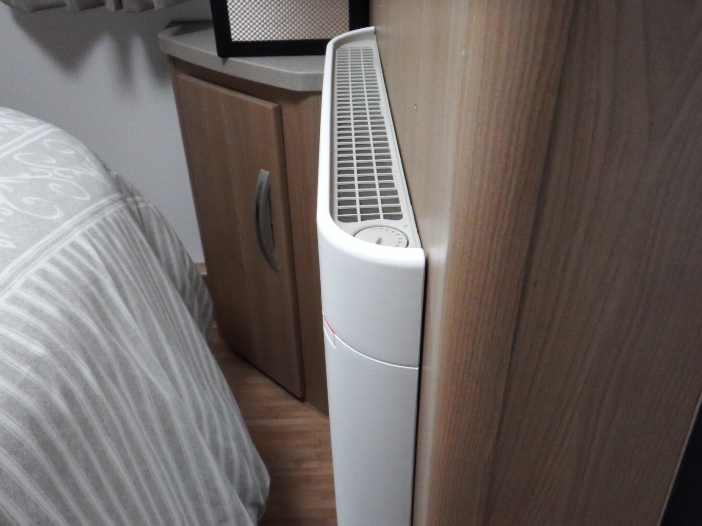

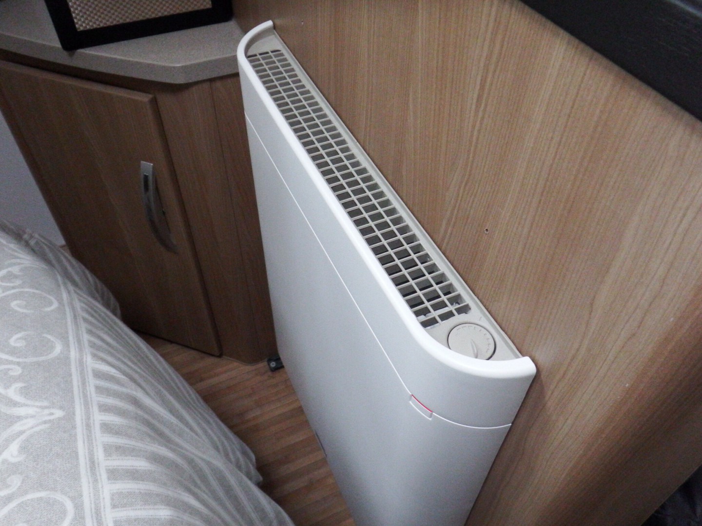

One of the big issues we face is heating the van during cold nights on batteries. I found the solution!
This heater ticks all the boxes, being only 475W it works well with an inverter and doesnt flatten our two 110AH house batteries over night. Also IT WORKS! Keeps our van at 22 degrees all night. Oh its dead easy to install.
Pic shows our installation at the end of our bed.

OK I now see where Peter Q is mixed. P equals I x V therefore I = P on V 475 dived 240 = 1.9A AC.
-- Edited by Phil C on Sunday 22nd of June 2014 07:27:48 PM

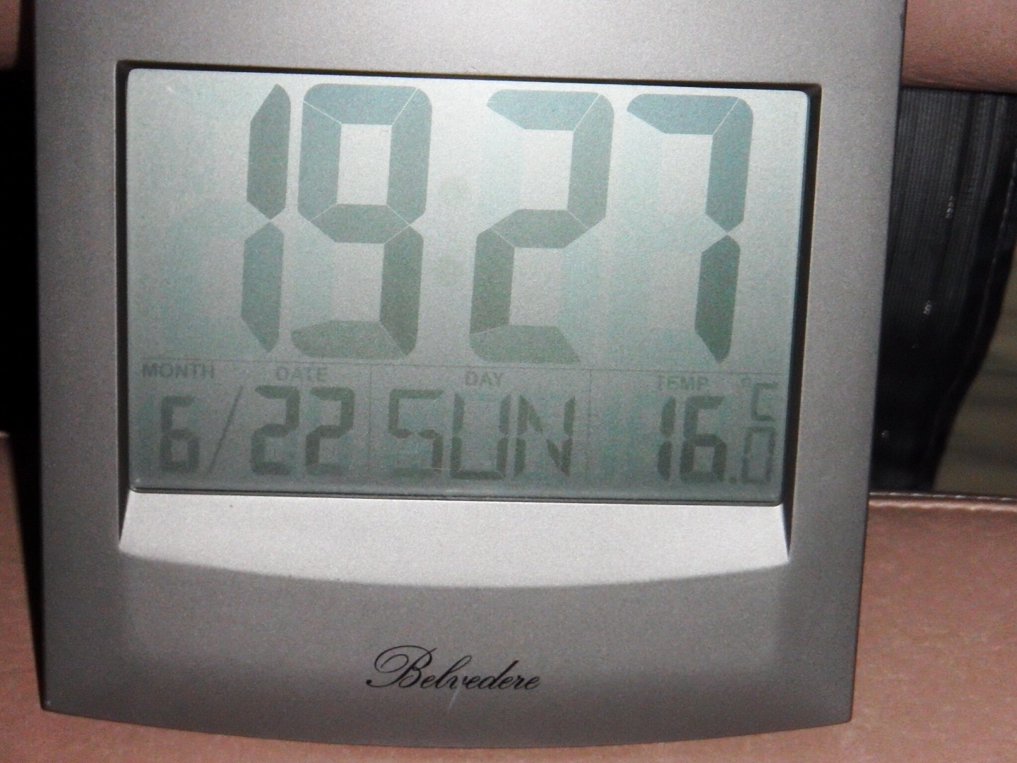

Two photos of inside and outside our van. This heater works and Im not on commissions.
we discovered our electric blanket worked brilliantly on our setup. Warm as toast all night even though the battery had been used during the day. At 150W the blanket didnt even make the fan on the inverter turn on.
