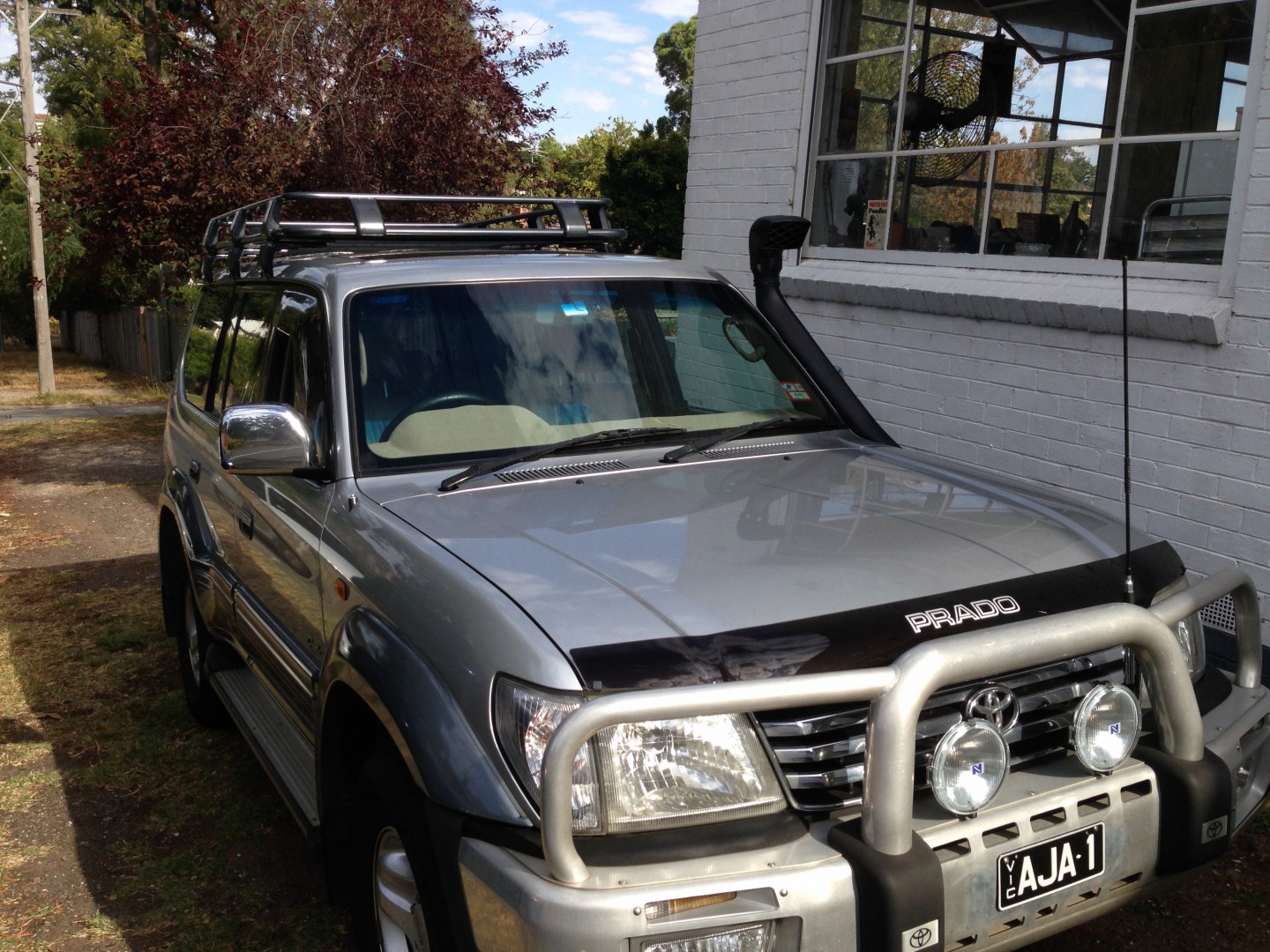

The only thing I would add if you haven't already got it is a transmission cooler,and a couple of cameras one on the van and one on the Prado,I have the two cameras best investment ever.

If you are talking about gauges then an AEM Transmission Temp Gauge could be useful. www.aemelectronics.com/ .

Get a Scangauge. It will allow you to check on your A/T temps. You can buy on the internet from USA or the importer in NSW. This is the link: scangauge.com.au/buy-direct/ or www.scangauge.com/

But check first on their website if the scangauge has all the important codes for your specific car. It can not read the AT-temps of all cars.
If it works on yours give me a yell. Have one here and sell it for cheap.

and yes all ready have the trans cooler and duel battery system
so will have a look into your suggested items

I have a temperature sender that measures the ENGINE BLOCK temperature and NOT COOLANT TEMP. Very usefull and totally independent of Toyota temp system.
I have it set so that after a long haul, if we stop and idle engine, the alarm sounds audible/and light, so I know it is working as soon as block temp get slightly hotter. You can set even higher but my system is a "self test" on the road in practice.
Only other thing you may need is g/box temp as others have said and voltmeter for "house" battery if you run a fridge etc.

Hi to all , Just wondering what if any guages we should install on our 3 ltr turbo diesel Prado
to keep a eye on things when we travel
many thanks Tony & Kerrie
