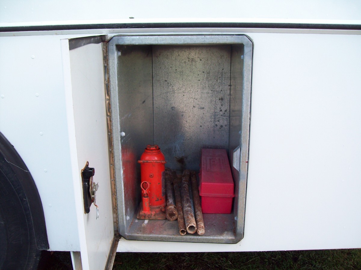

oldbobsbus said
07:08 PM Jun 17, 2014
I have a dedicated storage on the side of out MH for fuel and oil, Ohhhhhh and the jack and wheelbrace and any other thing I can fit in like the wheel chocks..

Glenelg said
07:32 PM Jun 17, 2014
oldbobsbus. thankyou thats what i was ona bout, i must av been posting when you replied, i thought there must be some thing that does the job , thankyou.

oldbobsbus said
08:15 PM Jun 17, 2014
put a vent in door it would be lawful we hope
There is NO seal on the bottom of the door so that makes it legal..
