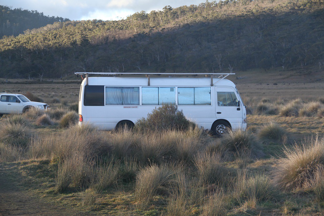

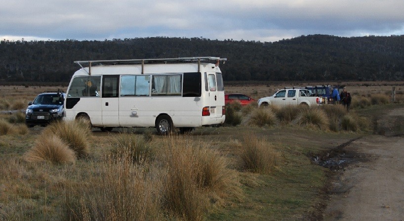

Ok here are a few external pic's..

Just looking at the photo.
That's a short wheelbase model.
What size motor is in it.
As I have the long wheelbase model with the 4.2 lt 6 cyl and only get about 5ks/l and 4ks/l towing my trailer.
Also who made the roofrack.
Cheers Barry.
